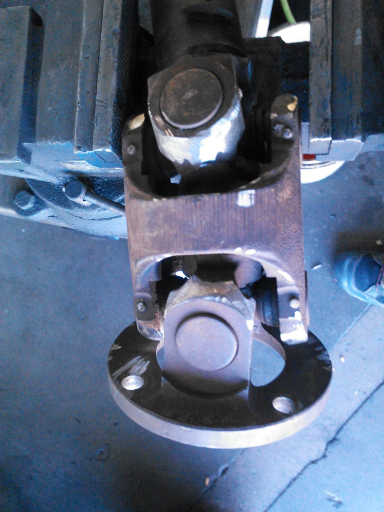

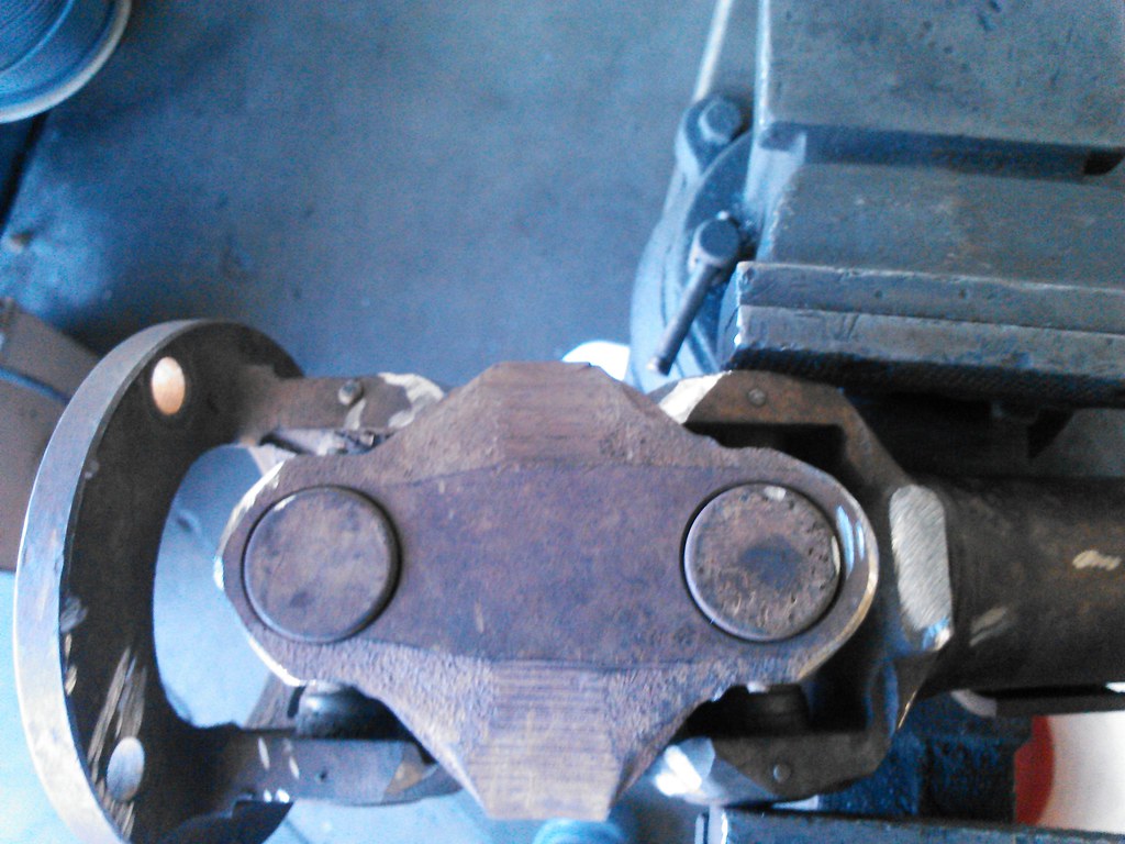

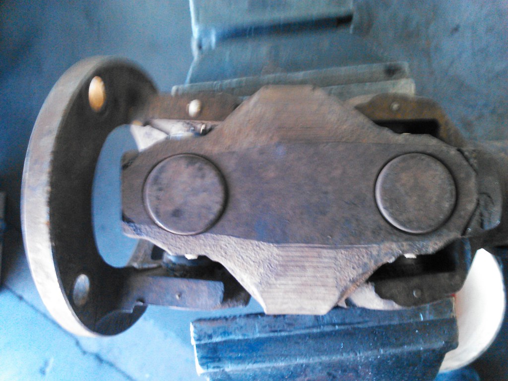

If your stock front shaft looks like mine below, you can clearance the CV with a little cutter/grinder work.
No more binding.

I've had that shaft in my truck since I did the trimming. 5 years and counting and a truckload of off road miles in Colorado, Utah, CA and a little in AZ and NV. Still going strong. The front shaft has never bound up during any suspension cycling.

The issue is the stock shaft at stock height is fine. But if the truck is lifted the full sharp corners and extra material will cause the shaft to bind and hit on itself as front axle droops. It's pretty easy to flex the cv around by hand if it's off the truck. You'll see what limited movement it has before it starts touching in multiple spots. Knock off the corners and come back with a flap disc and smooth it all out.
