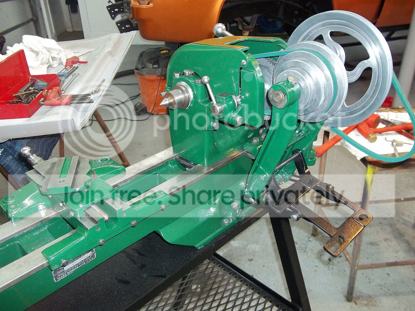

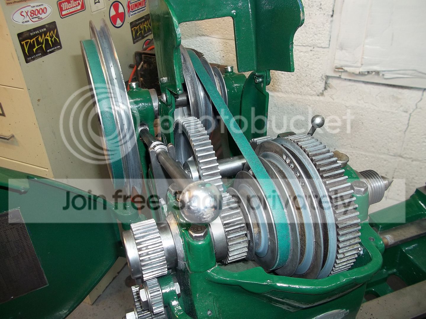

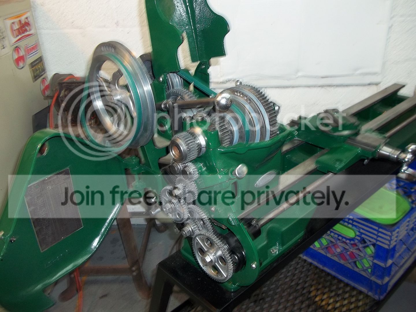

it's about 1/2 way back together.. got all the threading/back gears refurbed and reinstalled, but i need to get the belts before i put the headstock together.. it's kind of a nuisance to change belts, gotta pull the whole spindle/pulley assembly... so when they come in i can get all that back together...
need to modify the motor base plate a bit, as it's not really a motor for this... at some point i'll do a new motor with a reversing switch so i can cut thread...

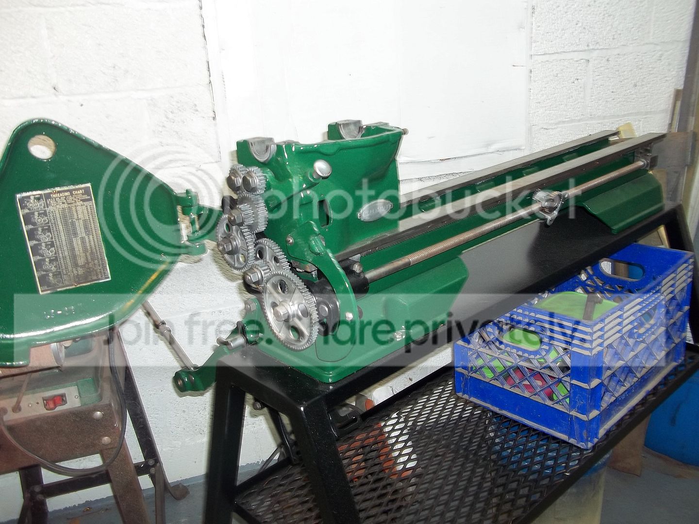

really what i'm farthest away from is getting the carriage/saddle reassembled and reinstalled... just finished cleaning all those parts today, and painting the pebble cast the green..

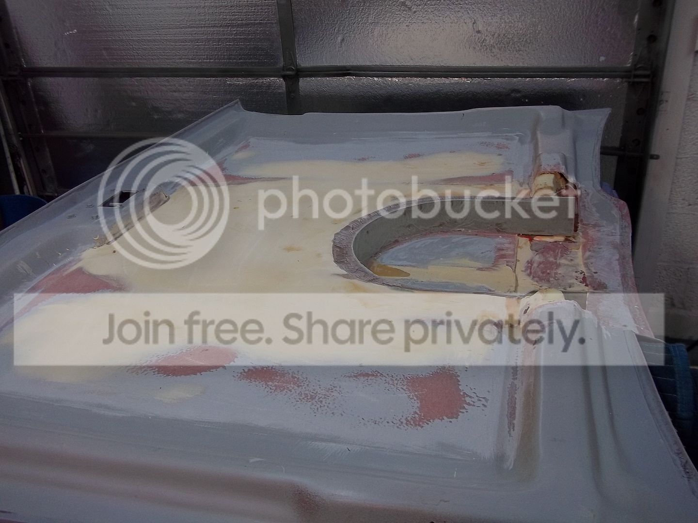

and here's the underside of the K5 hood.. tomorrow I'll order some glass so i can finish it up and get it in primer... the cowl "cavity" was filled with 2 part expanding closed cell foam, shaped, than glassed on top and faired... the "wall" is 1/8 composite, but I need to finish the areas at the back of the hood...

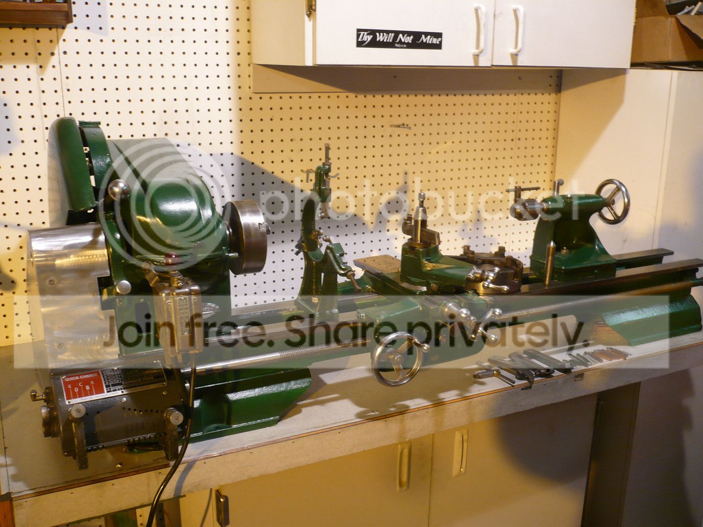

this was on eghey the other day for $1500... just about the same unit as mine, just a different quick change gear cover to the left and a bit longer bed...
but with all the bells and whistle, forward/reversing switch, steady rest with rollers, drill chuck on the tailstock, etc.... it's funny how it's almost, or the same color as mine is... :pimp:
so, in the end, I'm hoping mine looks about like this...

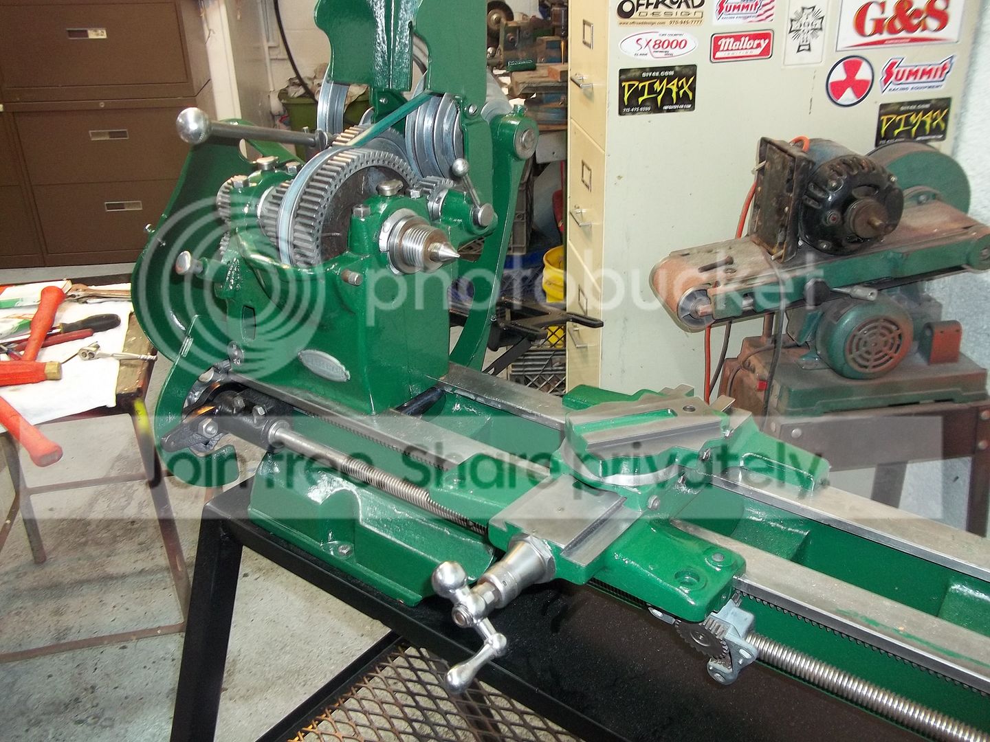

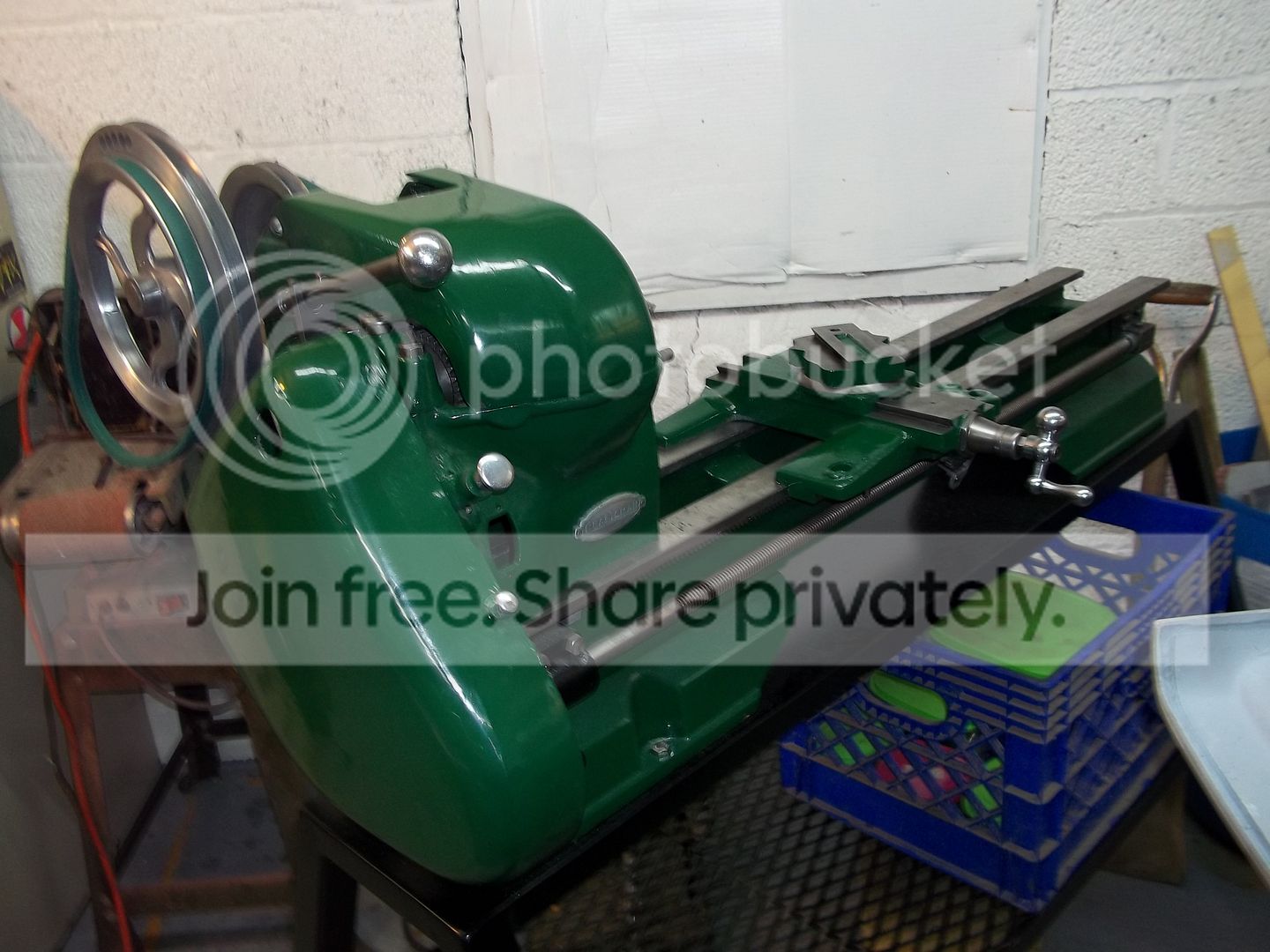

and me, looking much more like a lathe now.... just need to mod the motor base and mount it, get a chuck, and i could actually spin something! :haha: hopefully i can win a chuck auction by the end of the week..
the carriage and saddle still need some assembly, I'll get to that this weekend... the lathe gods where's smiling on me and the belt's ended up being green, they look good... :pimp:

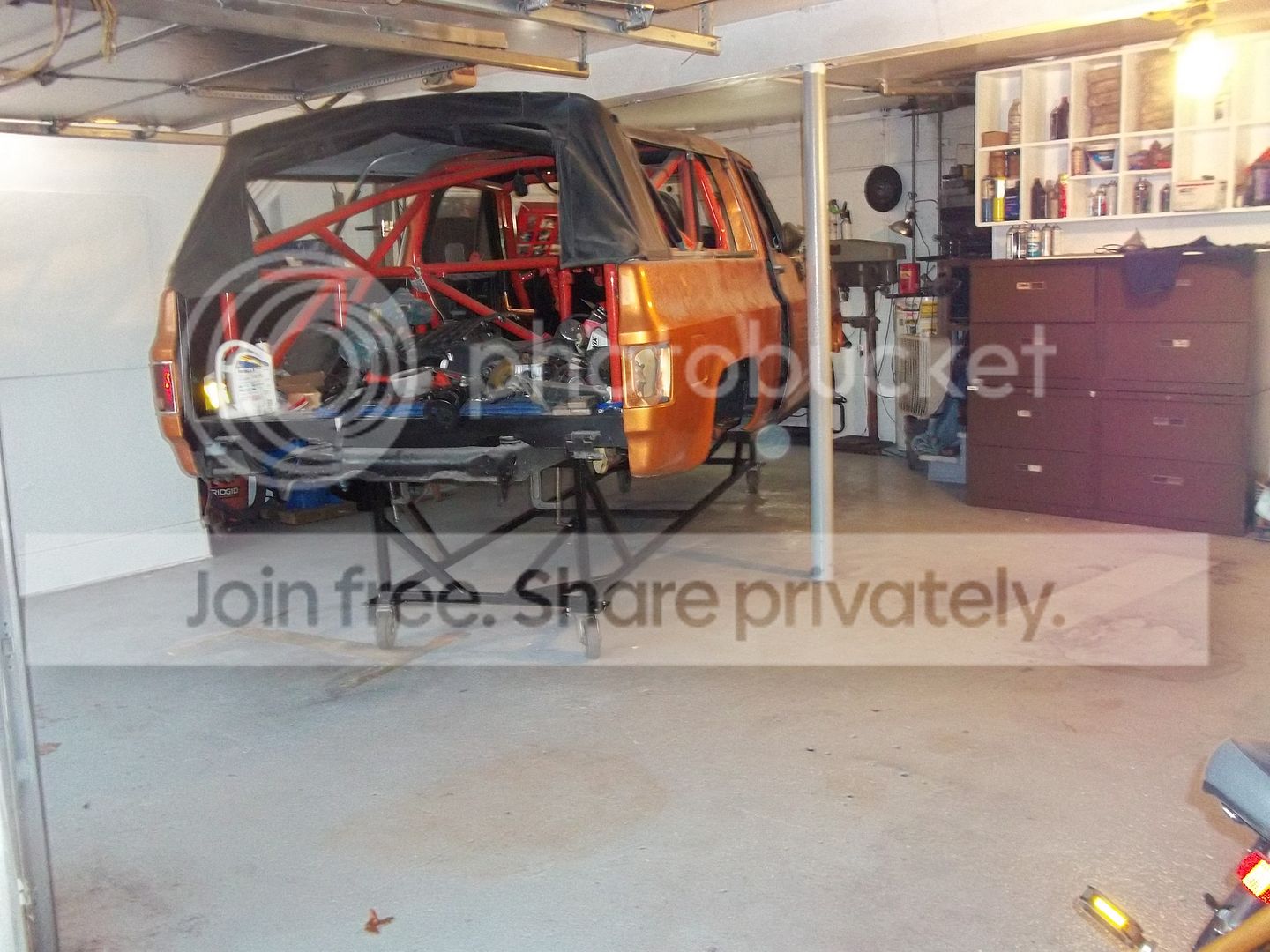

but shifting the trailerqueen back toward the camera, taking up the forward 1/2 of the LAB ;) by the doors, doesn't work right now......
I tried it and put it back.... :doah::o
it's doable,
but I really can't have ANYTHING in front of the middle pole along the sidewall to the right.. right now my 2, 1/2 barrel fiberglass and steel bins are there..
and i like/need them for now... :whistle: if I never replace the washer/dryer, I could move em there?!??! :dunno: eh, doing laundry at work is kinda ghey... :rolleyes:
