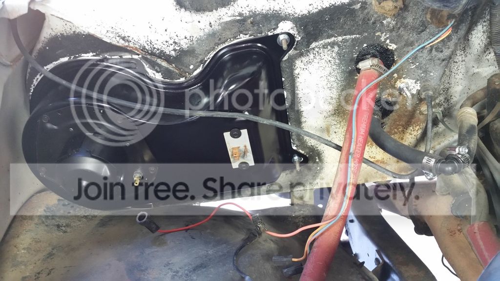

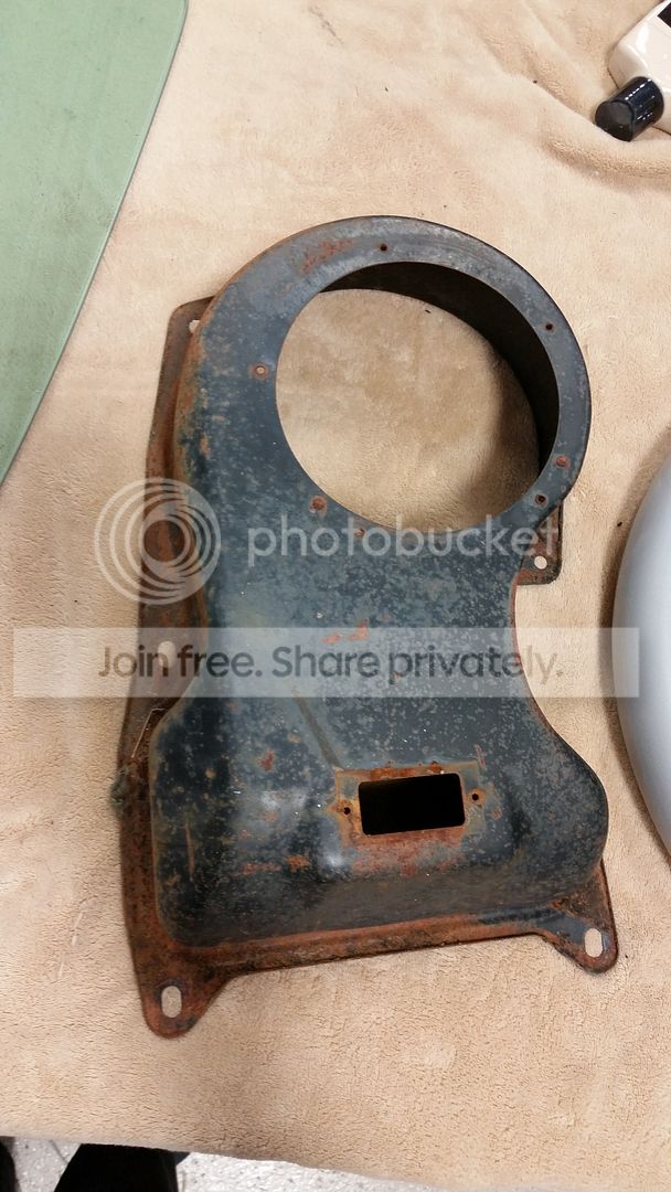

Got this heater box housing from Marty.
Sand blasted and painted it. Got a new blower motor and fan.
All 3 wires have power. Need to look up how it all wires up. Probably need a new resistor as well.

That's some pretty sweet heater hose action you got going on there!
It's kuztom.
Someone in the past rigged up an aftermarket A/C and put a valve there to block the coolant. I need the hose that connects to the intake to fix it. I didn't wanna spend the money.
Does it use that stupid fitting with the plastic keeper that always leaks? If so a hose barb is a much better solution and cheaper as well.

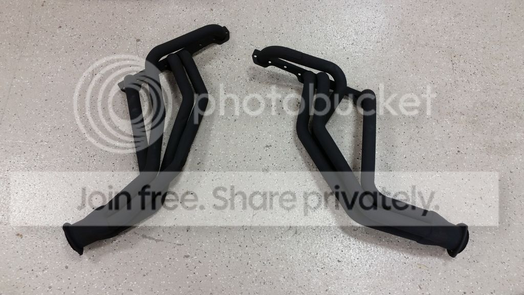

Got some free Headman headers from Chinahands crewcab that were going to end up getting scrapped.
Replaced resistor, now I have a blower motor, heat, and it doesn't smell like mouse piss.
