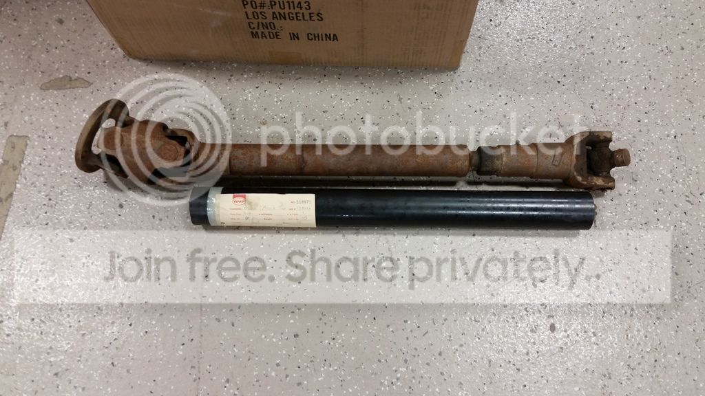

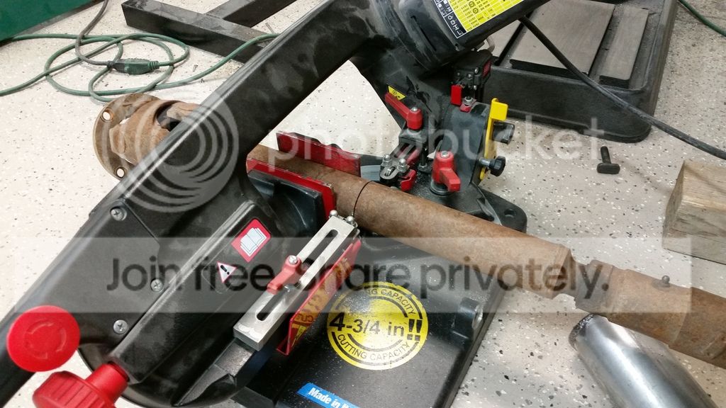

Got some tubing that fit around my stock shaft.
Cut the driveshaft in half.

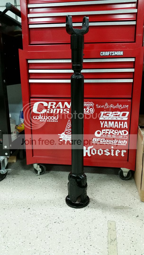

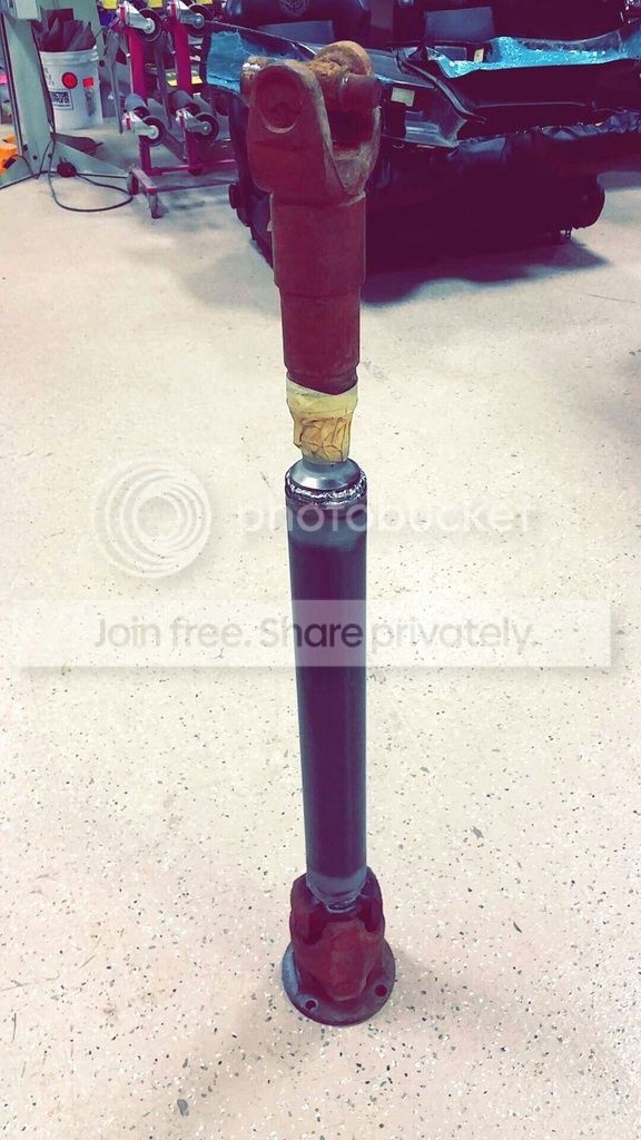

Attached both ends to the truck with the slip yoke in mid range and cut the new tube to length and welded it.
Painted it, of course.
Just need a new u joint and test it out.

Are you going to try to balance it? Or do you simply not care about the balance on the front shaft?
(I guess I'm just assuming that's your new front shaft.)
I figured out where I was going to use this stolen info. I will need to do the same thing when I clock my t-case. Thanks for info on this one, you have eased my worries.
Sweet, I just didn't see you having a black shaft.. I suppose the carpet does not always match the drapes..

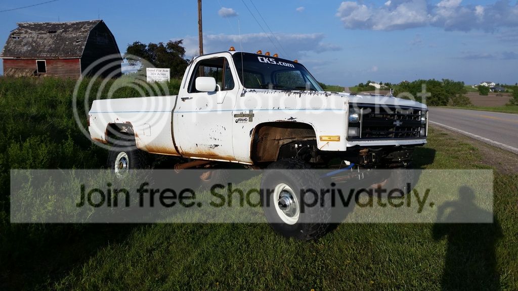

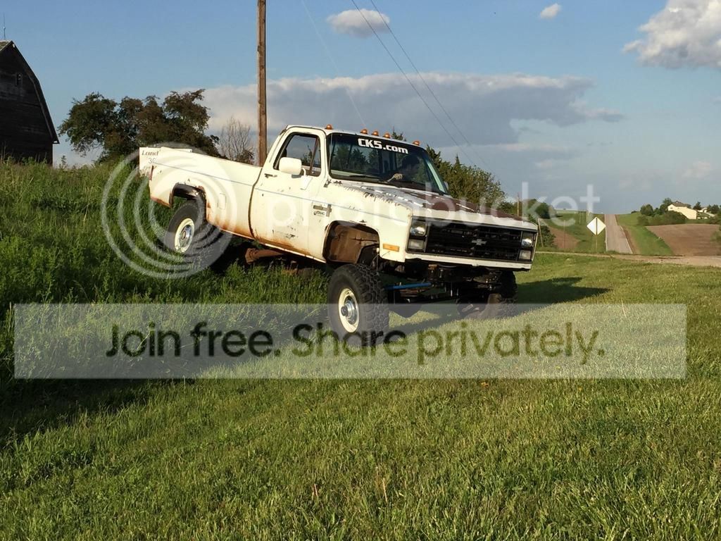

Nice flex btw looks like the front works well.. How's that on the street?

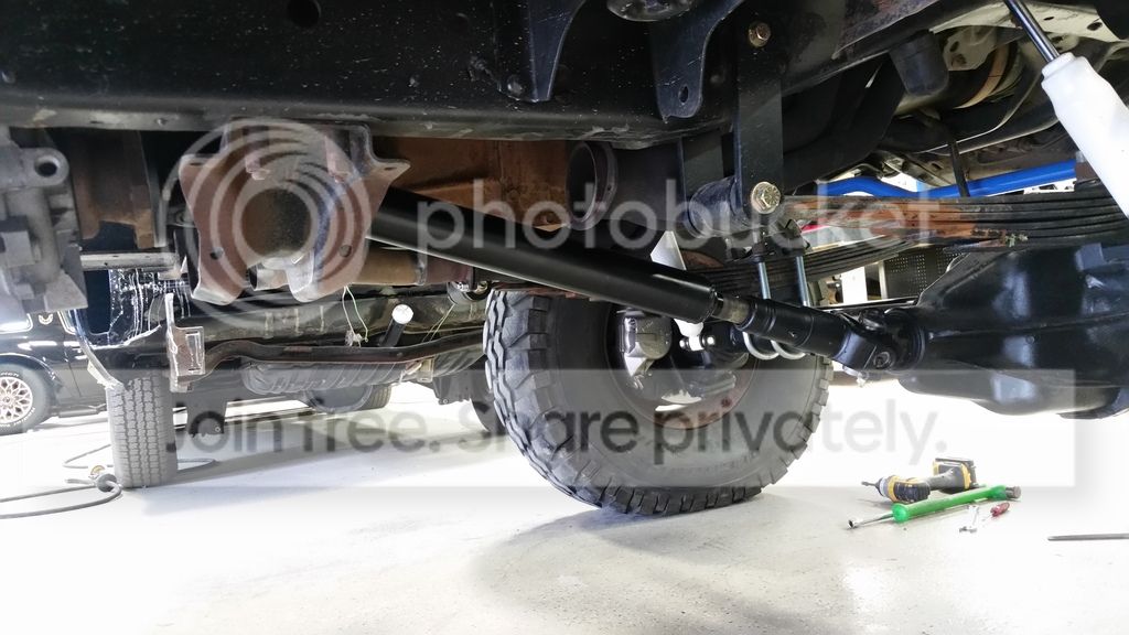

It flexes a ton, no where near maxed out in the pics. Drives fine on the street. Body roll is a little more noticeable than your standard lift.
No. By time I take the time to make it fit, I will be able to just make my own.
