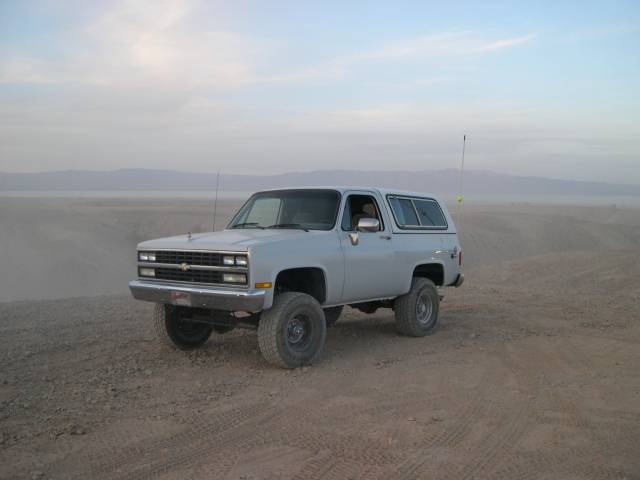

I've been thinking about documenting my build thread for some time, but I'm finally getting around to it. Here goes.... This is where it all began.
Here are some pictures of what my K5 looked at when I bought it. Pretty much stock at this point, but did have a 4 inch lift, Auburn 4:56 LS diffs and the interior had been LineX'd
