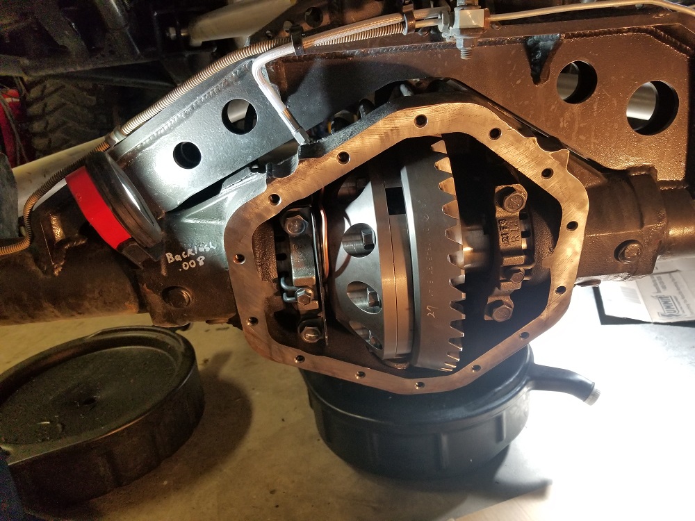

New locker going in.
There was more stoning on the carrier than I remember on the other one. The seal cap 100% was a rougher than the old one. I had to do alot of stoning and cleaning up on that part.
It setup good. Took some more adjustment on the bearing adjusters than the old carrier, but only by a tiny bit. New bearings too, so it definitely could be from that.
The copper line seems way harder to work than the old one. This is interesting. I suppose this is why the new bulkhead is way different with two o-rings and a spacer. OD on the lines are the same.
I've got it holding air for a little bit until I call it good.

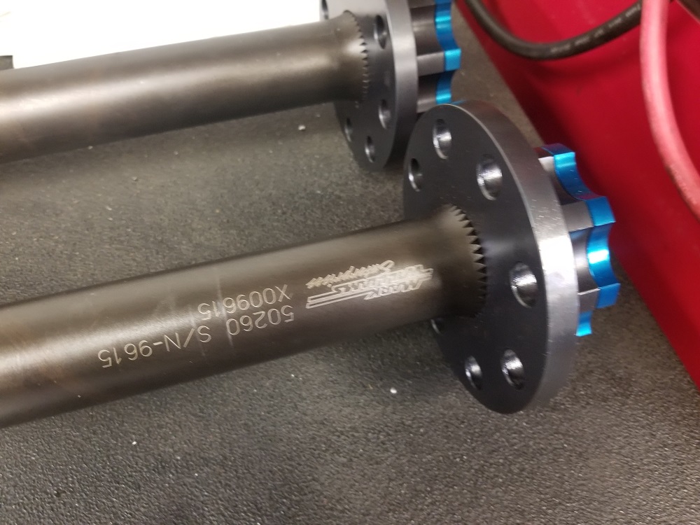

Finally time to button the rear axle up. FWIW axles go into the new carrier like butter. Outer splines are 40, inners are standard 14b 30. I had the option for 35 and 40 spline carrier splines for the exact same money on the carrier and shafts.. 30spline on a 14b is huge anyways and it gives me the option of semi-readily available shafts. Atleast more-so than 35 and 40 spline. So that was my choice.

If I understand correctly from the pictures, the actual shaft is a separate piece from the flange. It's an interesting idea, but what's the advantage?
