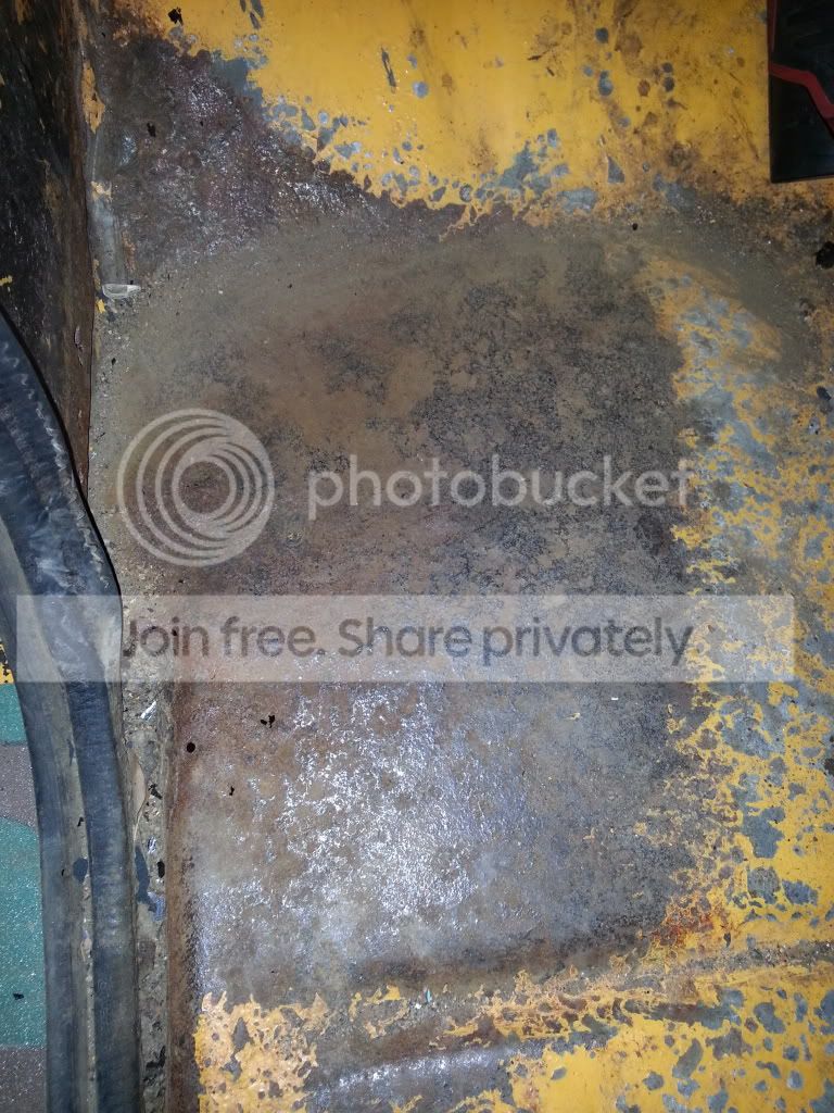

When I bought the truck the vent window on the driver side door was missing. I must have been gone a little while because the floor has some rust:
It's mostly in tact, but thin in some areas with a few pin holes. I'm curious what others think would be appropriate to do.
I'm mostly thinking about just painting with some rust encapsulating paint and calling it good.
Thoughts?
