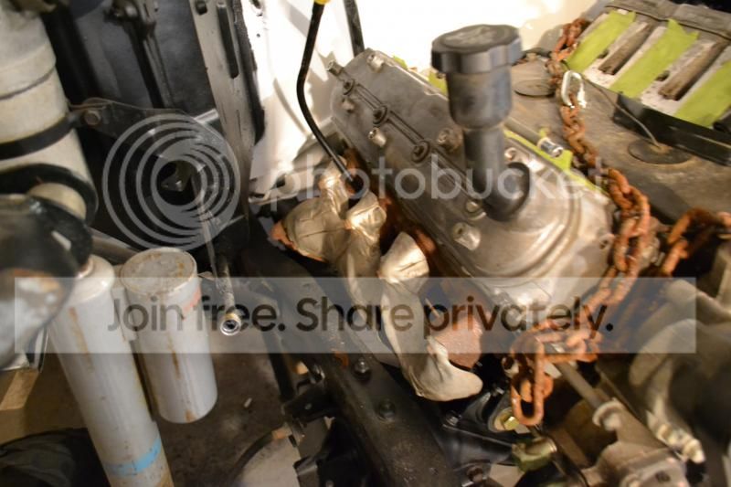

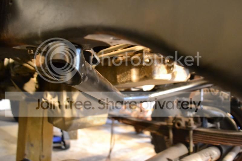

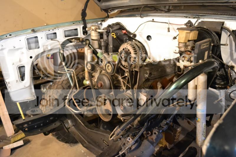

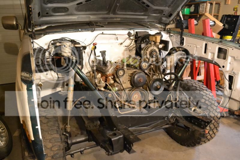

OK finished up a couple of tie in brackets associated with the engine cross member, leaving me no viable excuses for not installing the engine. So I did. It went in smooth even doing it by myself.
This pic shows oil pan clearance to the cross member. Right at 1/2" under the pan.
Not sure why, but the exhaust manifolds bolted right up and clear everything. I'm not complaining, saves buying headers. :waytogo:

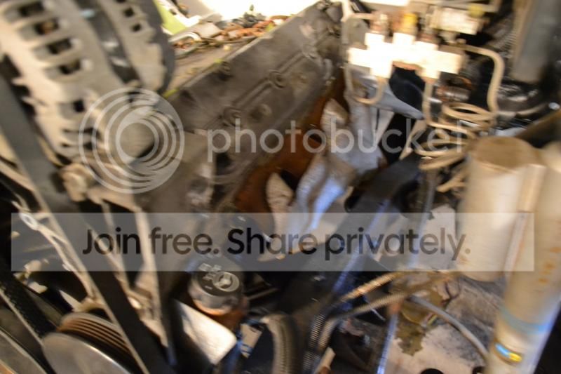

Passenger side:
Driver's side (sorry it's a little blurry)

Seems like others have had trouble with exhaust/frame interference, guess you got it right!
On mine, the manifolds fit fine, but the driver side down pipe needed a wedge cut out of it to angle it back towards the motor.
