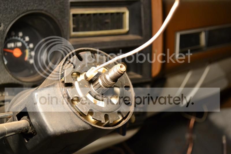

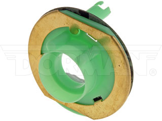

I used my lock plate depressor, removed the lock ring to get at the horn assembly to see what I could see. A pic of this part is in Dremu's reply a few up from this one. There is a plastic part and a brass part that is crimped to it. The brass under-ring keeps constant contact with a spring loaded ground that is underneath it.
The plastic dealie has a spring loaded aluminum pin in a small barrel that contacts the brass part. I removed this entirely, separated the brass from the plastic and soldered a wire to the small tab the spring loaded part normally touched. Then put the wire through the plastic barrel, re-installed the lock plate and installed the wheel.

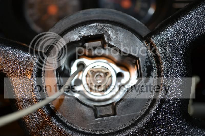

You can see the plastic barrel the wire has to pass through. Once the wheel was on I trimmed the wire and crimped on a spade connector.
This is where the wire passes through to the horn button.
Victory. :waytogo:

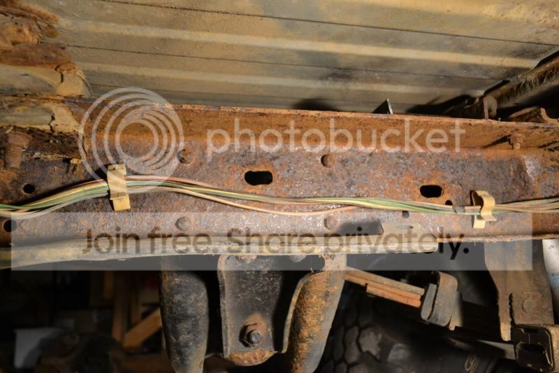

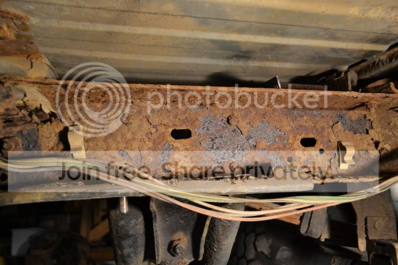

My gas tank is out and I have the DIY shackle flip sitting here. I also have stainless fuel and brake lines on the way. Time to clean the frame of rust scale and get it painted in something durable.
Before:

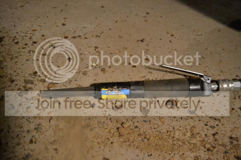

Time to break out my air powered needle scaler. Looks like this:
5 minutes with the scaler and it looks like this now.
I haven't found a better/faster tool for removing rust scale, especially in small tight spaces like this.

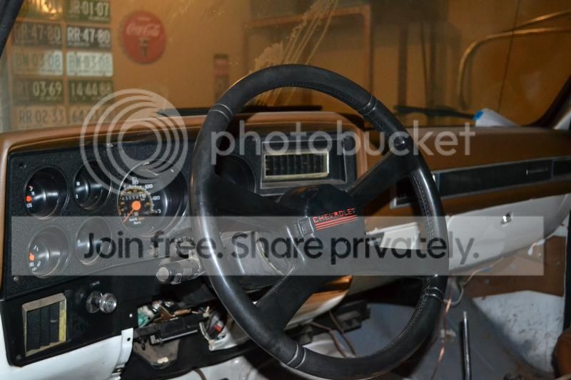

Wheel looks good.
I guess I`m going to Princess Auto...that looks like it worked awesome on the rust! :thumb:

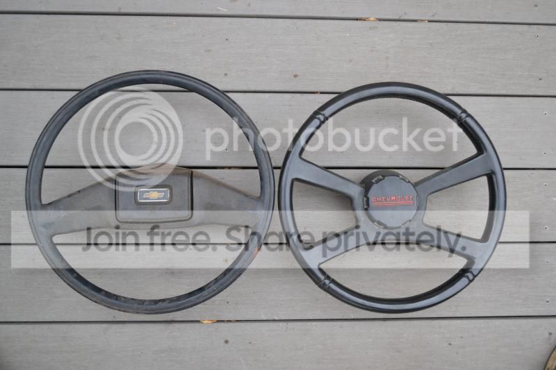

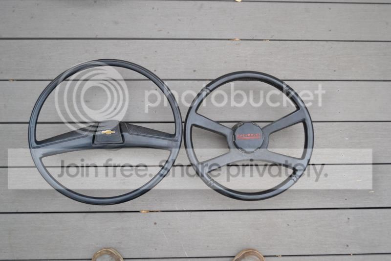

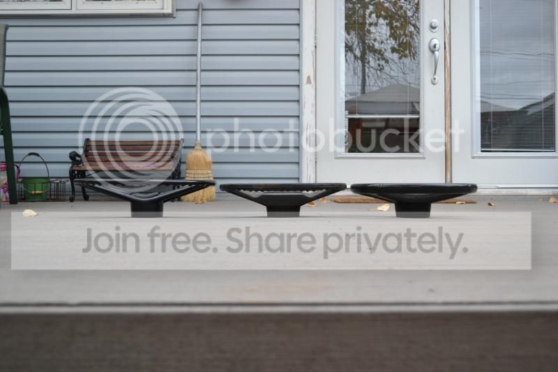

Some pics for Dave.
Shows the diameter difference.
This is the '72 wheel next to the 90's wheel.
Left to right, 72 wheel, 80's wheel, 90's wheel. No difference between the 80's wheel and the 90's wheel.
The other difference between the earlier wheels and the 90's wheel is the horn set-up. I have a second non tilt column here I'm gonna dig into deeper. The 90's wheel needs a ground wire with a spade connector coming up to the horn button.
