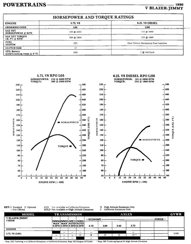

This is from the 1990 Blazer Vehicle Information Kit.

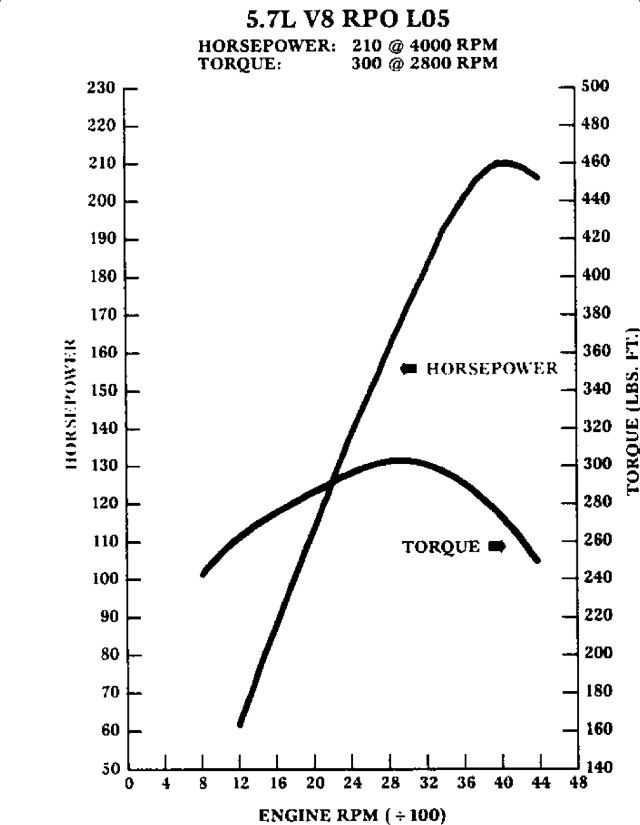

Close up of the dyno chart.

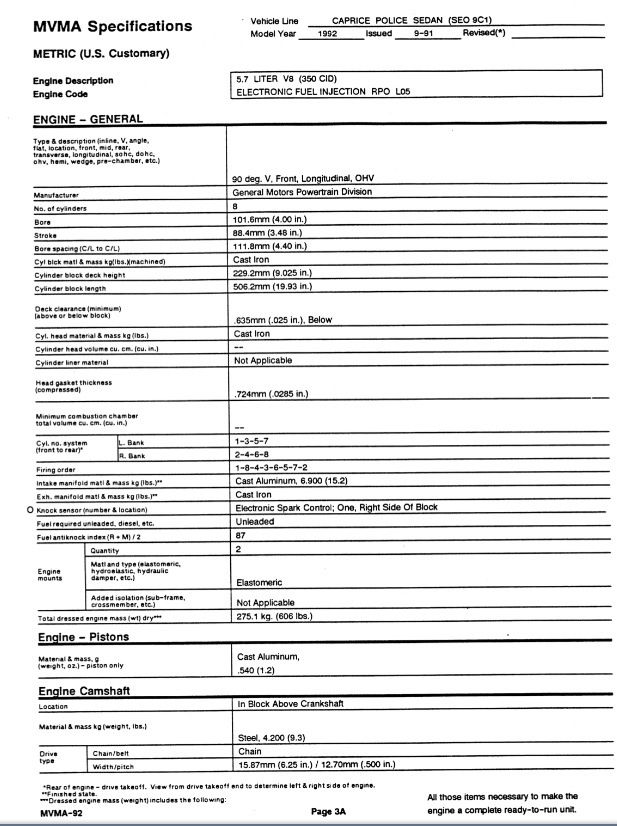

This is from the 1992 Caprice Vehicle Information Kit.

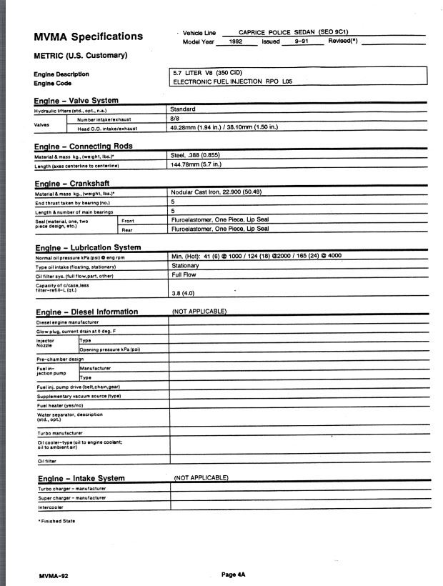

Still Caprice.

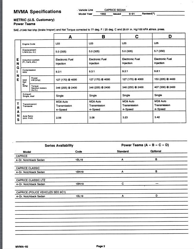

Still Caprice.
