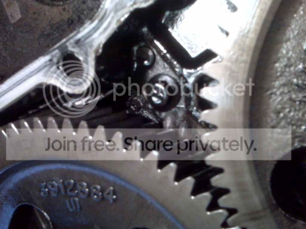

Well it was definitely one of those projects. Took longer than I expected but at the end of the day the KDP is tabbed, the front of the engine is cleaned up and everything is torqed to spec with loc-tite so it's good peace of mind.
Good thing I did it too, with 185,000 on the clock it had started to back out.

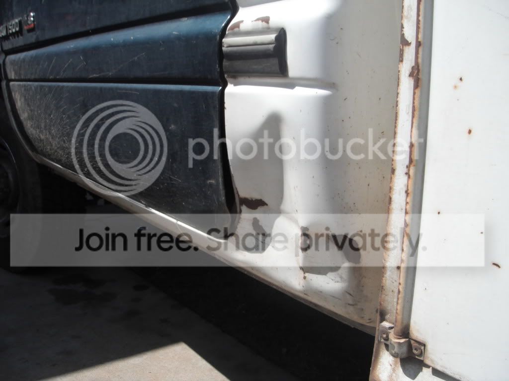

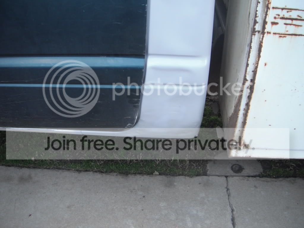

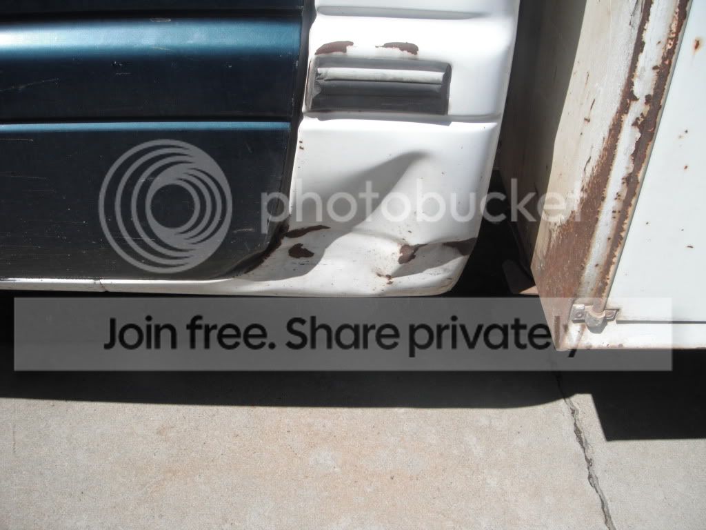

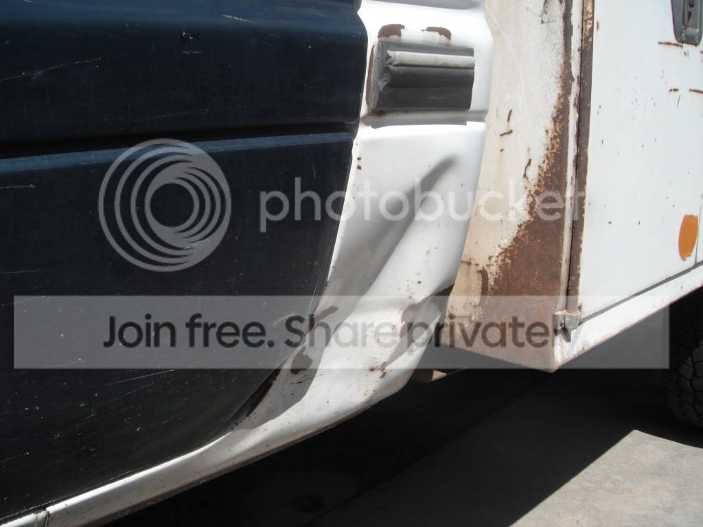

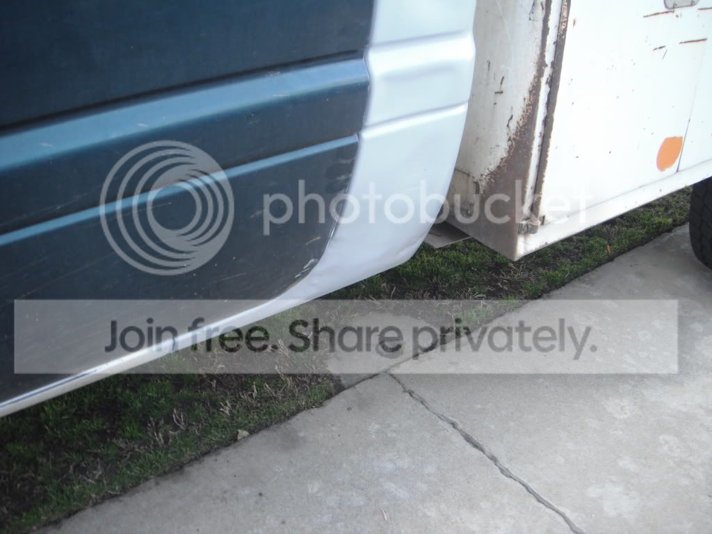

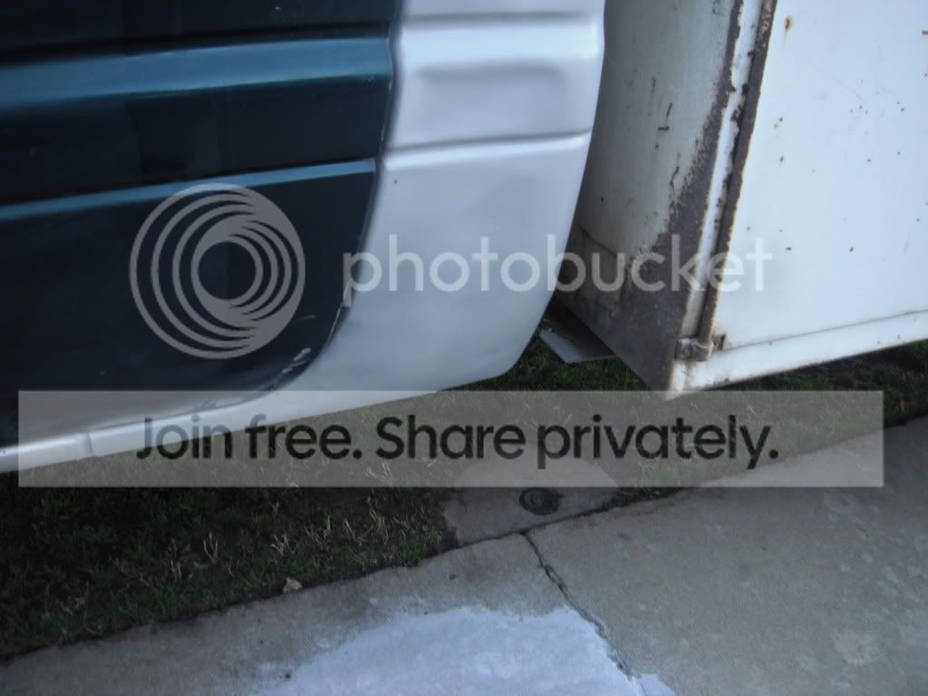

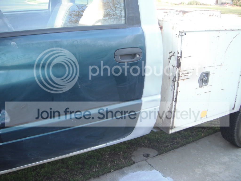

Ok here's my sorry attempt at body work. It's not great but I think it's way better than before. A whole lotta slide hammering and a little bit of bondo and here's what I came up with...
At least you're in cali so you dont have to worry about it falling out next spring like any CC replacent that sees any winter driving here in Mn.
