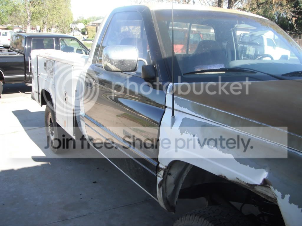

for that panel you can buy a cheap slide hammer and a stud welder or borrow one, another option is just to get a cheap patch panel or junkyard one and scab it if your just going for looks.
Does look better already though:thumb:
ah.. and you bastard!
These trucks aren't in junkyards or auto dismantling shops around here. I have no clue why but I've been looking for a door/fender for weeks without much luck so I think finding a cab I could cut a piece out of isn't going to happen. I'll just have to stick to yanking on the ol' slide hammer. :)

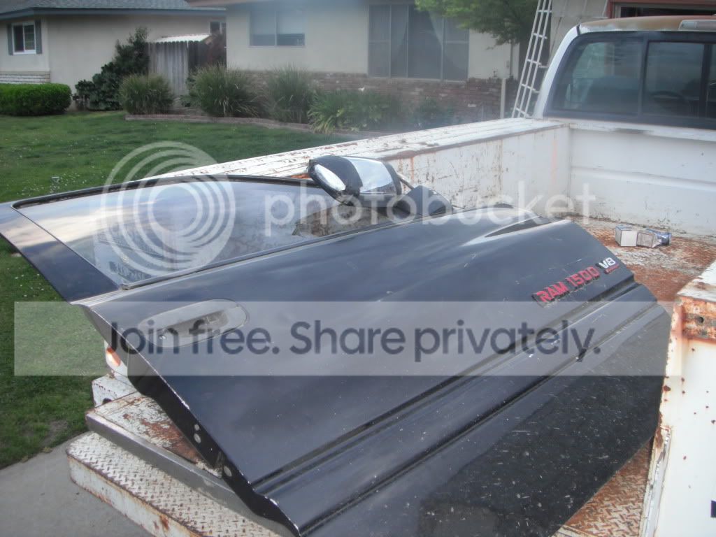

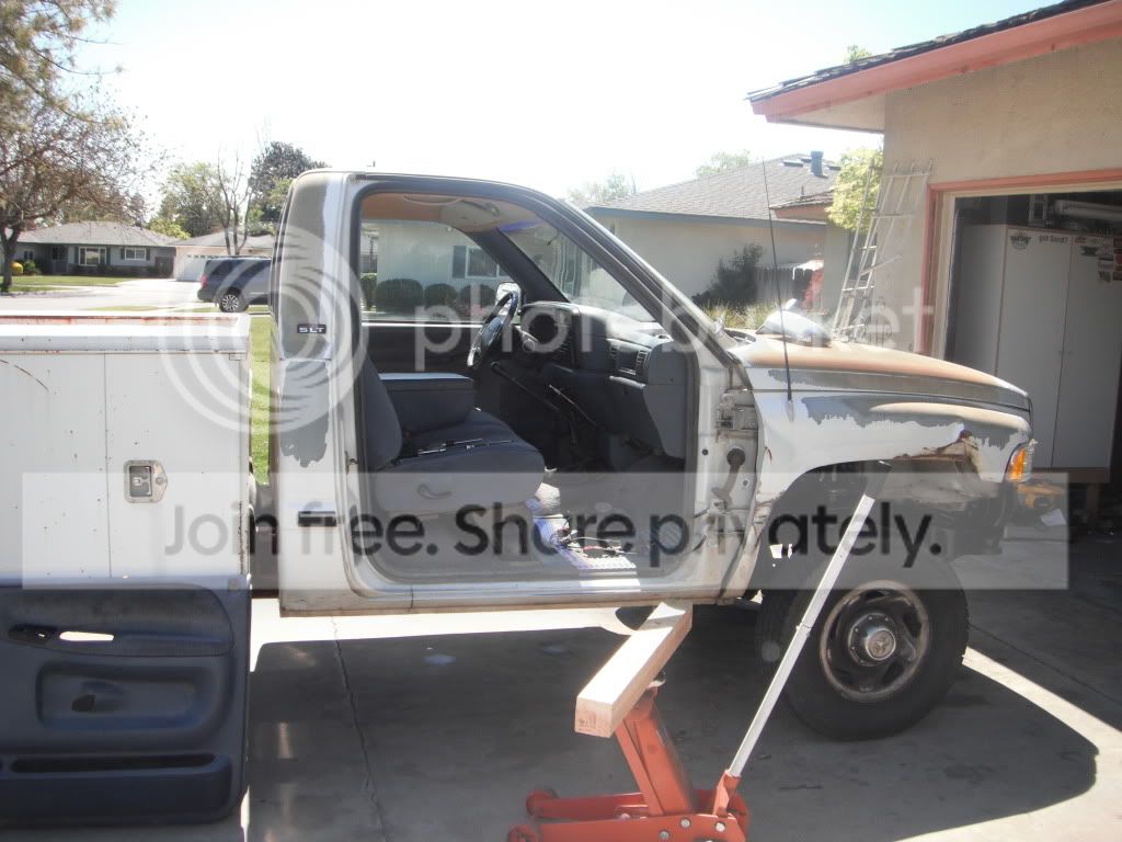

Started the day by driving out to a neighboring farm community about 1/2 an hour away and picked up a really clean power door to replace my passenger side that's munched up. Got it for $60 which even factoring the drive in was better than what guys around here were wanting and half the time they weren't even all that clean.
So this'll go on tomorrow. I'll swap my mirror, interior panel and lock cylinder on then bolt it up.

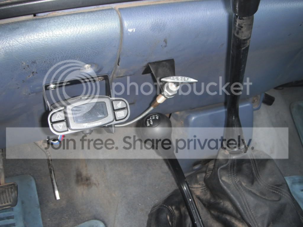

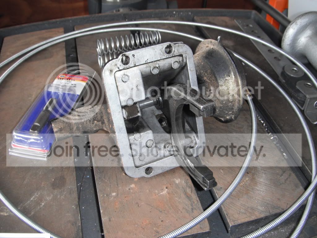

Then this afternoon I whipped up a way to get 4wd going. Like many dodges of this era the vacuum actuator was giving me trouble but the transfer case shifted great through everything so I said forget it and made up a cable operated setup to move the shift fork and engage the two passenger side axle shafts manually. Eventually I'd like to convert the outers and run hubs and at that point I'll lock the central axle disconnect in fully but for now this was cheap and works pretty well.

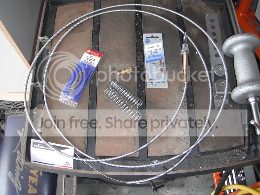

Here's the parts I used. A locking manual choke cable, a couple springs, an 1/8" NPT to 1/4" compression coupler, and some cable locks.

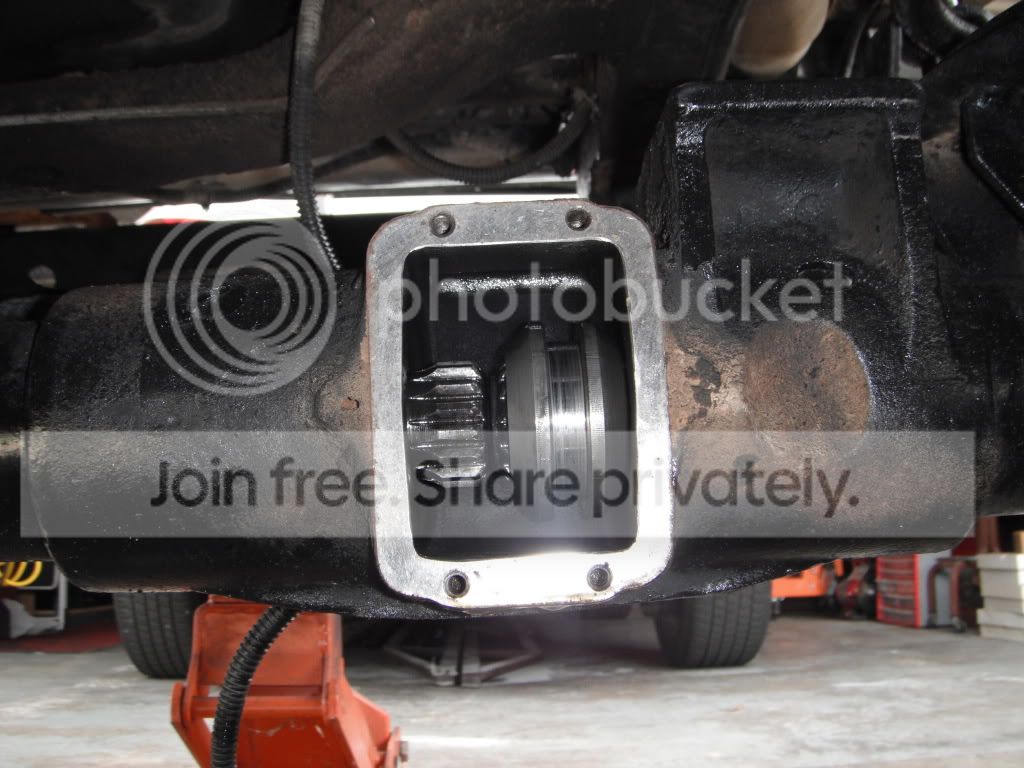

Here's the CAD off the front axle before I started working on it.

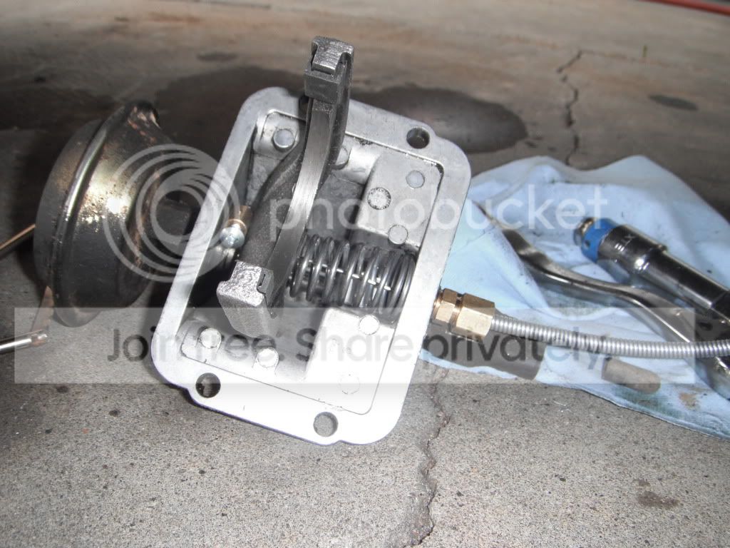

Here's what it looks like inside the tube. That collar slides and locks the two shafts together...

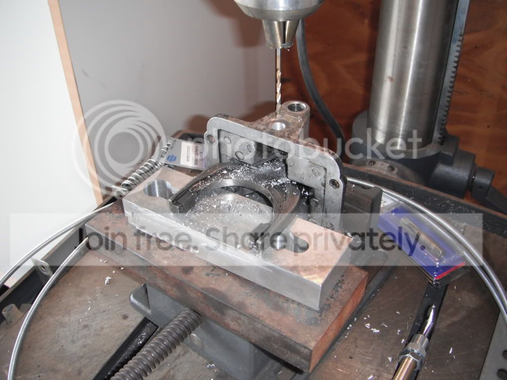

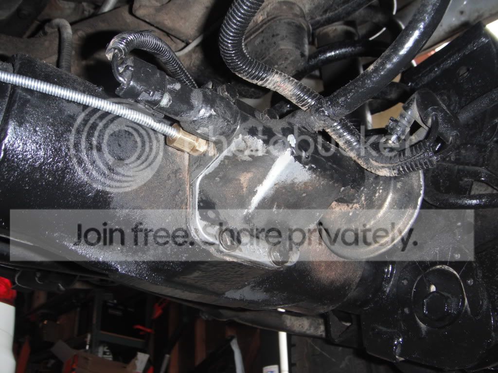

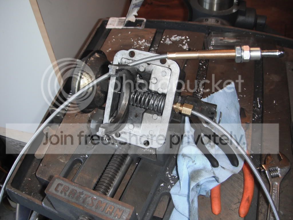

I drilled and tapped a hole to 1/8" NPT in the side of the cover to fit the one side of that compression sleeve. The housing is cast so it was plenty thick enough to get a good thread engagement.

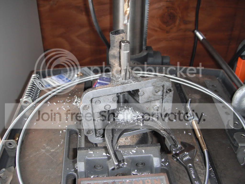

Then I drilled a hole through the shift fork to fit the cable.
Here it is mocked up...
I mounted the cable like this for now.
Once the cable was run through the firewall I was able to put it back together. I bent the end of the cable once it was through the shift fork and put a cable lock on the end of it. I had to play with this for a while to get the right spring tension/length.
Here it is all bolted up.

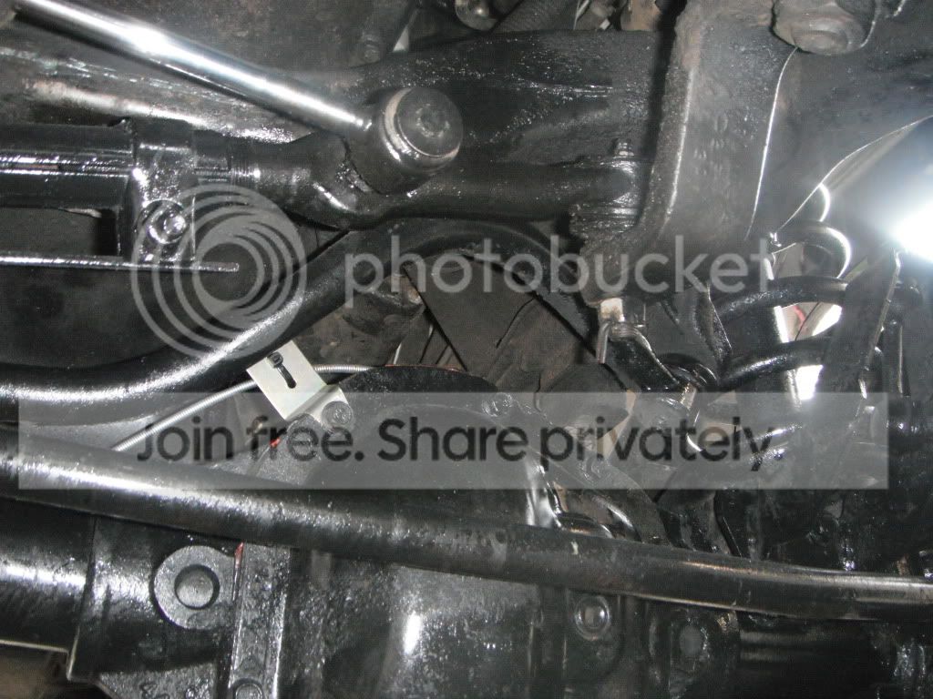

I made a bracket that I ran one of the diff cover bolts though and zip tied the cable to it so it's out of harms way (it's also zip tied to the axle tube right at the CAD.
It works pretty dang well for being so cheap. I need to be rolling a bit but that's normal even for the stock setup.

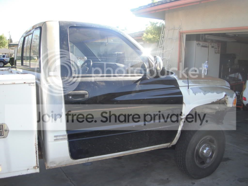

Oh, forgot to post I got the new door on. This truck is all kinds of colors now. :)
I had to pull the wiring harness out of the new door and suck my wiring harness back out of my old door then run it through the new door once it was mounted for the lock/window/speaker/mirror because the new door uses a plug at the cab and the '94's didn't.
I fought with the handle for a while but got it figured out. I ended up swapping my lock cylinder into the new handle so that my key works for both doors.
Now I just need a fender and I can start prepping for paint.
