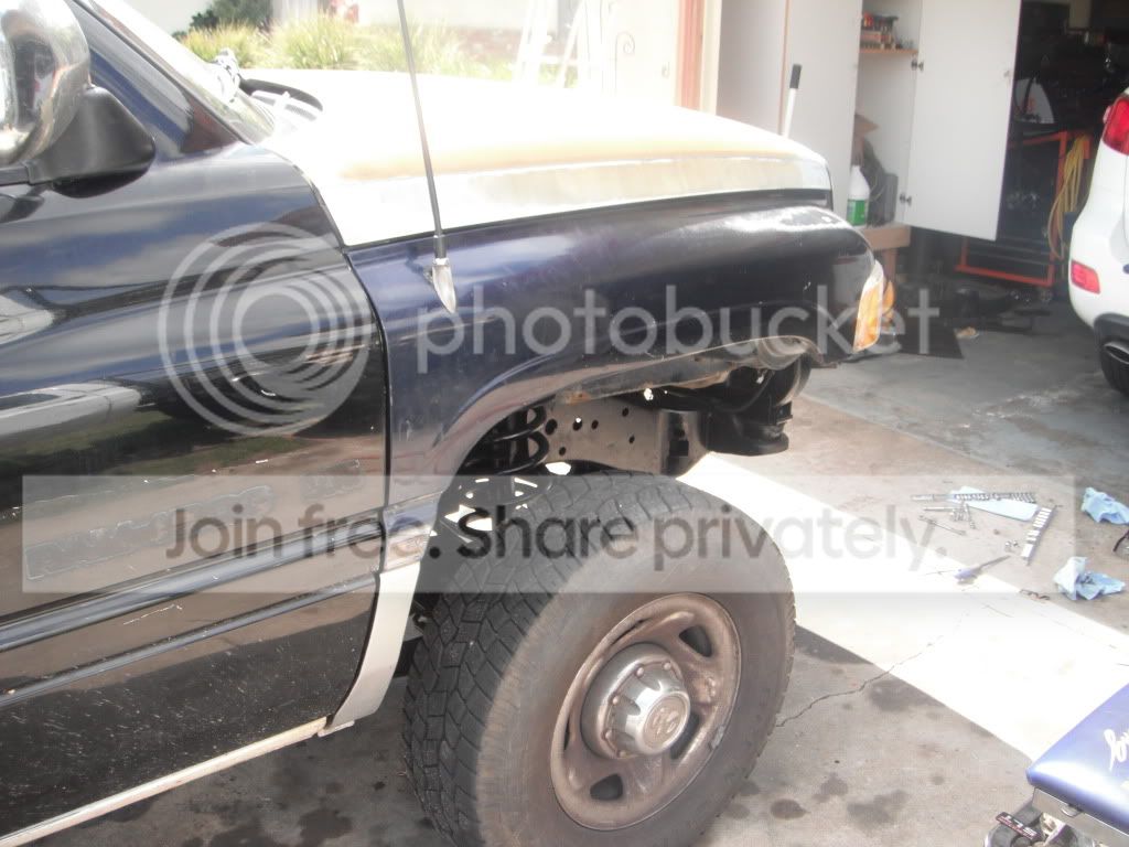

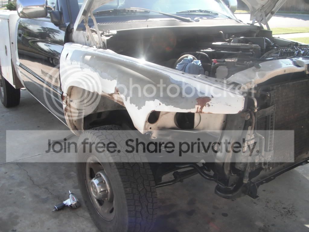

My friend found me a fender for the passenger side. Picked it up for $50 and got it mounted this morning...
Hey that looks good, were you able to use the antenna?
Nah I just swapped my antenna onto the new fender. You can't really cut those cables and my antenna was the same exact one as on the new fender so it worked out.

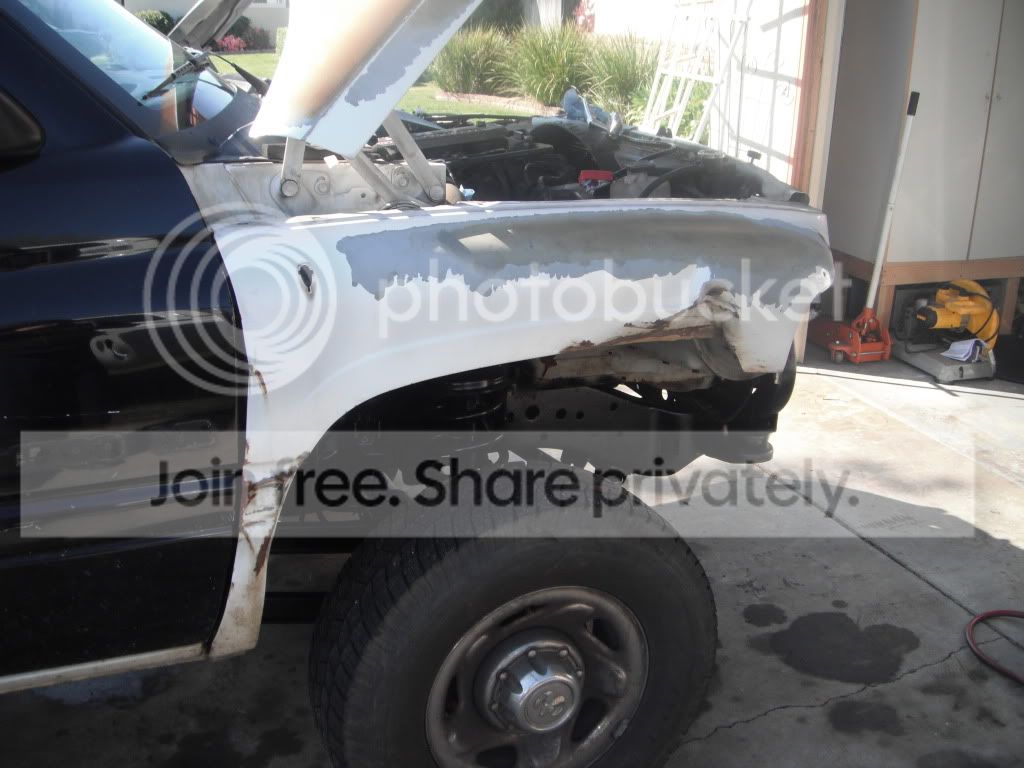

I need to pop one more dent out of the driver's side fender and then it is what it is. I don't have the money or skills to get it any straighter but I want to get it all one color.

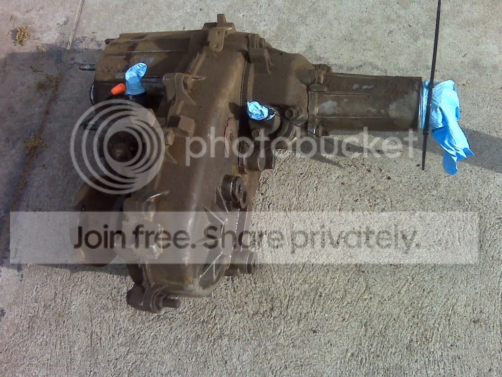

Oh and the freaking transfercase is giving me issues now. I found a tiny crack in the bottom of it yesterday so I drained it, cleaned it up and JB Welded the crack and surprisingly it held quite well. Well today I get home and notice it's dripping again so I check it out and it's leaking from where the tail of the TC bolts to the housing. I'm thinking I'll just drop it in the next couple weeks and go through it. Open it up and check for internal damage then clean it all up, re-seal it and bolt it back up. I don't mind a little drip here and there but I can't handle puddles.

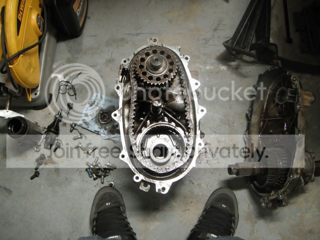

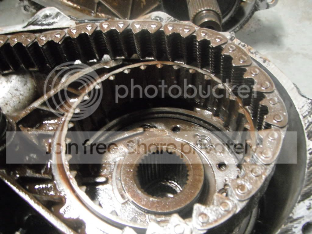

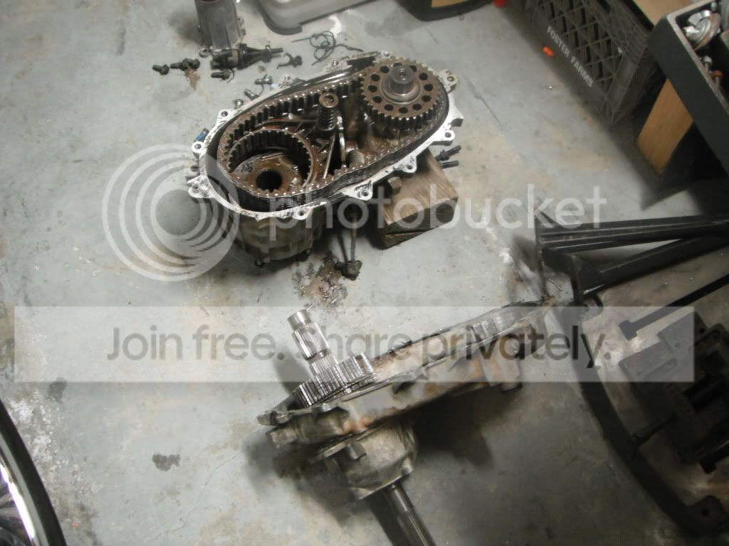

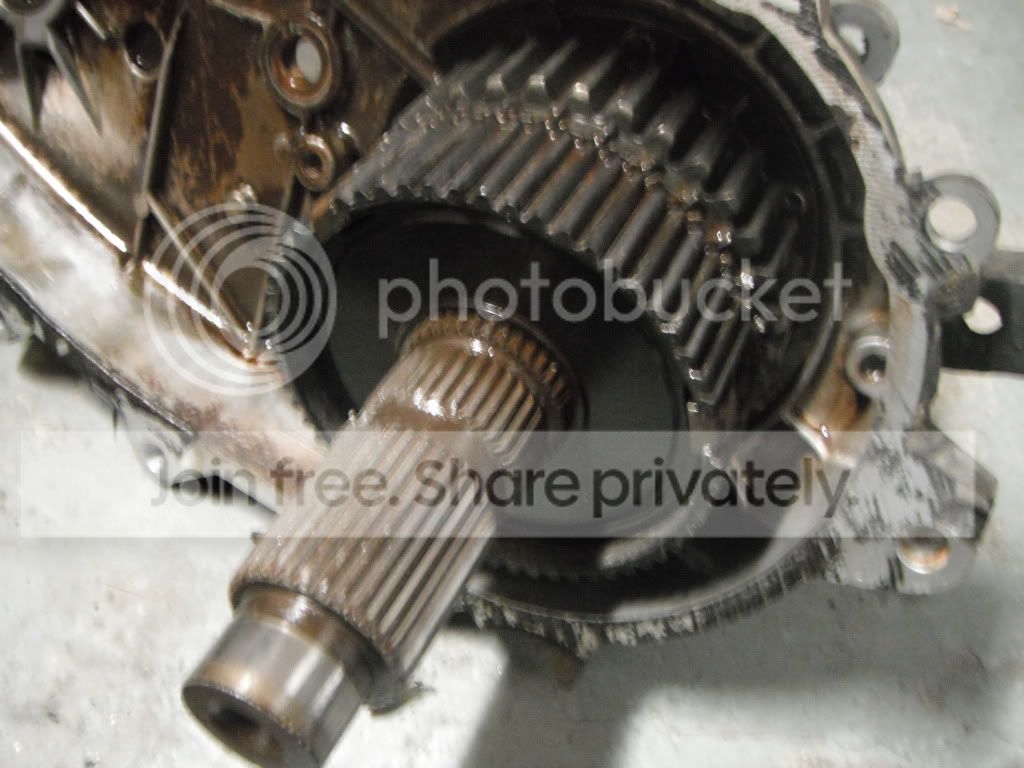

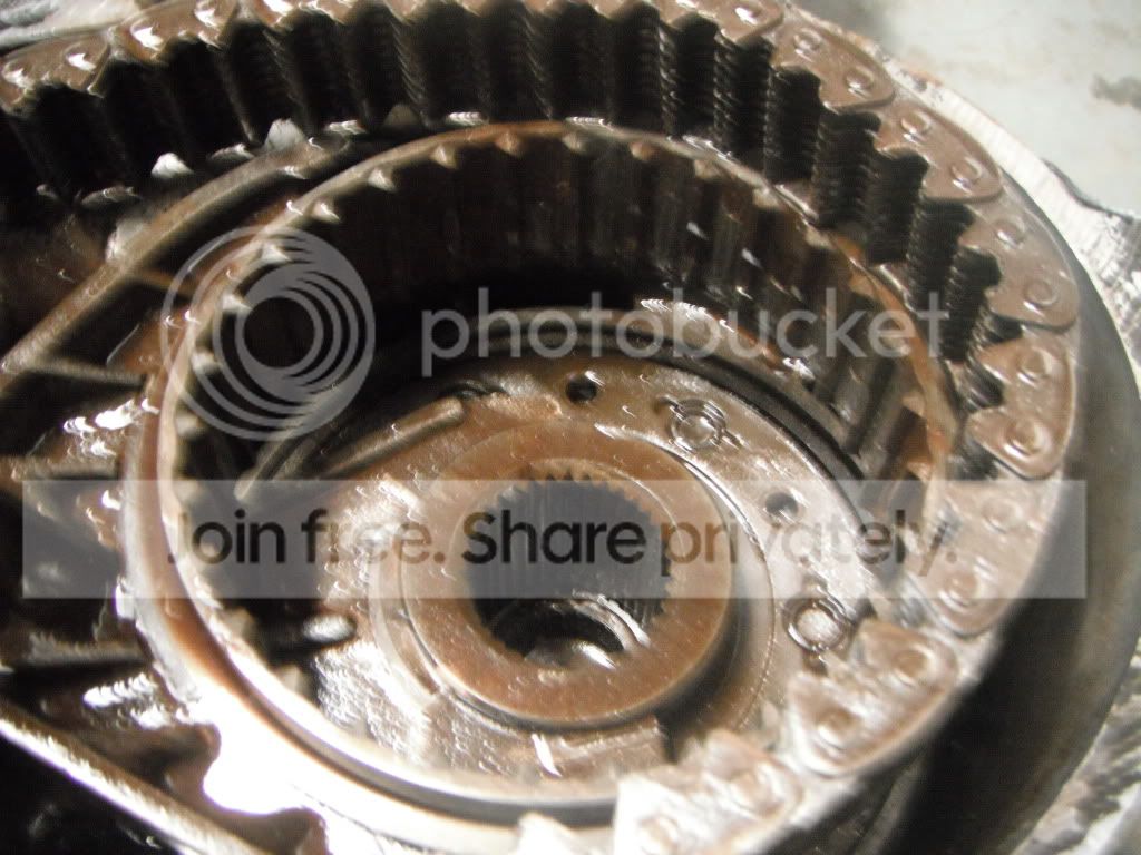

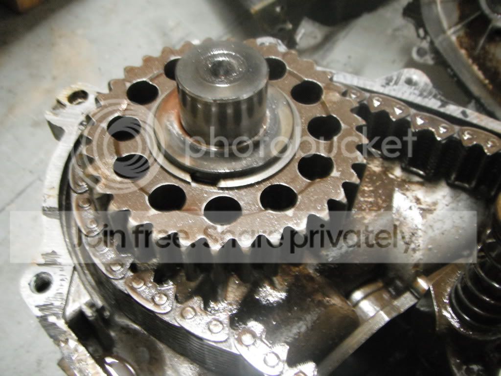

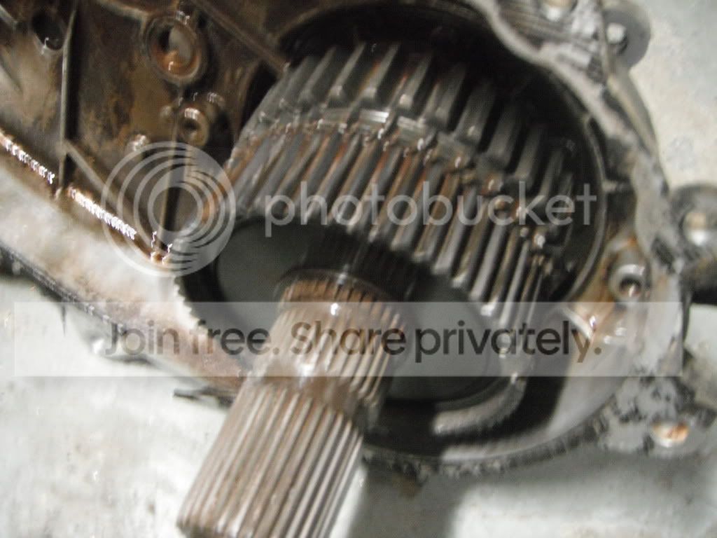

Dropped the case today to finally get to the bottom of my major leak. Looks like there was no RTV between the halves, it all squished out when whoever last bolted it together. I need to replace one part for sure, maybe more. I have a friend that is going to come over and take a look and we'll go from there.
Here's some blurry pics :)

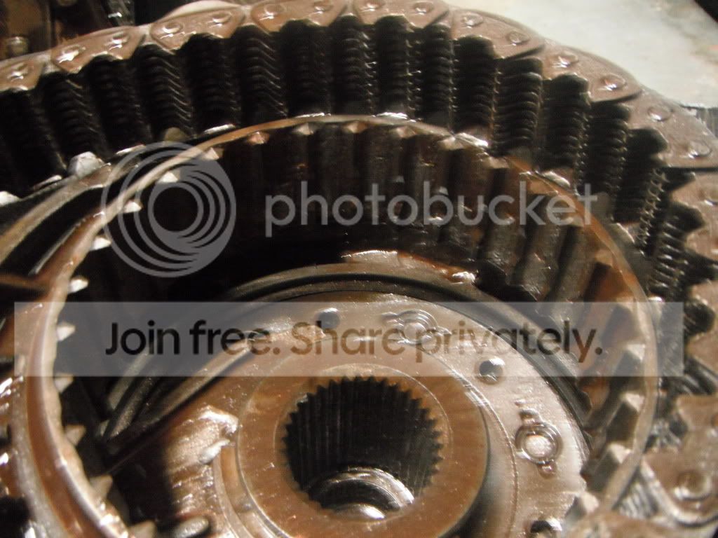

Time to update this thread. I finished rebuilding the 241 and got it back in with a new chain and I picked up one of those rear snap ring fix-it kits while I was in there.

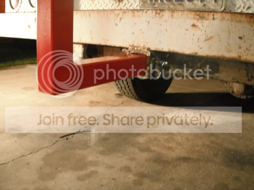

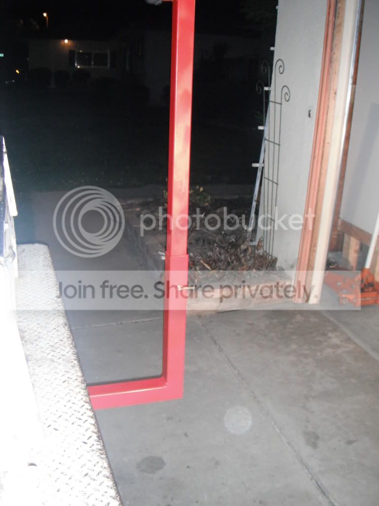

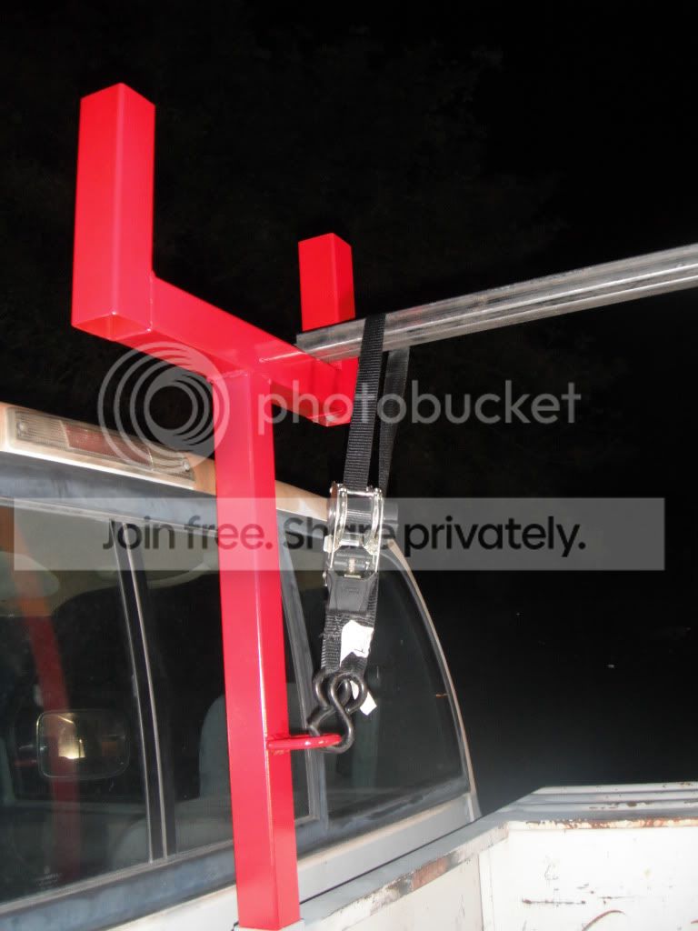

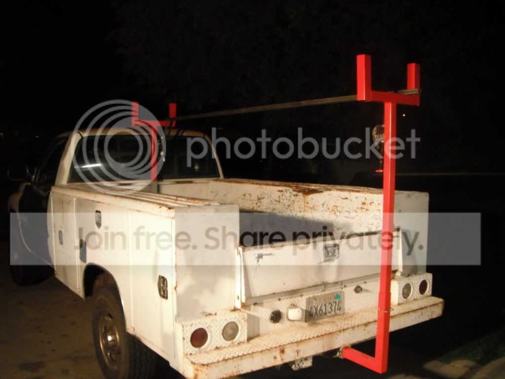

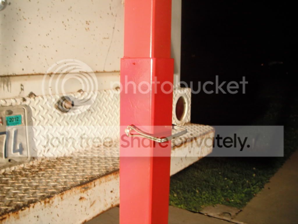

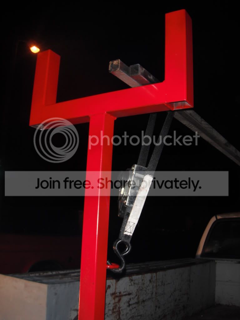

I put together a removable rack for hauling 20' pieces of tube and stuff tonight. I wanted something specifically for this that could be removed and easily stored in the garage. I store my trailer at a friend's house from church and it's about a 25 minute drive in the opposite direction of where I pick up material so I needed to do something besides waste all that time and gas every time I want something.
I set it up so I can still haul a 4x8 sheet of wood/metal and close the tailgate. That's why the front tube is notched into the back of the bed.
I ordered up a couple gussets from DIY4X so I'll grind the paint off and put some gussets here and there but here's what I came up with...
Oh and there's a bunch of primer on the bed because I spent an evening the other night welding up the hundreds (or so it seemed :)) holes that were in it.
