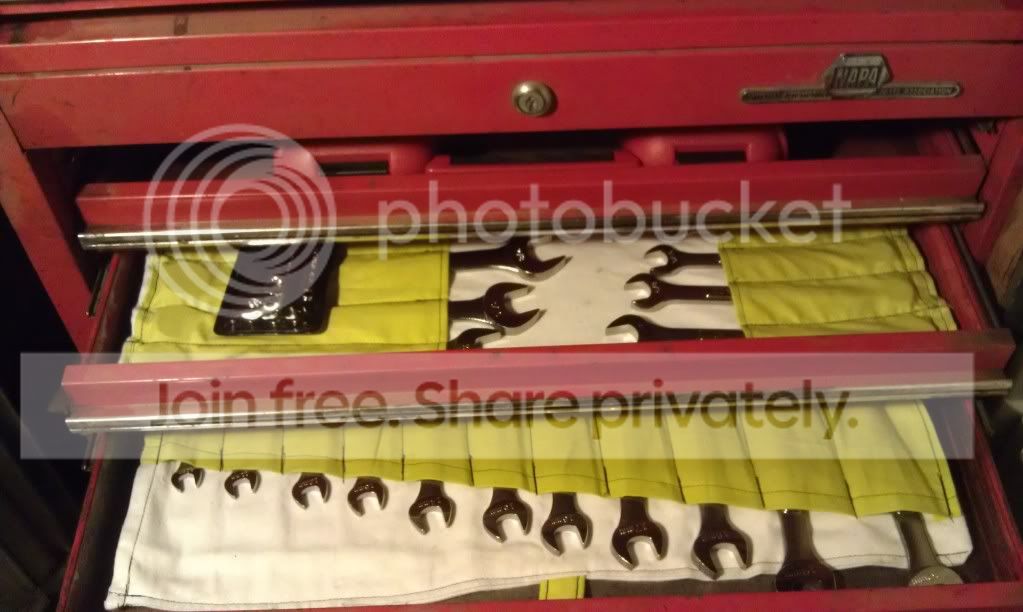

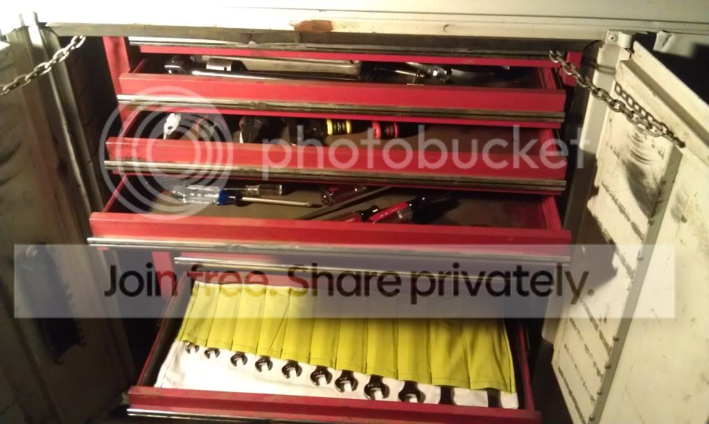

Got the drawers all figured out. I talked my sister into sewing up some tool rolls for the wrenches not so much for being able to pull them all out and go (although they work well for that) but mostly so they don't slide all over the place.
