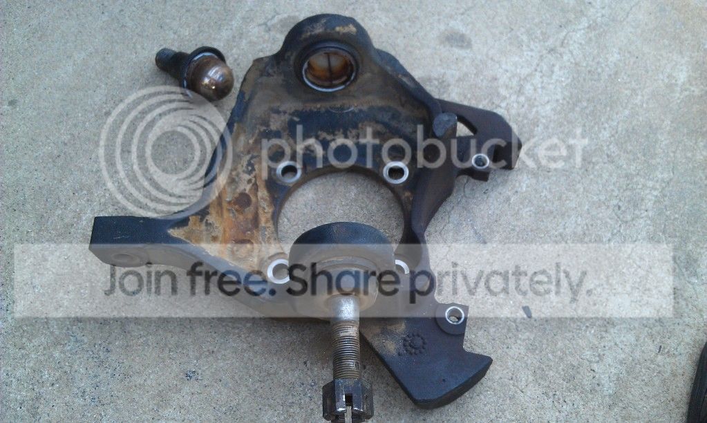

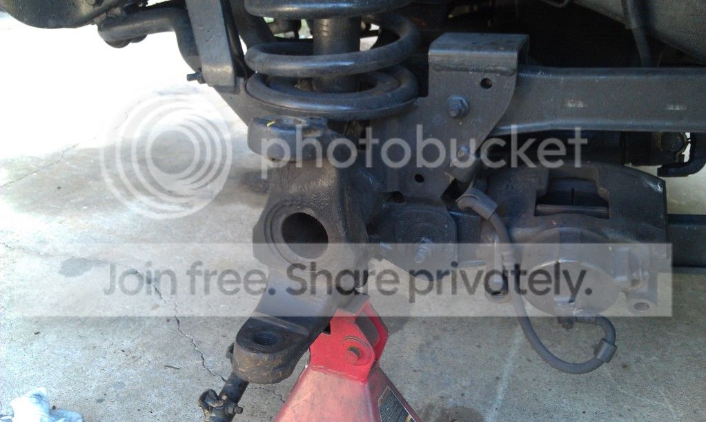

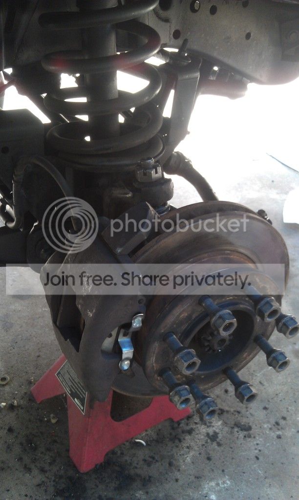

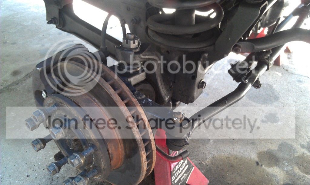

Well the day started good. I got the front end all pulled apart in no time flat but then my ball joint press said no thank you to these bigger ball joints.
It's a cheap one but has worked well for years on 10b ball joints and u-joints but it was no match for these.
So I ended up taking them to a shop around the corner and they pressed the old ones out and put the new ones in for $50. Well worth it and they did it while I waited.

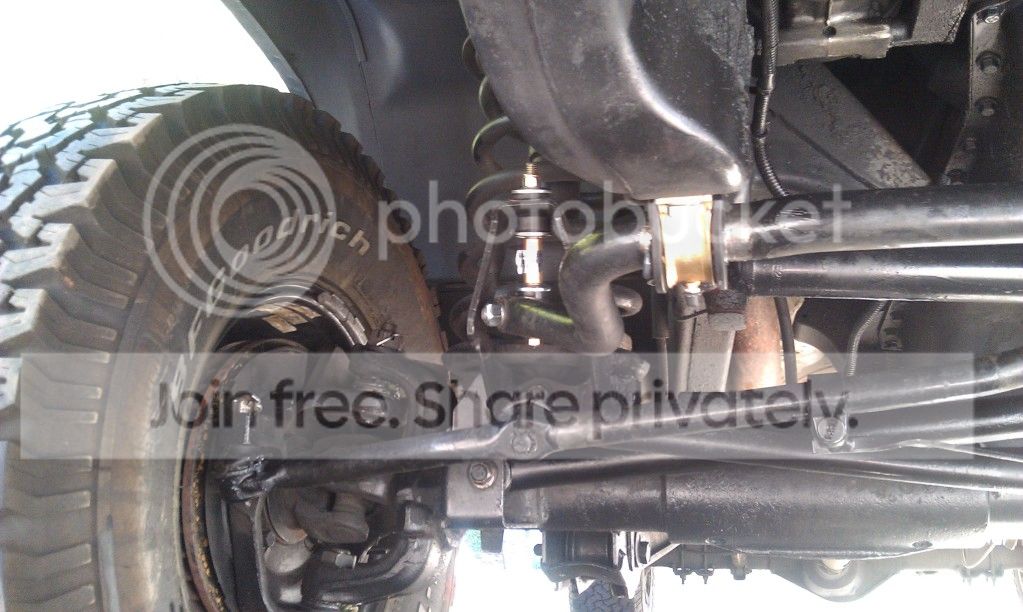

So I came back home and got the front end back together, it's nice and tight and should feel a lot better now.

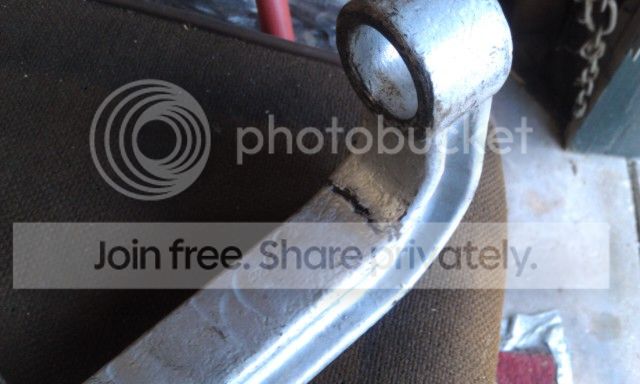

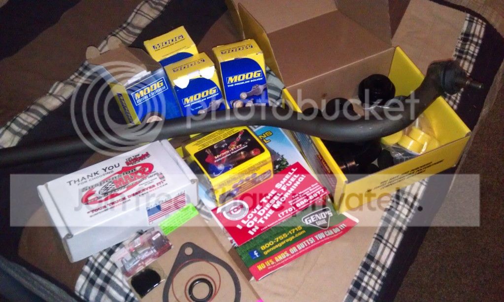

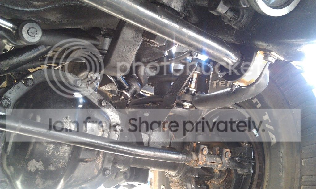

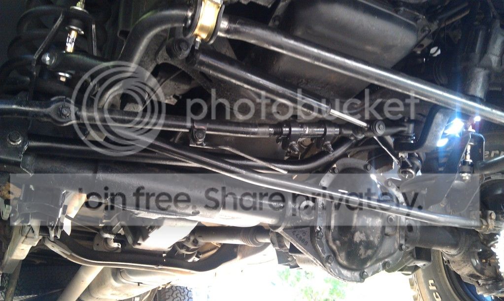

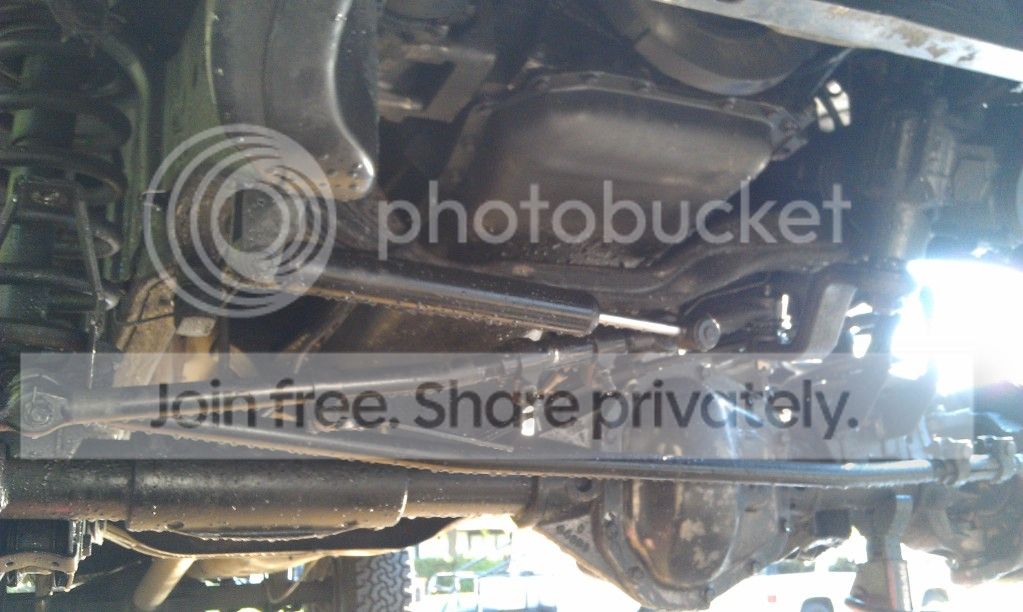

From that point it was basically all down hill. I couldn't get the sway bar links off and ended up having to just go through and cut it apart and then off the bar. No biggie since I'm replacing them with aftermarket ones. Then I removed the track bar and went to put the new one on and it wouldn't fit.

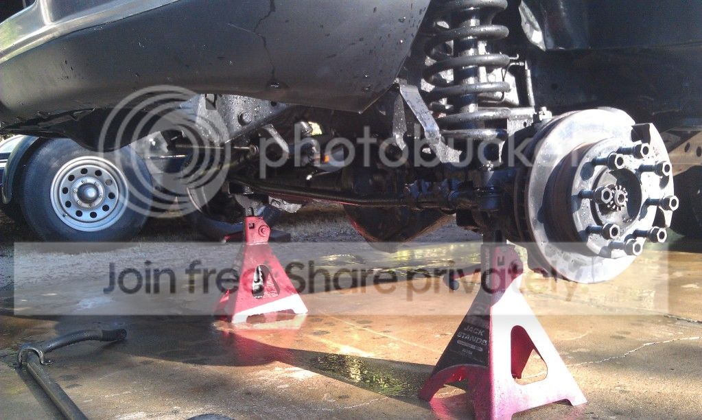

I wasted a bunch of time strapping the truck to the k10 to pull it into place as the axle was stationary on the jack stands and once we got it all aligned it wouldn't fall into the taper. Upon further inspection the taper is wrong!
I looked it up on MOOG's site and apparently 1/1/1994 through 2/7/1994 use one size taper and then EVERYTHING past 2/8/1994 uses another size. Freakin' screw you Dodge and your one month and seven day run on this size.
Soooo now I'm not sure what to do. I guess tomorrow I'll just toss the stock bar back on so I can drive it this week and go from there. I'll send this bar back and see if I can get the right one. Or do you guys think I'd be just as happy with an over the counter one at NAPA which I could get tomorrow and be done?
