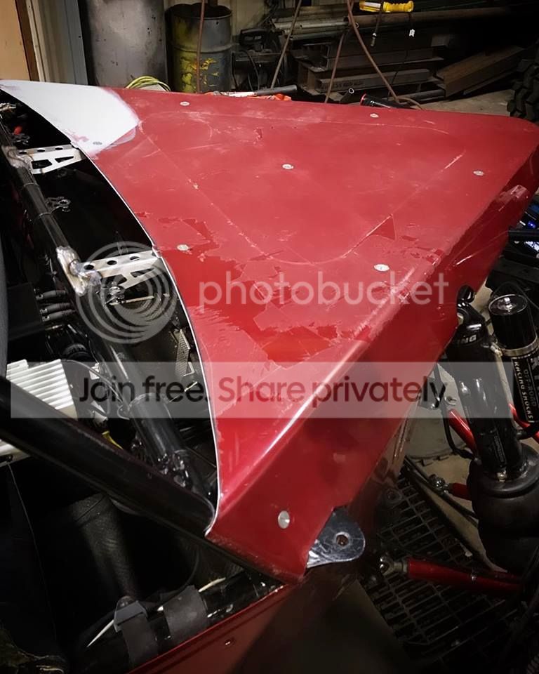

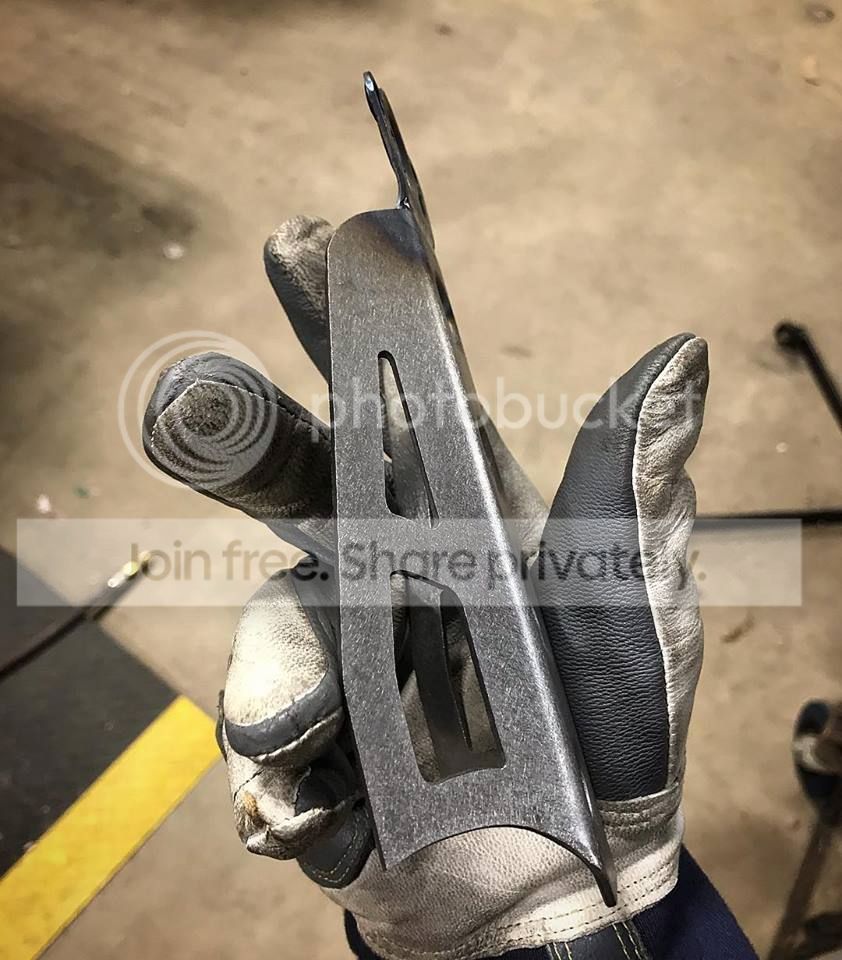

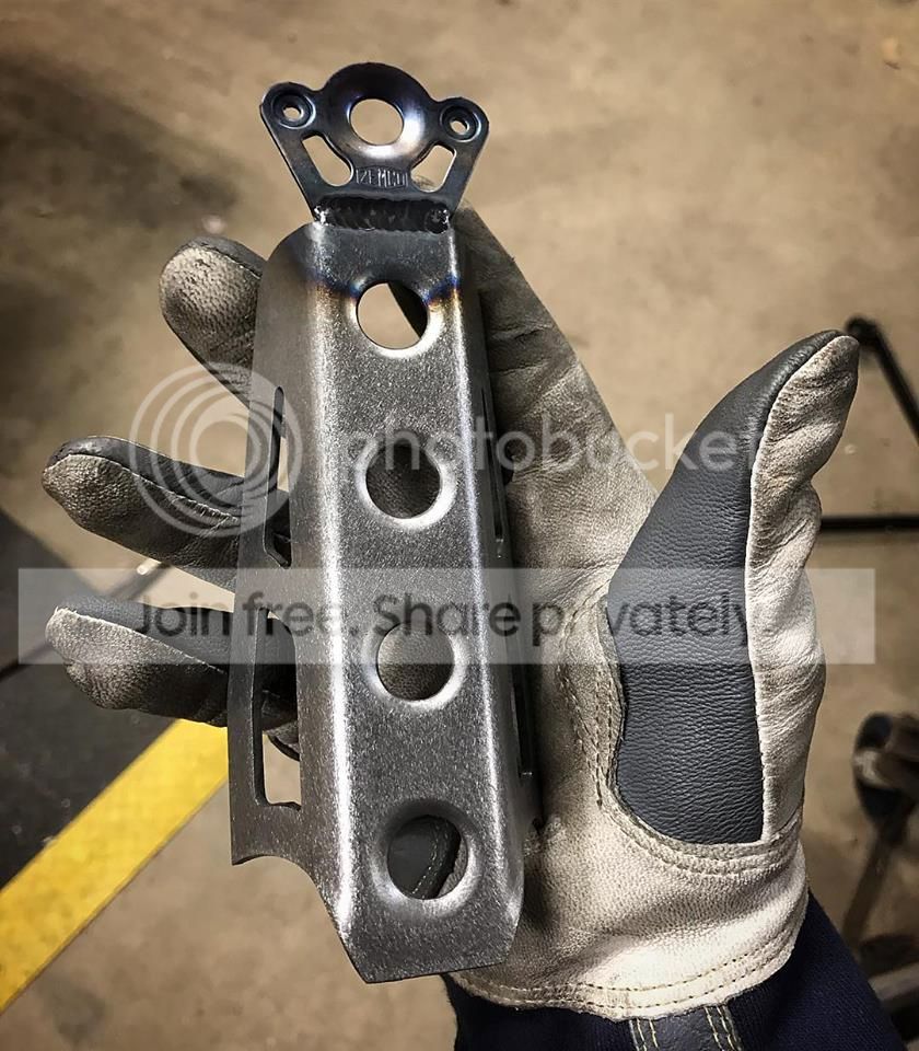

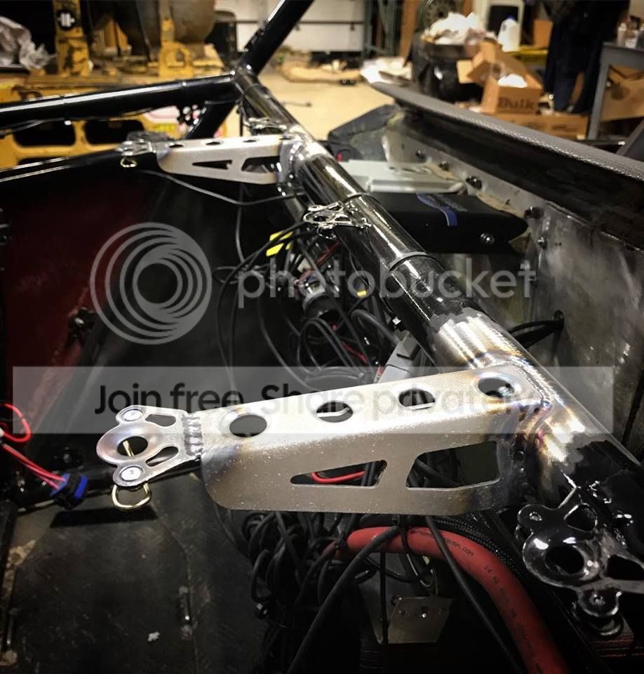

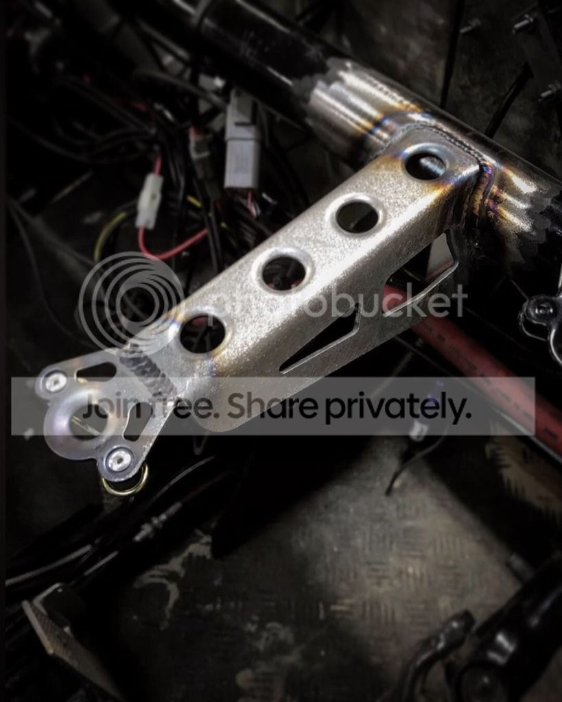

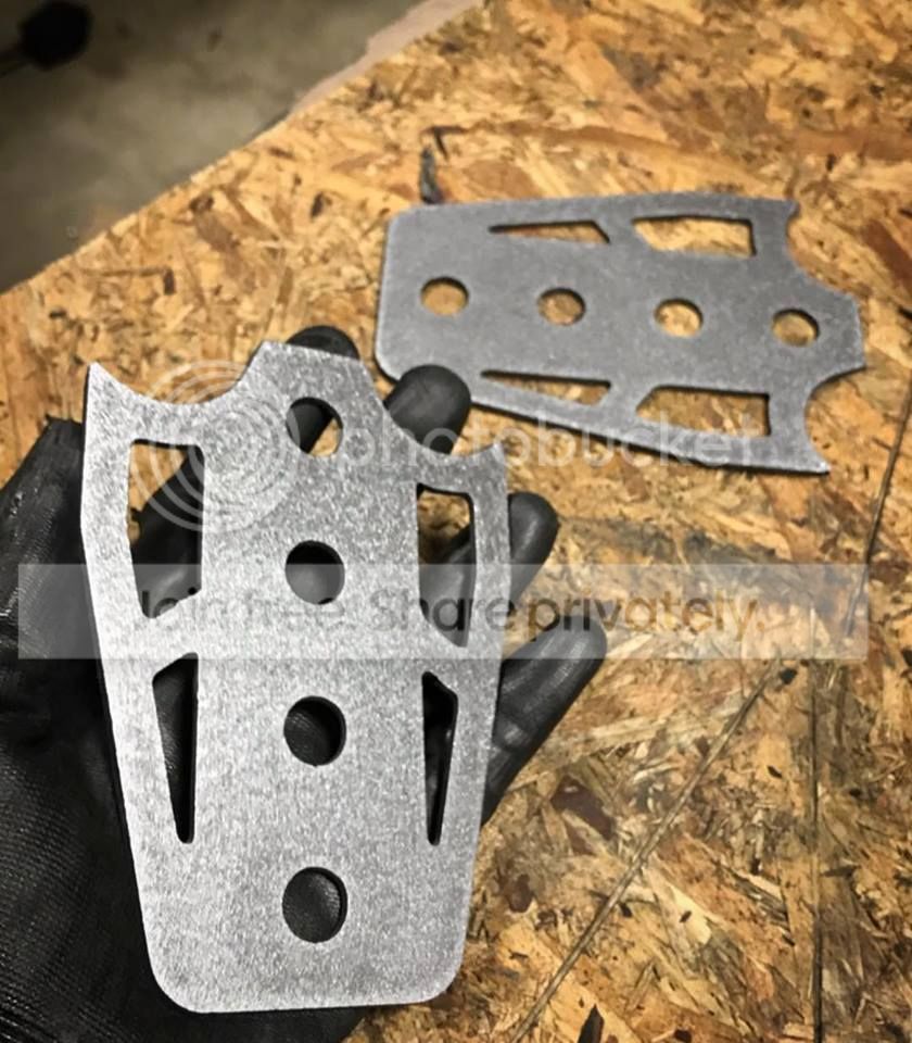

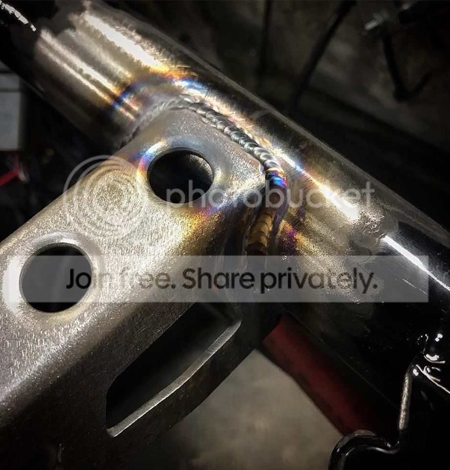

The windshield frame was recently added and its curved and sat over the hood. Making it a huge PITA to get the hood on and off without taking the winshiled frame off every time. So I trimmed the arc off the hood and made some 6.5" long brackets with a dzus tab on the end (yes I coulda cut it out of the bracket but I didn't have dimples for the rivet head recess).
Im happy with it, now on to the back.
