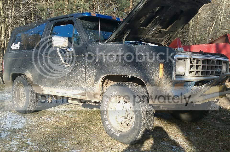

Wheeled it pretty hard last night. 4 lo, punch her in 3rd sombiatch will go through anything i swear. Launched off a sand hill out on some 2 tracks. Good stuff. At the moment no updates as far as mods, im actually thinking of keeping it low and same setup because for the trails around us that are super tight woods trails, the thing fits in perfect and we can actually haul around in them. Im sure it will get more pipe, I do still want the sliders and beef rear bumper, idk about the exo anymore, seems like alot of pipe and work, plus alot more added weight, It would prolly take around 60-80 ft of 1" sch 40 pipe to do what I wanted, and thats quite a bit of extra weight for the lil 2.9
