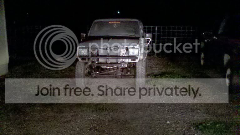

Here is one I am working on.
Cherokee front axle. 4" lift Cherokee springs. 3 link. Rear axle will be an 8.8
4.0 out of an exploder, along with the 5 speed and soon a doubler using the explorer t case and the original BII t-case. He is going to run 35s for now. It basically lifted it 3". We need to do the rear leaf packs and get the 8.8 in there.
Buddy who is building it probably has about 2k into the whole thing including buying the BII and the explorer he took the motor and trans out of. Will have probably 2500 in it after its all said and done and on tires

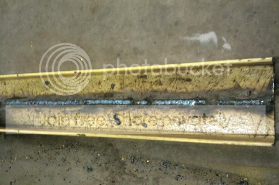

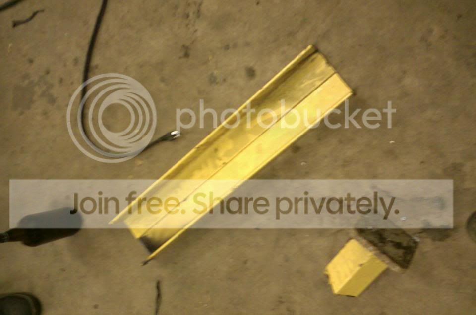

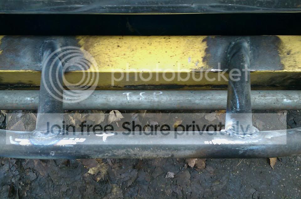

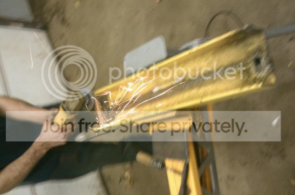

Oh yes made some beef. Boxed in the frame horns with 1/4 angle and welded it together to make channel, then boxed the ends in and tied the tubes onto the angle. It is pure beef awesomeness.

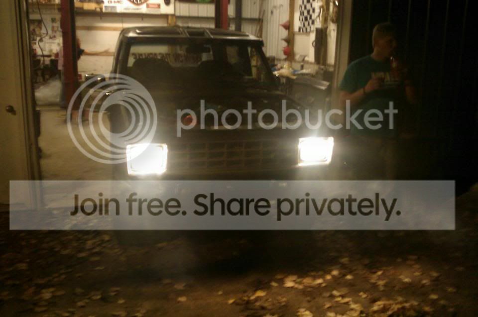

We also got it running, found out mice chewed more fuel line than we found the first time. Went out to-trackin. 4lo this things a beast, climbed up some hills I never would have dreamed it could.

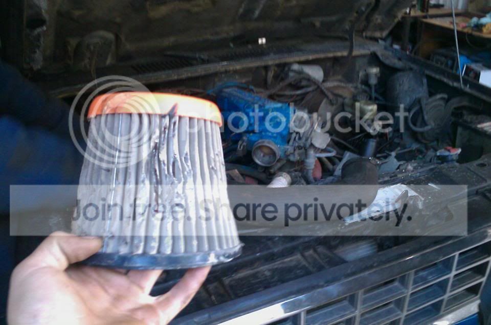

And the first carnage pic... Lol, broke off during some harsh bumps and the alternator ate it up pretty good lol

So so far since we brought it to my buddies, im in $30 for welding wire.... And thats about it!!!:thumb:

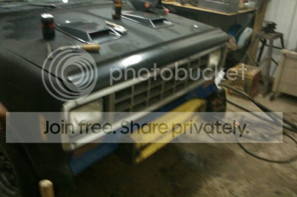

Make a skid going from the bottom of that tube to the frame so its doesnt stand out so bad. That would look good. Im sure it doesnt help that the frame is yellow lol.
Takin the whole thing off to blast and paint it so the yellow frame box won't show so bad. It's definitely beefy as heck. Once we put the d44 and ford 9" from the ranger on with the lift I will make a skid plate to keep mud and junk out of the engine bay as bad.
