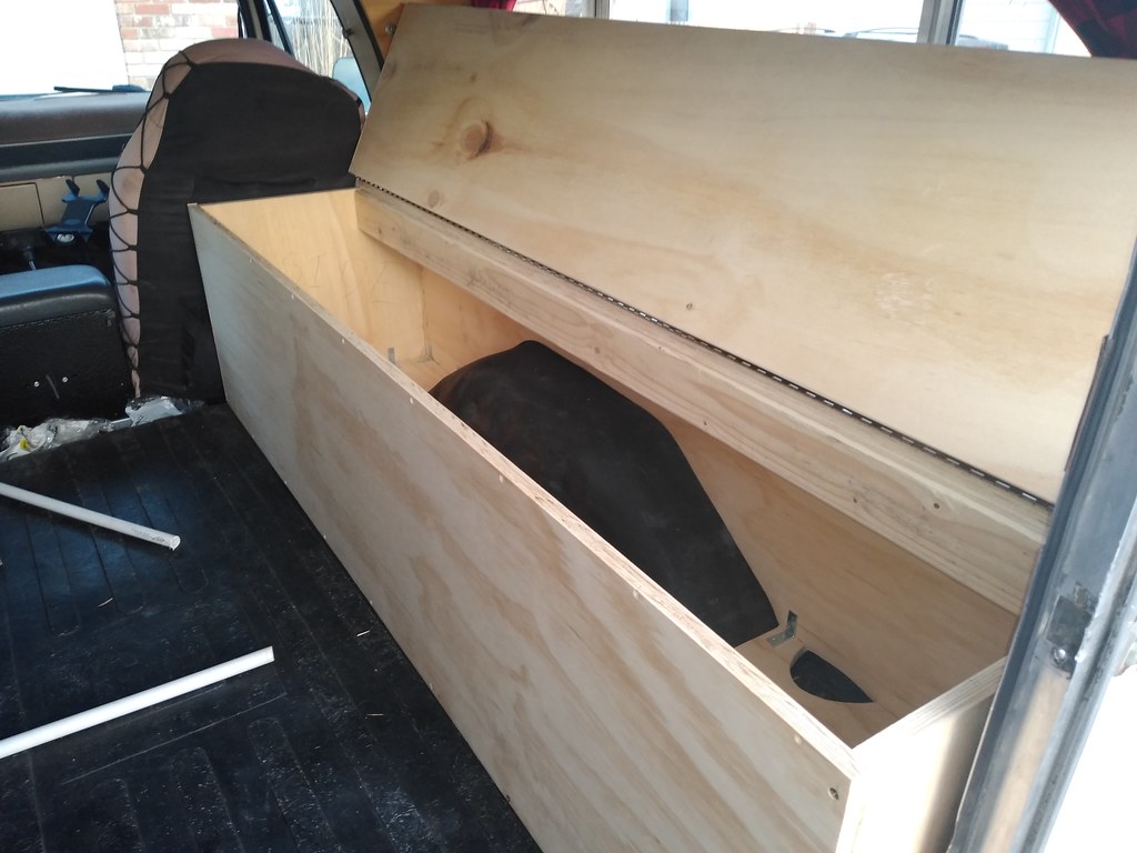

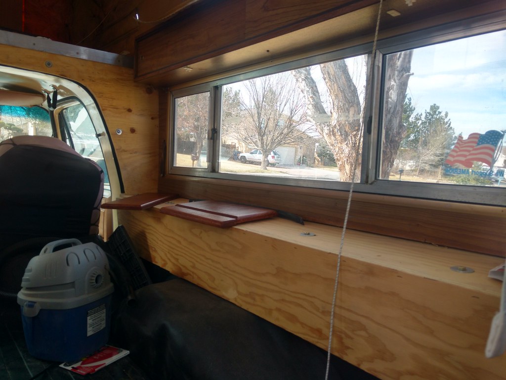

You have the beginnings of a good plan. On the passenger side you'll be wide open and could build around the shock tower. This pic is early in the camper development as there is still a vertical board over the wheel tub (that got deleted for version 2). If the tower is below the bedrail you'd be in good shape to build a box to cover it. Both boxes I've had in mine are even with the top of the bedrail so that the overhang part of the camper adds a little bit of width to the sleeping surface and allows the box to be a little narrower to have a wider isle to stand in.

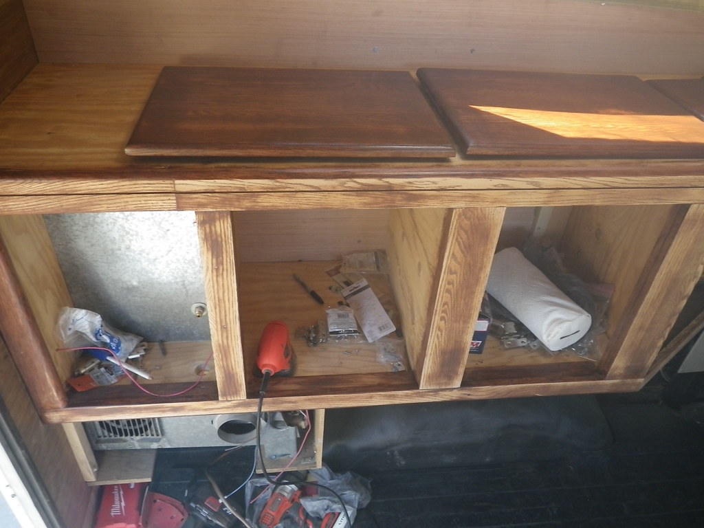

On the driver side, again as long as the shock tower is below the bedrail, you are pretty well set. The cabinetry hangs over the wheel tub by 3-4". Even if the tower is further in you could work around it. You can see the location in this pic. The furnace in the back corner on the left. It hangs below the bedrail but is still above the floor by a few inches.

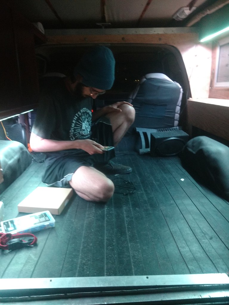

This gives a little better perspective from the back.
A look inside the box.
The beauty here is the fact that the camper doesn't attach to the floor of the truck. Keeping within the limits of the bedrail for overall height on the shock towers you could totally build around them and still have 98% of the storage that Ron or I have in ours. Full standing height to be able to get dressed easy, stretch out, whatever. The lower bench in mine with my side flap that folds out gives me just enough room to sleep in length and width. It's right at 6ft long by the way. There's the cab over area to sleep in, but I've let my son stay up there. Without making the canvas section taller I can't sit up in bed as I can down below.
