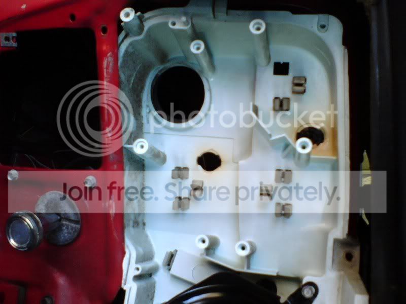

im changing all the bulbs, i yanked the gauges out of the 3 gauge cluster. and now i got a couple questions...
the circuit board behind this, what can i do about it and will there be any issues with leaving it there? what should i do to run the gauges since there aren't holes, just use a hole saw or dremel it, i mean it could be just enough so the gauge sits right...:p:

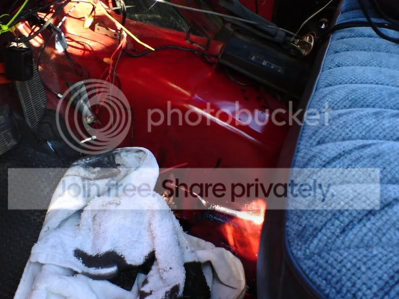

also, for you that want a laugh, i took the oil pressure gauge out and never put it back on and i went to park it from where i had it (see pic above) and i look down and i'm like EXPLETIVE EXPLETIVE EXPLETIVE i leaked a nice amount of oil all over my cab on the floor, at least there isn't carpet! i was pissed i was that dumb, i dropped about 1/16 if not a 1/32 of a quart so no concern there but wow i'm stupid..is it possible to piss the oil out of the motor completely that way? i cleaned it up before that pic but i took one anyways :haha::mad:

no really though, that circuit thing behind the gauges..can it be removed or cut or will that be a really bad idea?
i think you can usually fit the gauges inside the plastic housing in front of the circuit board... I went straight custom so I haven't played with that... do NOT cut the printed circuit board..
