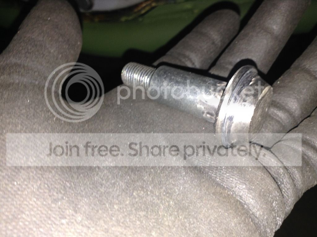

Also I finally got a steering stabilizer. I actually only spent $20 on a shock :eek1:. Thats like a new record low for me :whistle::D
The old mount wouldnt work, so I cut it, flipped it around, shoved it to the u bolt and welded it in. Also welded the fancy bolt the kit came with to the tie rod. It was going to hit the dif cover it I made brackets on the back side.
