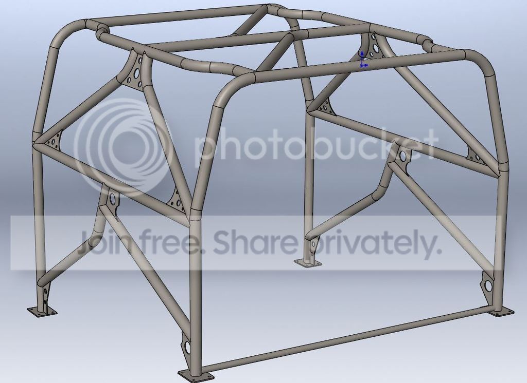

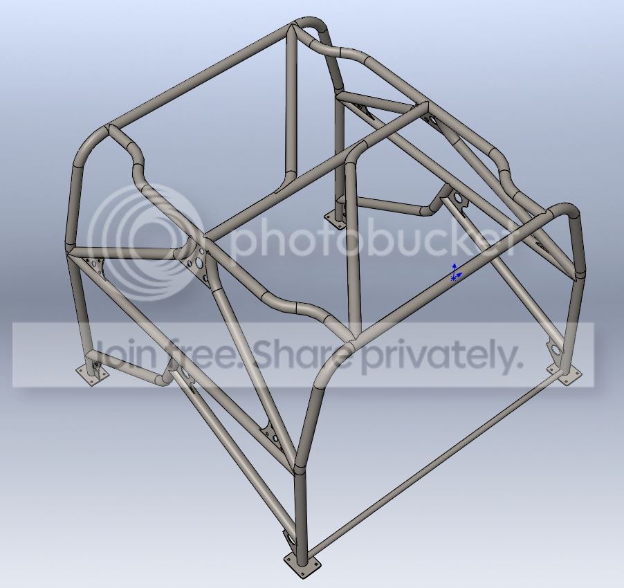

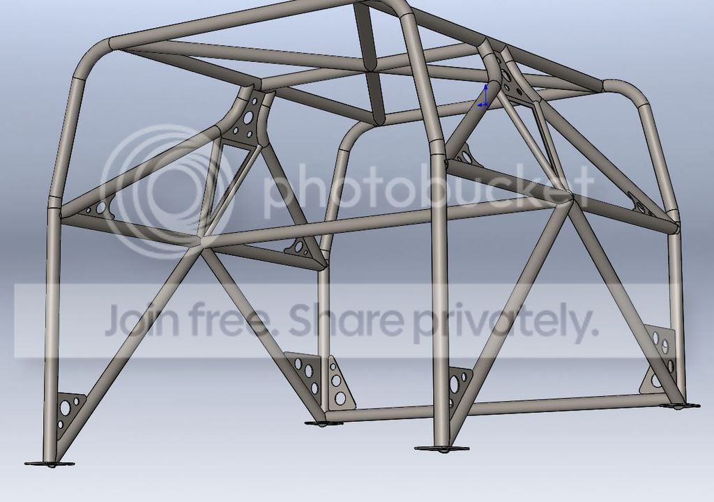

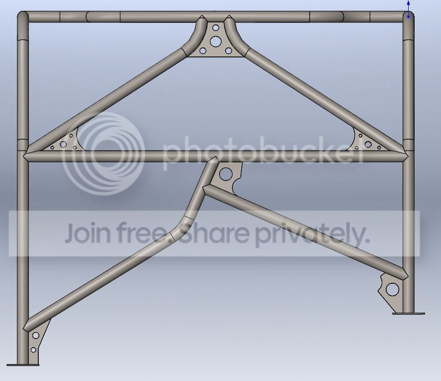

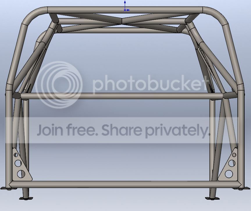

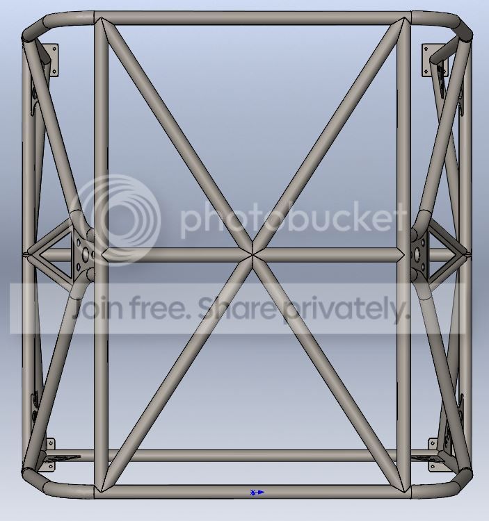

Why the funky s bends on the 2 roof bars
Some can't be avoided. In all reality you have 5 that don't need to be dead nodes. I would like to see an actual x in the roof structure or a \|/ or something like that.
I like to minimize the amount of bending I have to do.
Dead nodes. Ugh.
Make the sides an X instead of the two V s
Betcha he doesn't want to cope the bend
I really liked the upper connection point of the side in the middle. I don't see how connection with a dimpled gusset is all that much different than the tubes coming in at the same point.
I could change up the lower a bit. But I don't want an X.
