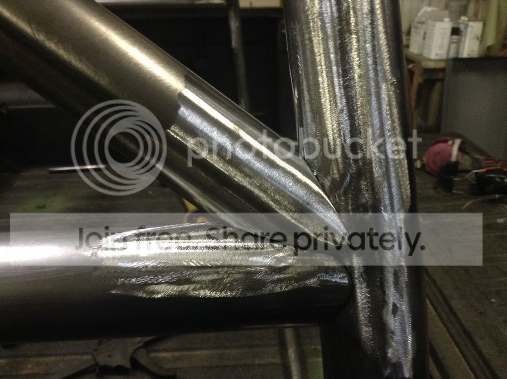

And just so people don't question me, no there is no magic notching machine im using, my best method I have found for big angles, is to max the notcher out at 50 degrees, and then use that profile to extend the notch. Then once I get it to fit good, I draw the cut onto the next tube and that one always takes about 1/10th the time of the first....
