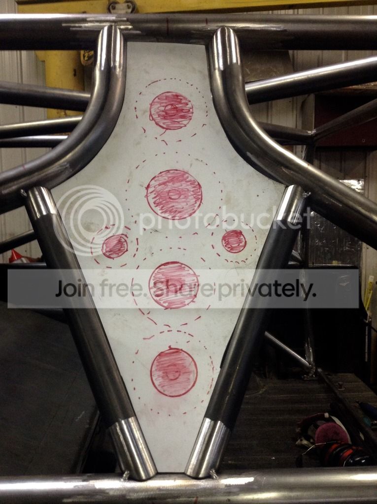

list of cool things.....
Red sharpie.... check!
thanks duderman!

So I decided I didnt want to use the 1" for the arrow head gusset thingy. So i asked a buddy if he had some 1.25 or 1.5. Had a stick of 1.25 7 ft long. He also said, hey do you want that chunk of 1.75 DOM you have had sitting in the corner of my shop for 2 years??? lol. (this is the guy that bent my shock hoops a few years ago that I never ended up using, this is what was left of the stick lo)
So it all fit in chevy sonic no problem, because as we all know chevy sonic is a boss :pimp:
So im thinking dimples everywhere (even more than posted in the one pic) instead of the triangle cut out thing.
And just because...
The side bars actually kick in a bit and give a bit of side to side bracing which I like.

Im kind of upset at how wide the "arrowhead" bars go. I really wanted them much more vertical. But they will work fine.
Just not as "perfect" as I would have liked. But i dont have enough tube to remake them. Nor is it that big a deal that I fell like cutting those notches to get a few more degrees vertical lol.
The one good thing is it allows for WAY more dimple action lol.
