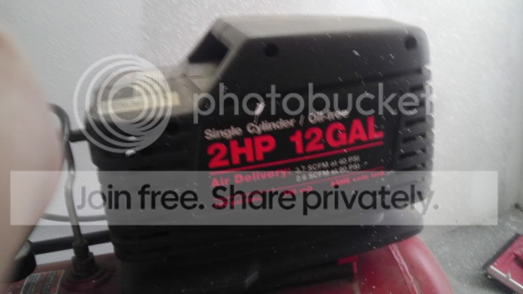

Do you think this compressor would be enough to paint with?
what are you gun requirement?i dont think it will big enough,(4hp 30gallon)mine puts out more cfm and it works hard.i'm looking at a 60gal 8-10hp.
