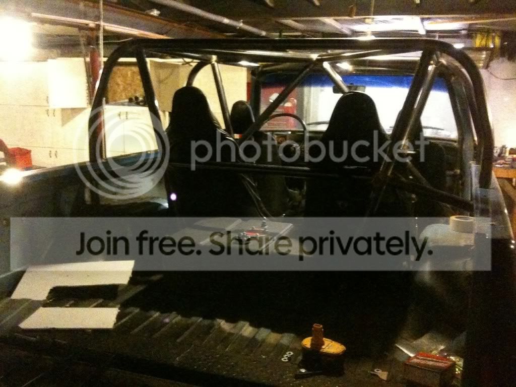

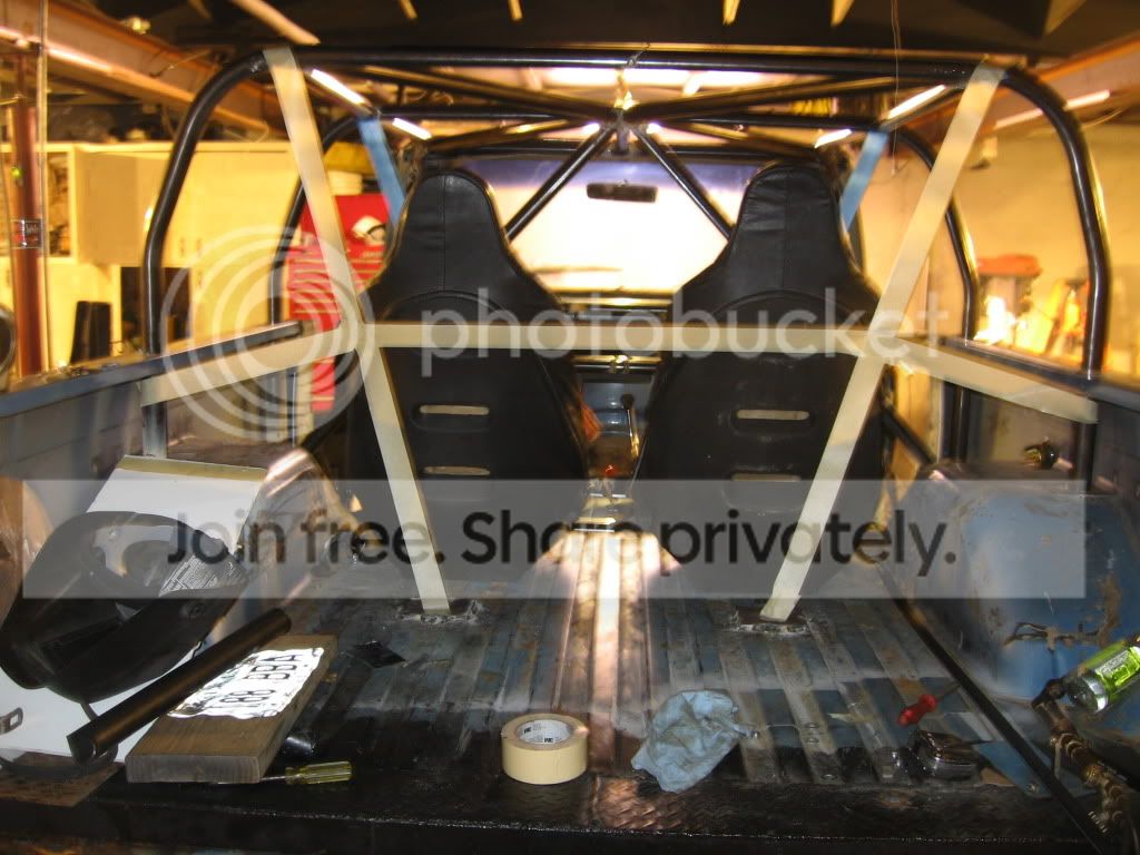

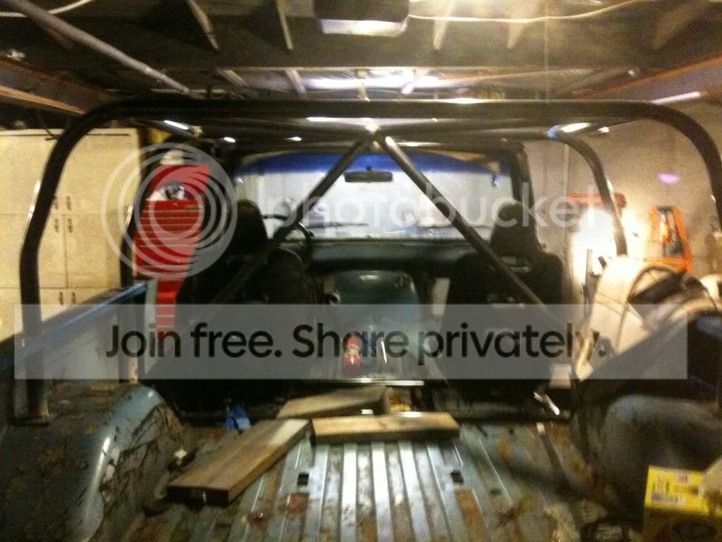

I think I would do the V in the B pillar the other way, more in the shape of a V. An X would be best but need something to support the corners, they will take the hardest hit in a rollover.
I debated about this alot and If I ran them the other way they were going to give 0 leg room in the back. I am going to run another tube to the corner so it will be a y on each side. I am waiting to run this piece until I get my seats mounted because I am going to try and place it where the seat belt will mount. If this doesn't make sense then I will draw a picture for ya. Thanks for the help!

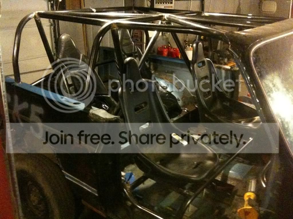

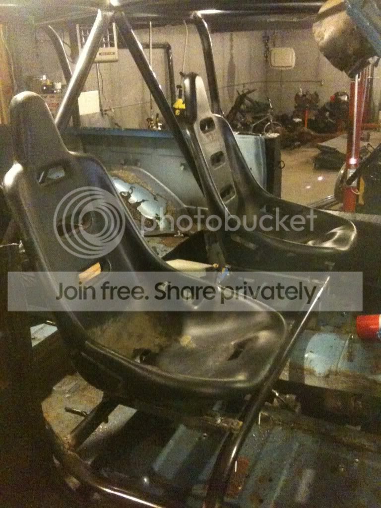

Front seats are in...
I got the front seats in. They are on sliders so they are adjustable, I built frames for the sliders and then welded some 1/2" all thread to the frames. This way I can adjust the height and pitch as well.
looks good.the way you did it will allow some options.its nice to be able to move the seats if ever so slightly to get that perfect spot.

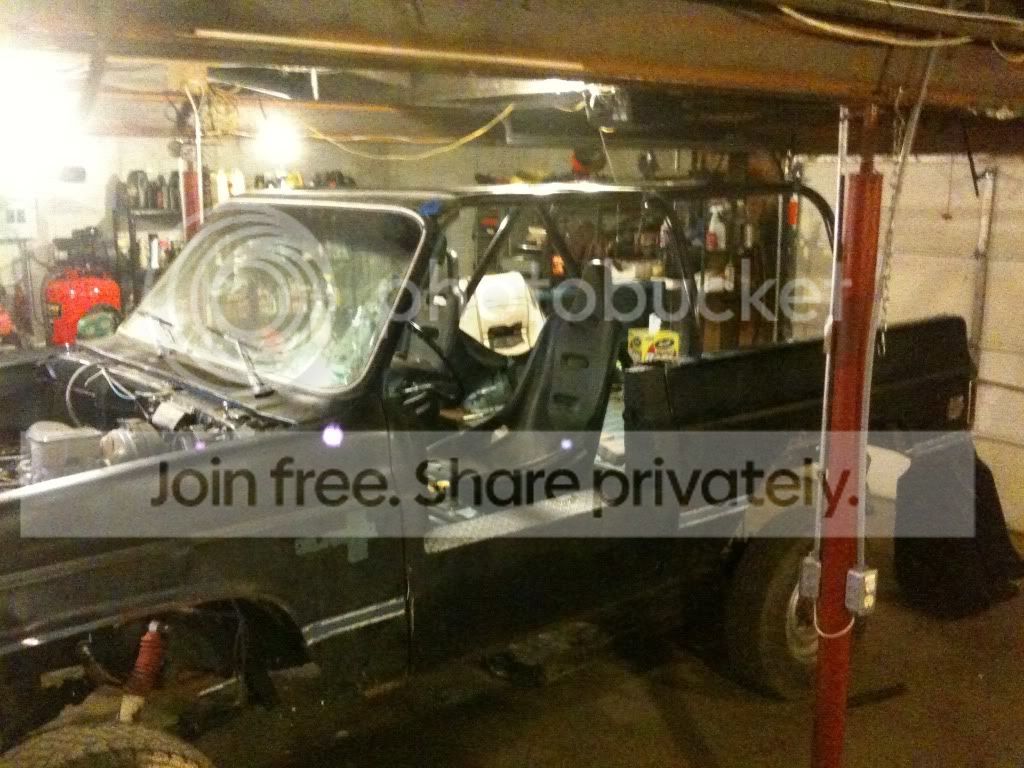

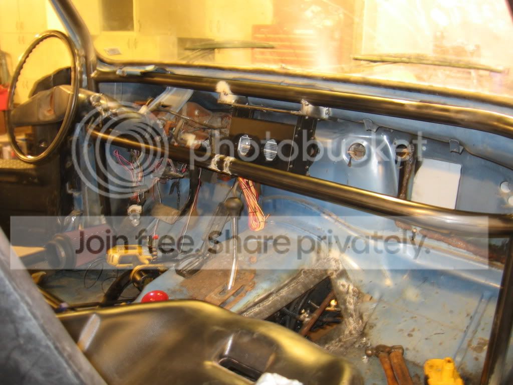

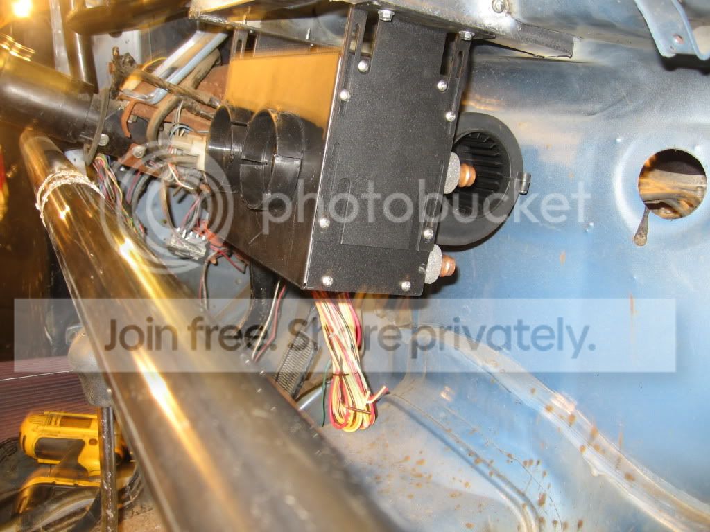

Some pics for ya. My brother came over and helped me get the dash in and the heater in. I went down tonight and ran out of wire for the MIG :rolleyes: and so I started taping off my cage so I know whats left.

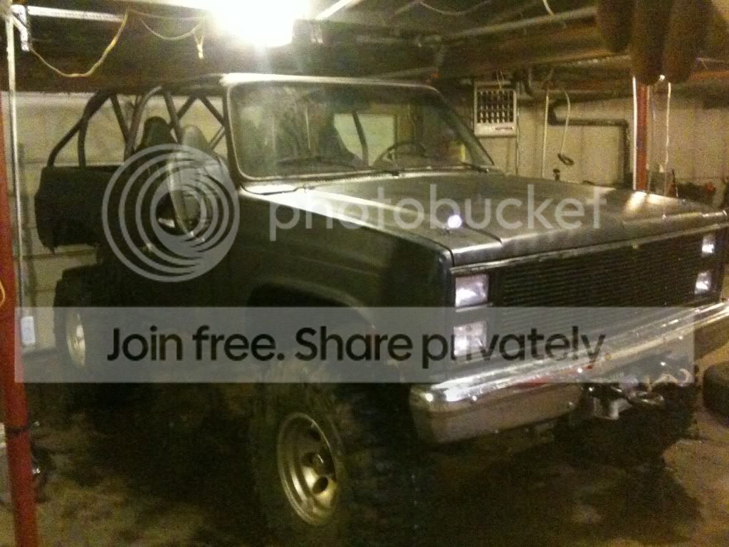

So I took the last two days off of work and got alot done. Here are some pics. My buddy is planning on coming over tomorrow night and burning in the cage. I just have two more pieces to add until the cage is "done". I think I may add a few supports here and there. What do ya think?

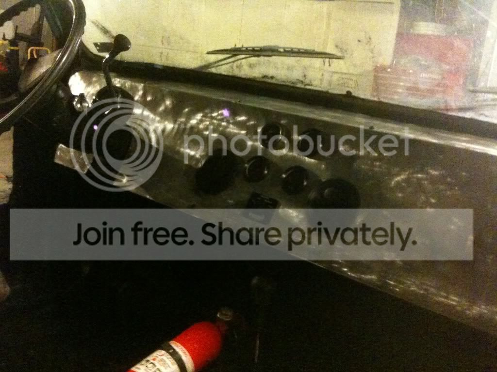

Here is a picture of the dash. It isn't a very good picture but I put the gauges in the middle with the two heater vents on either side.
