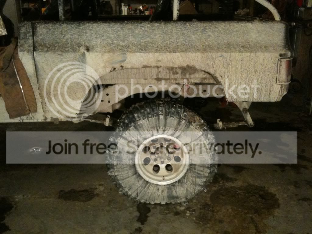

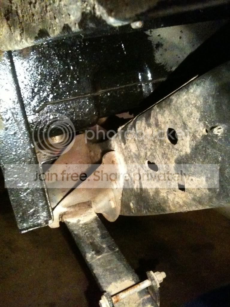

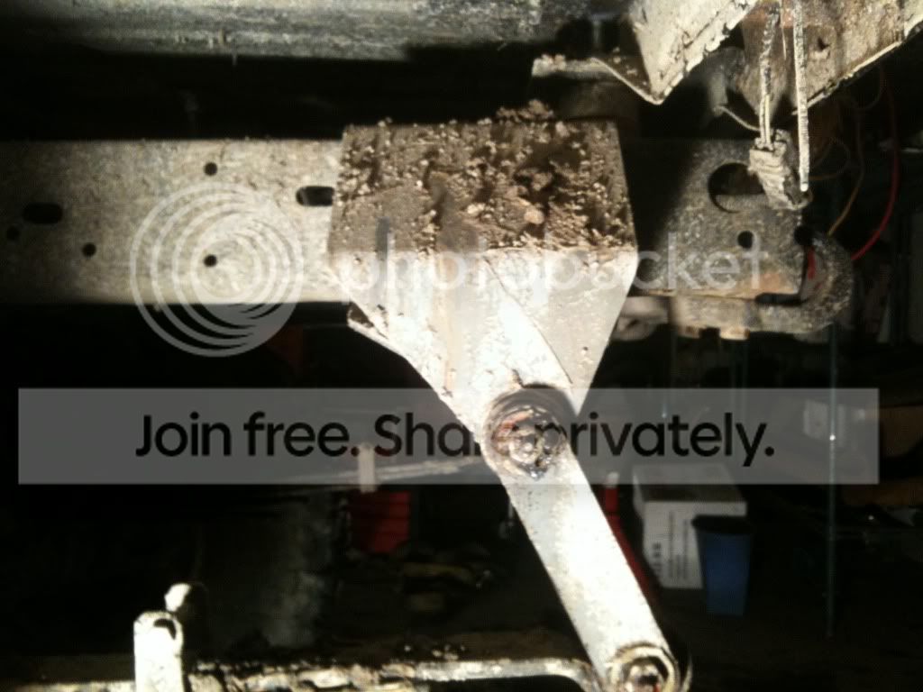

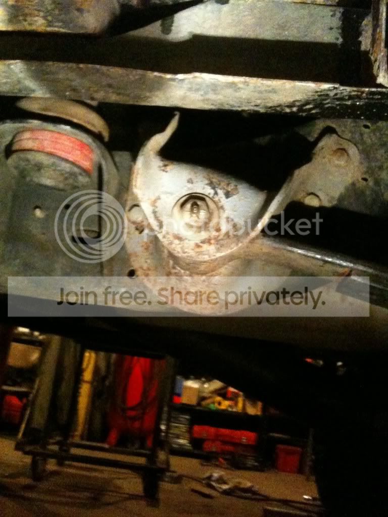

I actually bought the K5 with the suspension the way it is, I just modified it a little. I ran down and took a couple of pics for ya though.

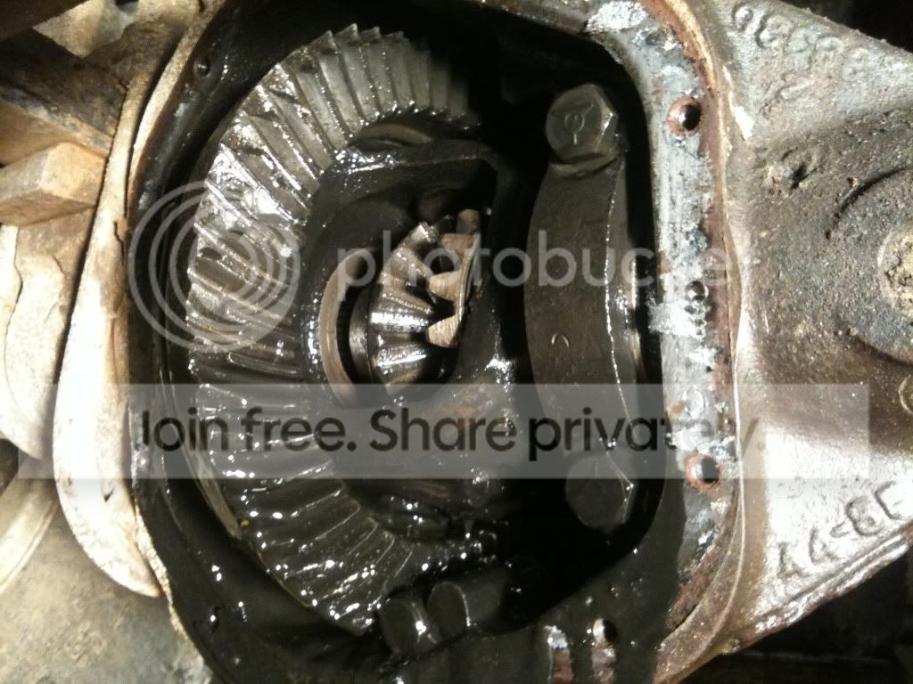

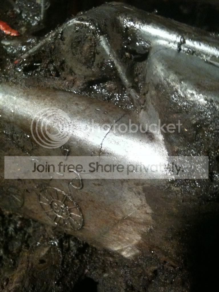

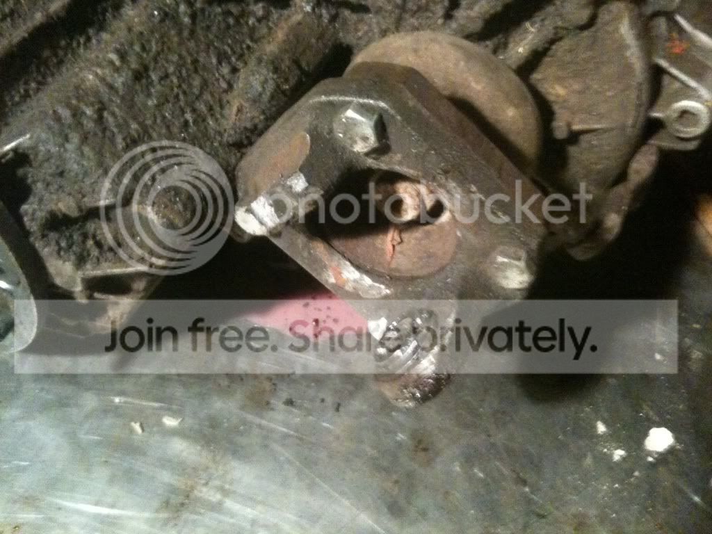

So I tried to go wheeling yesterday and thank goodness right before I pulled down into "the point of no return" I decided to check and make sure my 4 wheel drive worked. It didn't, found a broken front drive shaft yoke and then this morning I decided to pull the front diff cover and this is what I found.
So my next project is getting the 60 rebuilt and installed. I have just over a month before my next wheeling trip and I would like to get some seat time before then so we will see.

:saweet:Thanks man that was cool. I am waiting on my new springs to arrive. And have been trying to work through how to mount.:thinking: It looks like mine will be farther forward. How close is your axle to stock location?
I took some pics but I cut the back part of my frame off so it is kinda hard to figure where the rear sping hangers are mounted. The back edge of the rear hangers are 3.5" from the center of the large hole in the frame. I am guessing my rear axle is back 2"-4" from the stock location.

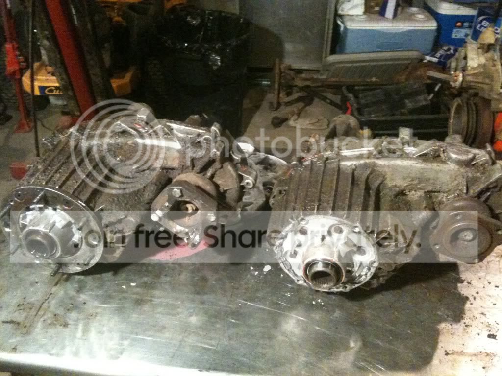

So I blew up a front driver's side ujoint trying to get out of a 5' snow drift in my driveway. Dug for 3 hours to get her back into the garage. Replaced ujoing and stub shaft and rebuilt both hubs. Then I tried to go wheeling the other day and right before I pulled into the "point of no return" I said to my buddy, "I guess we should make sure the hubs are locked in. I threw her into 4 low and got nothing from the front tires. Pulled back up to the entrance and found both front hubs were locked in but I had no 4wd. Upon further inspection I found my front driveshaft was broken up by the transfercase and my transfercase leaking a bit of strawberry milk shake. I was puzzled because it was brand new fluid with no road time. I got it back to my house and found the damn tcase cracked, and the ring, pinion and spider gears are all in pieces in the bottom of my D44. Plan is to take the front half of my old 208 and throw it on my new 208, rebuild D60, install detroit, install flanges, install srw hubs and then install the D60 in place of my busted D44. I have an event I want to go to on the 27th of Feb. I hope I can get it all done in time. Here are a couple of pics for your viewing pleasure.
