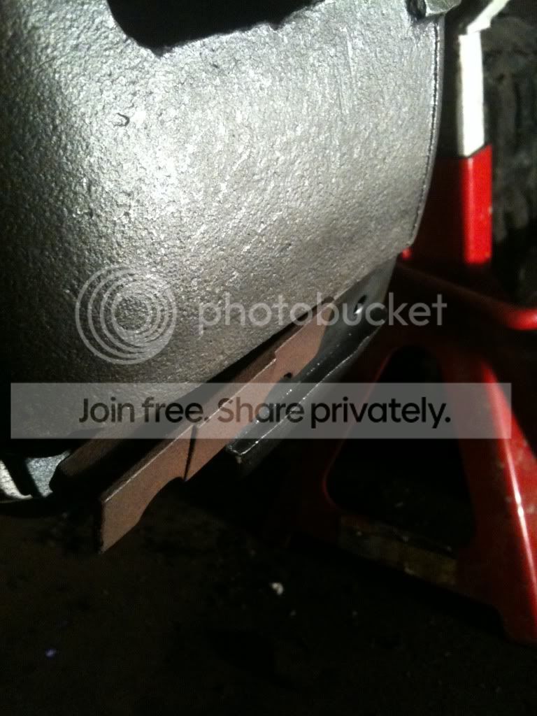

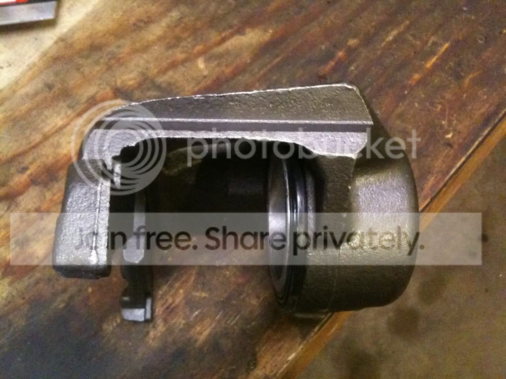

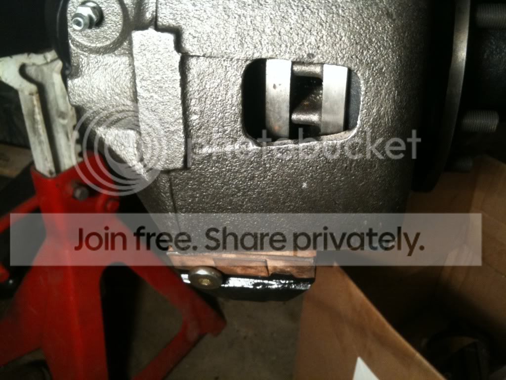

Major SNAFU! What the hell are up with my new calipers? I installed one and it was extreamly difficult to get the bottom retainer piece in and then I noticed that the calipers are curved which is causing interferance. :mad:
This pic you can see the caliper is riding up over the retainer piece.
This pic shows how the caliper is tappered. WTF? Is this normal?
This pic shows how far I can get the retainer piece in until it gets in a bind.
The calipers I got are for a 1980 K30 front axle. They should be correct right? I don't see how I could be doing this wrong! :confused::confused::confused:
You realize that the caliper brackets are not identical from left to right, right? I mean that if you put the drivers side caliper bracket on the passenger side, the calipers won't bolt on properly. Don't ask how I know that. :doah:
I know it sucks, but try putting the caliper on upside down and if it fits like that, you gotta swap the brackets.
Edit: And if you're like I was, you're going to head out to the truck and realize you spent the last couple hours dialing in the bearings only to realize you have to do them all over again. :(
bracket 3464L/3465R. I just cleaned mine up enough to see that on them.
