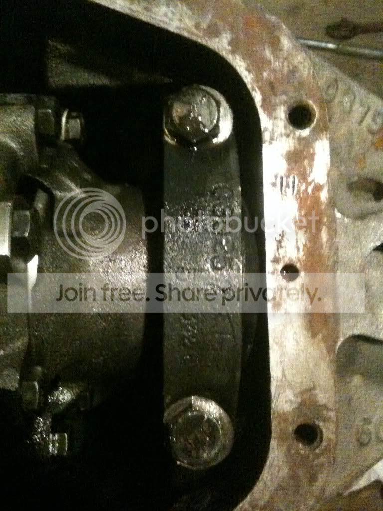

After some cursing and throwing chit and wondering how soon I can get a new cover I decided to investigate. After cleaning all of the rtv that I put on the axle I realized that one of my bearing caps was machined crooked and it was interfering with my new cover.
I think I will be able to shave a little off of the cap and a little off of the cover and make it work.
