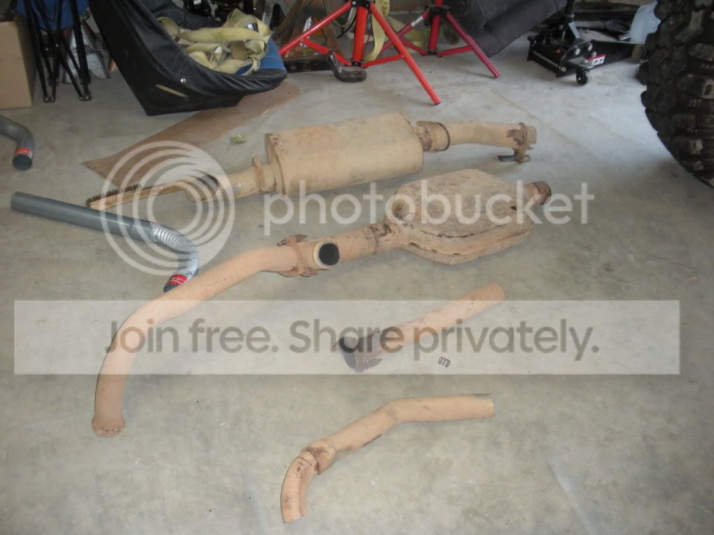

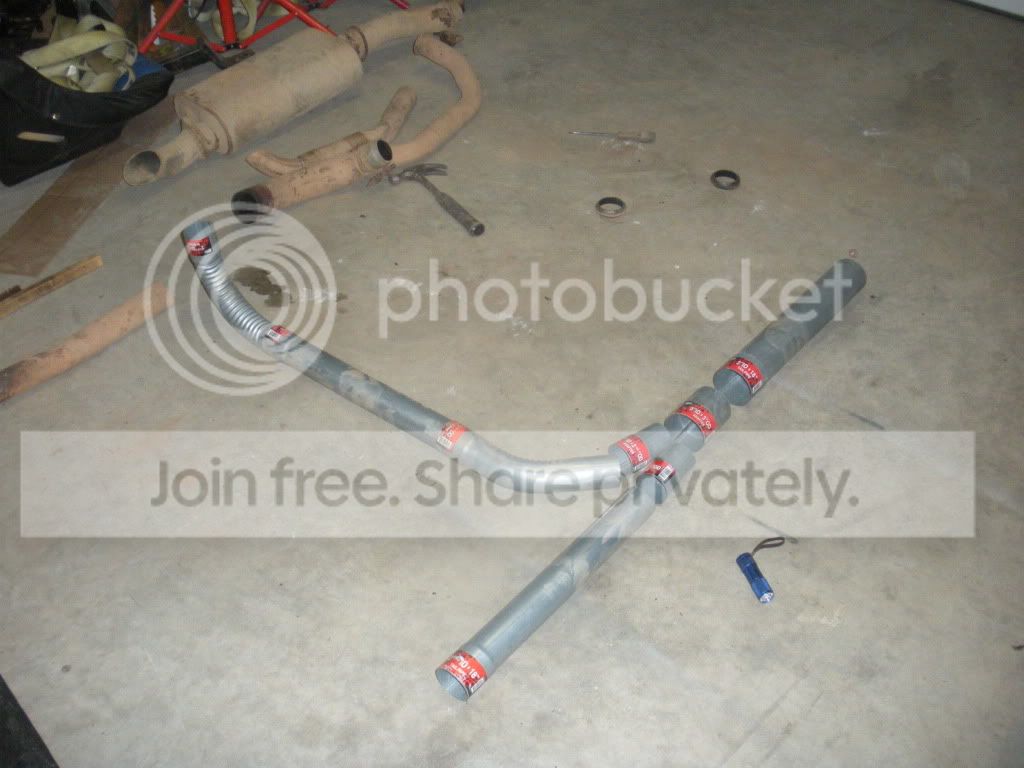

Uggghh well I finally bit the bullet and started on the exhaust. Broke 2 manifold collector bolts. Got them drilled and soaking in PB Blaster. Hope I can get them out tomorrow :cry: but it is all removed, and I don't think it will be too hard to build this new Y-pipe with the pieces I have. Gonna keep both stock down tubes and maybe a portion of the 3" where it curves up to where the cat used to reside ;) More new 3" back to the muffler then a turn down.
Kinda how it will be layed out. I am gonna try and build my own 2 into 1 piece from the 3 adaptors and some 18ga. We shall see :)

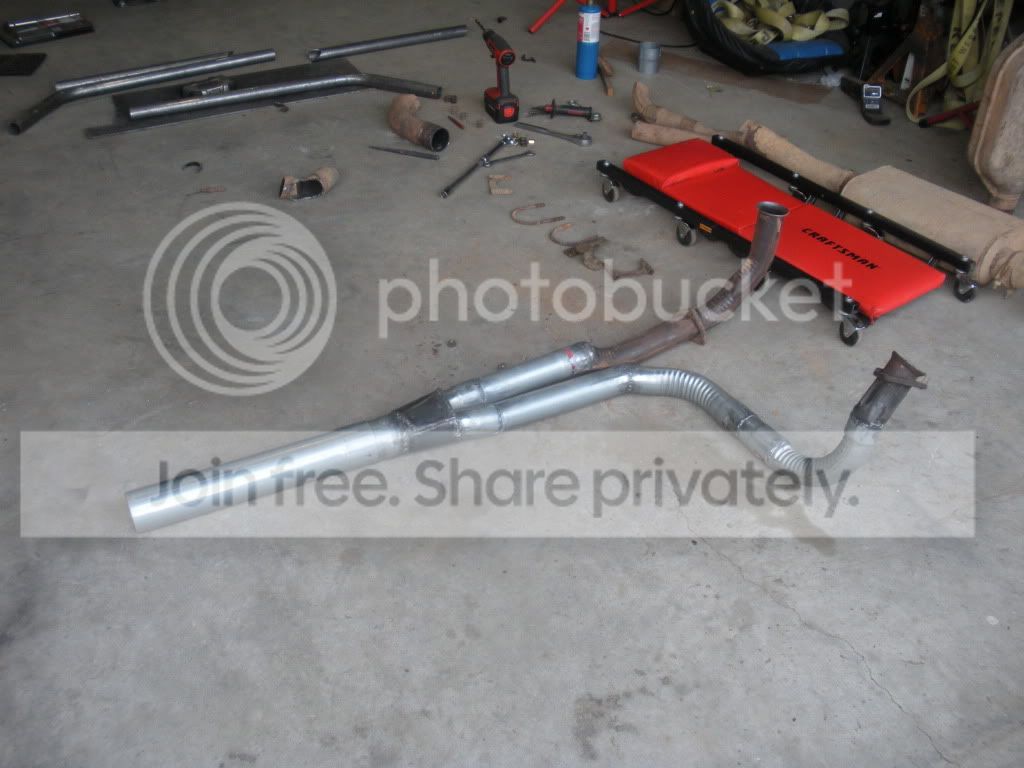

Y-pipe is done. What a PITA! I almost gave up and bought my own 2 into 1 adaptor, but ended up making one. I dont enjoy welding thin metal at all and it required a LOT.
Should have it bolted up tomorrow so I can add one more piece of 3" then the muffler.

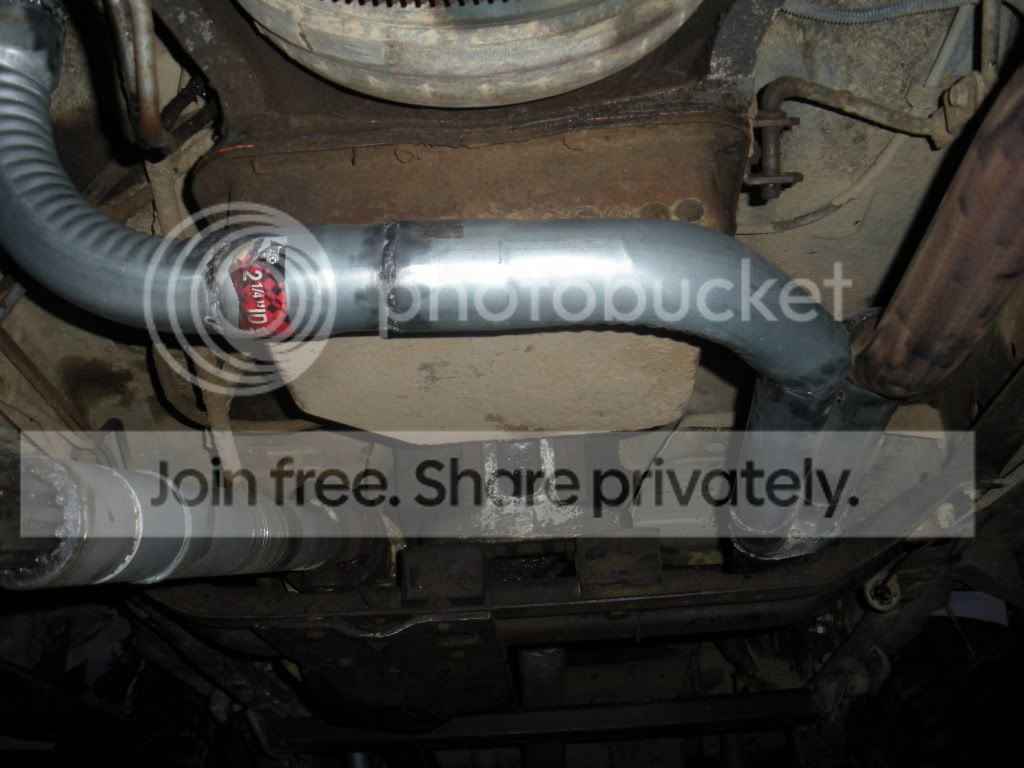

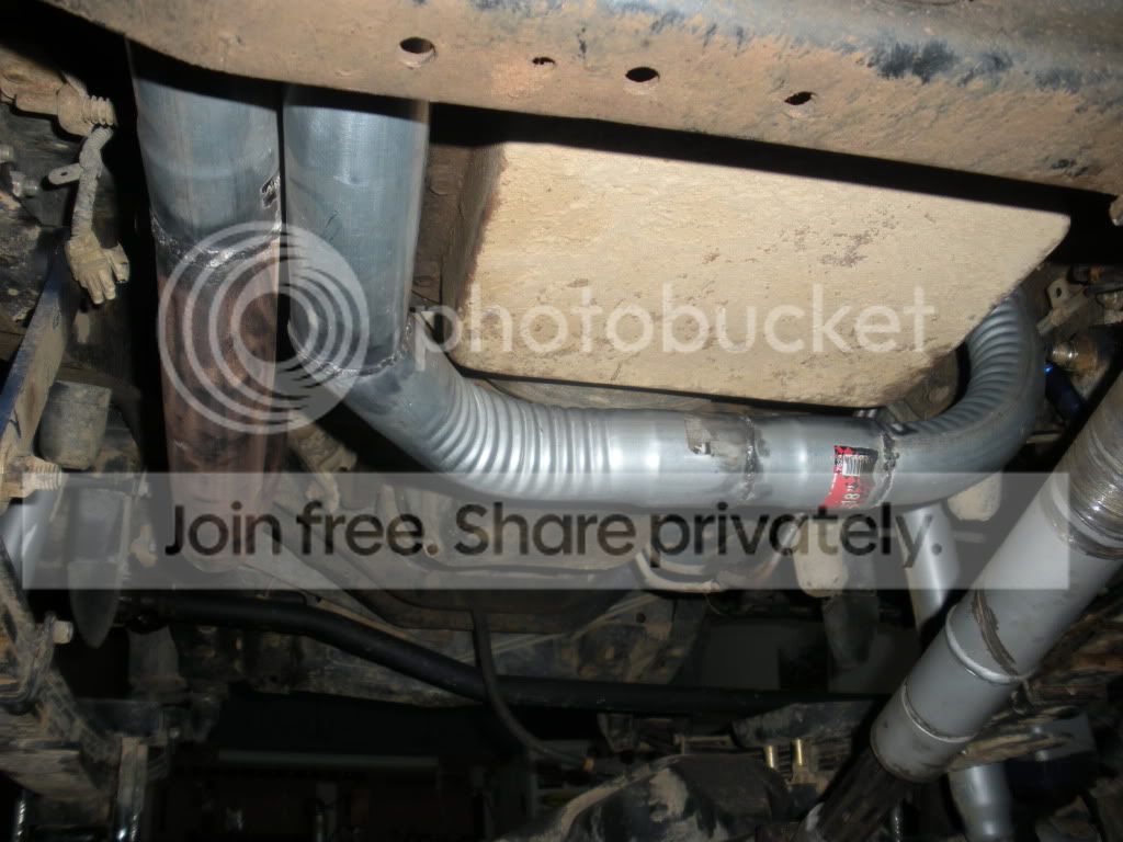

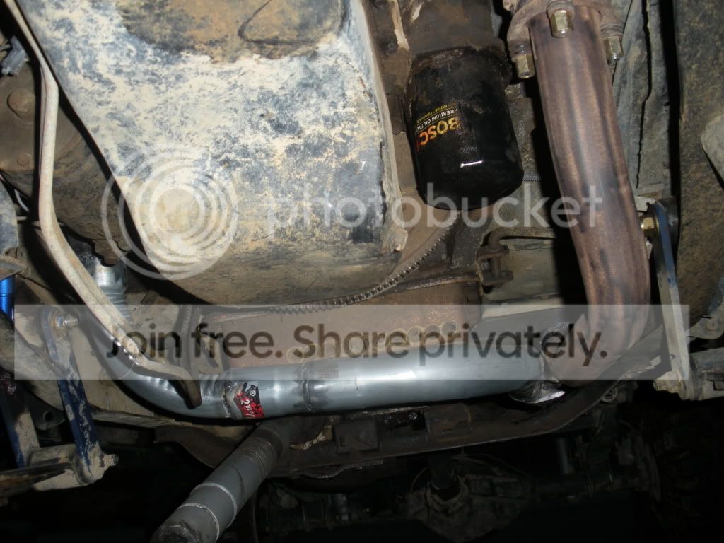

Ok finally started installing this thing tonight. Got it done all the way back to the last piece of 3" then the muffler. Not quite as tight around in front of the pan as I wanted, but it should be good. I have very little uptravel in the front so we shall see, but at least I won't drag it on the ground anymore :rolleyes:
Its probably not the freeest flowing design with the non mandrel bends, but it has to be better than the dented smashed cobbled together thing that was on there before.
There will be about 18" of 3" then the 50 series flow about in the stock location. Managed to use the stock hangar just aft of where the cat used to reside.

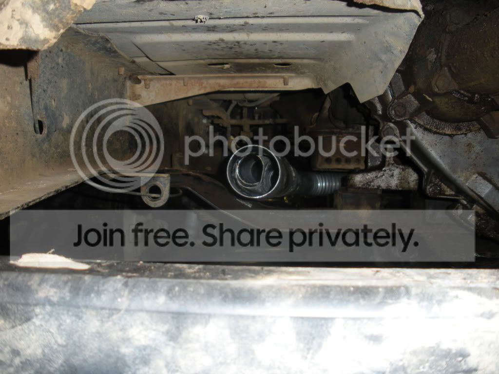

View inside my homemade collector. Should work better than grafting two pieces of 2.25 together.

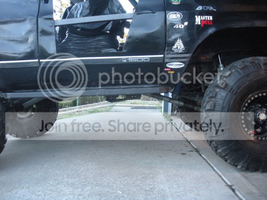

how close is it to the driveshaft, looks like maybe 4" of uptravel in the first pics, and then it looks much better in the last.
also dont worry about not having a mandrel bent exhaust. i highly doubt a 210hp 350 is going to notice. otherwise it looks pretty good for not using a bender.
Yeah my motor is stock so..:rolleyes:
There is prolly 4 or 5 inches between the shaft and the tube. I have about 3-4 inches before I hit my bumpstop. I imagine if it ever does touch it will be very lightly.

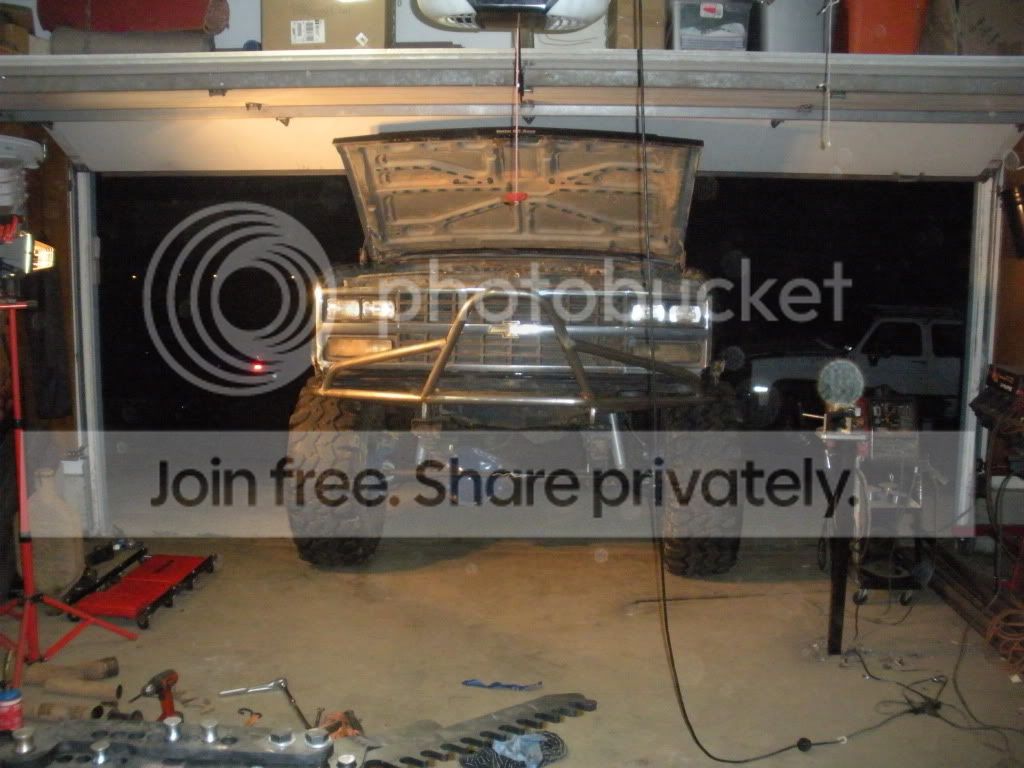

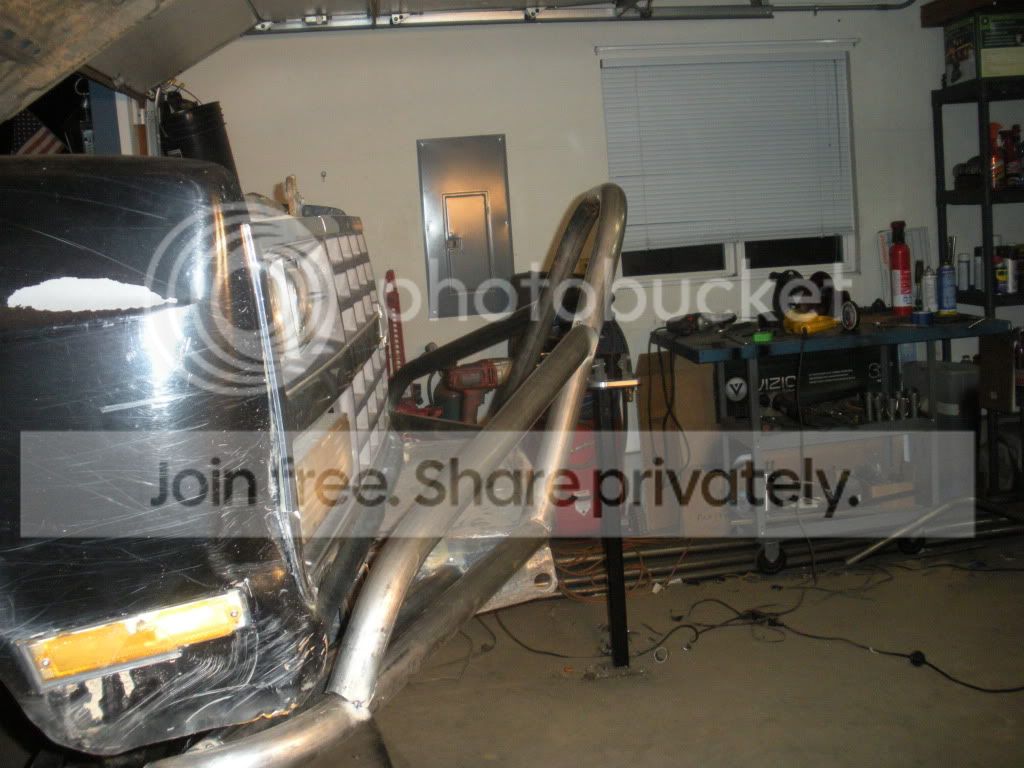

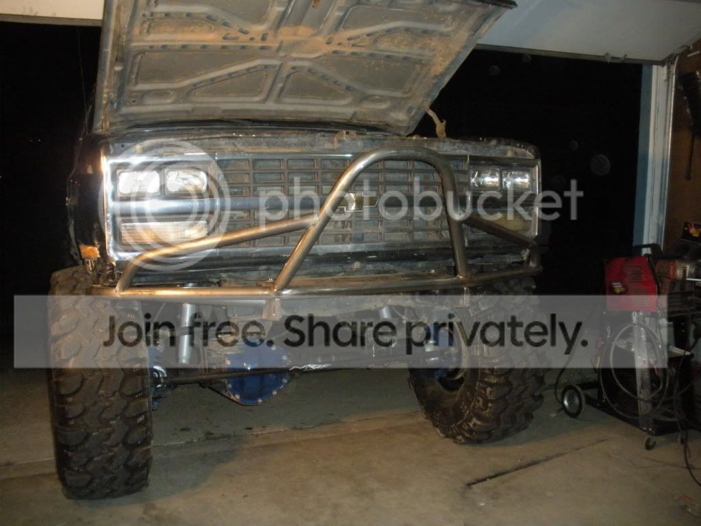

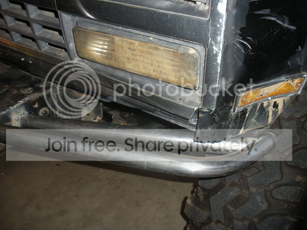

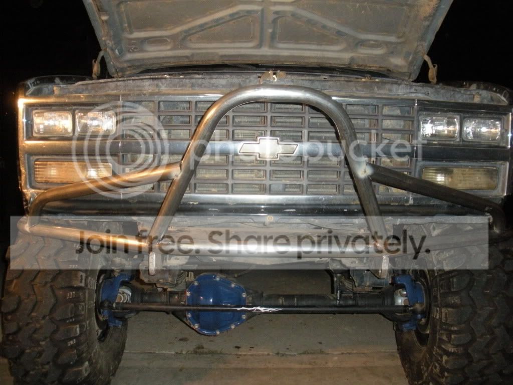

Got the last tubes notched and tacked on to the bumper. Ready for final welding then add a fairlead mount and a bottom plate to the center section.
I was going to wrap the upper bars around, but liked this look better, and much easier to notch LOL
