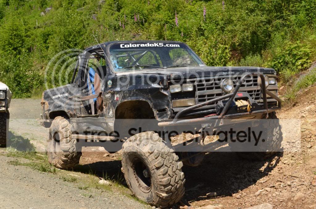

"Hardcore" 89 (Black and Blue). IT RUNS, DRIVES, AND STOPS. BUILD ON HOLD
You don't put doors back on in the winter? That is "hardcore"......

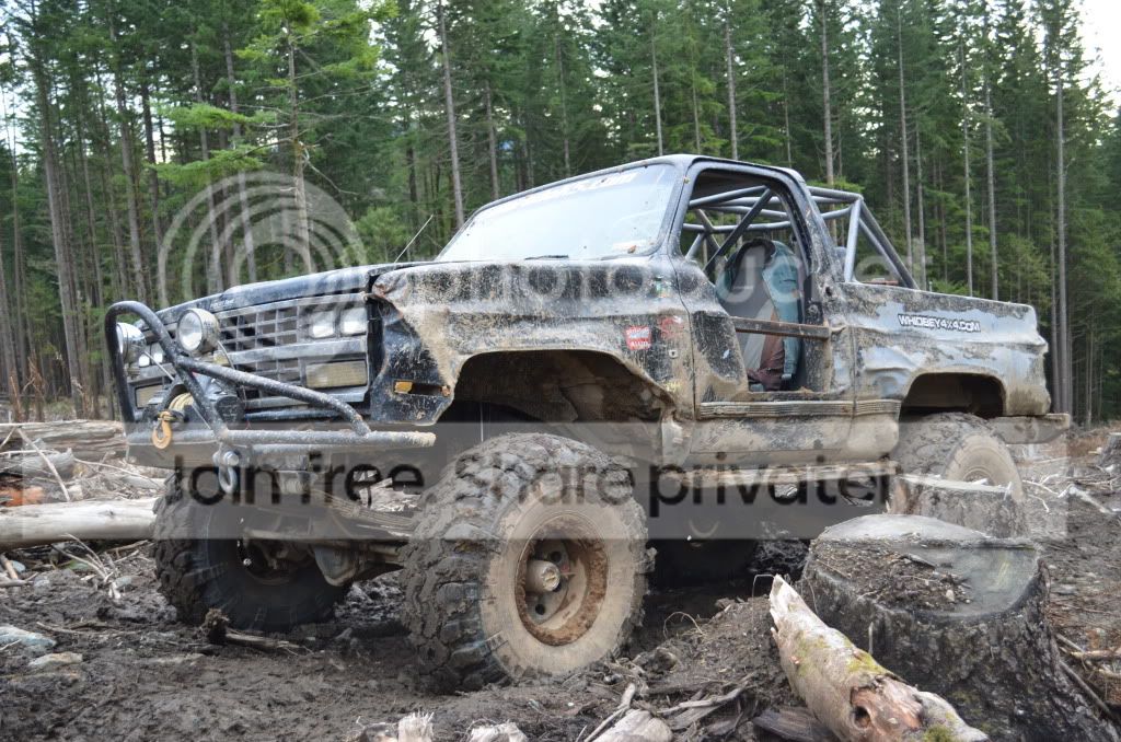

I know your body is beat, but I still cringed at the photo of you slammed between those two trees :eek1:

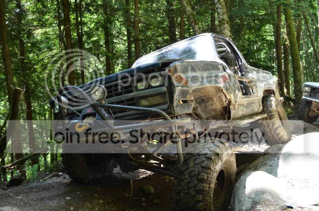

I barely even touch that tree on the pass side anymore lol.

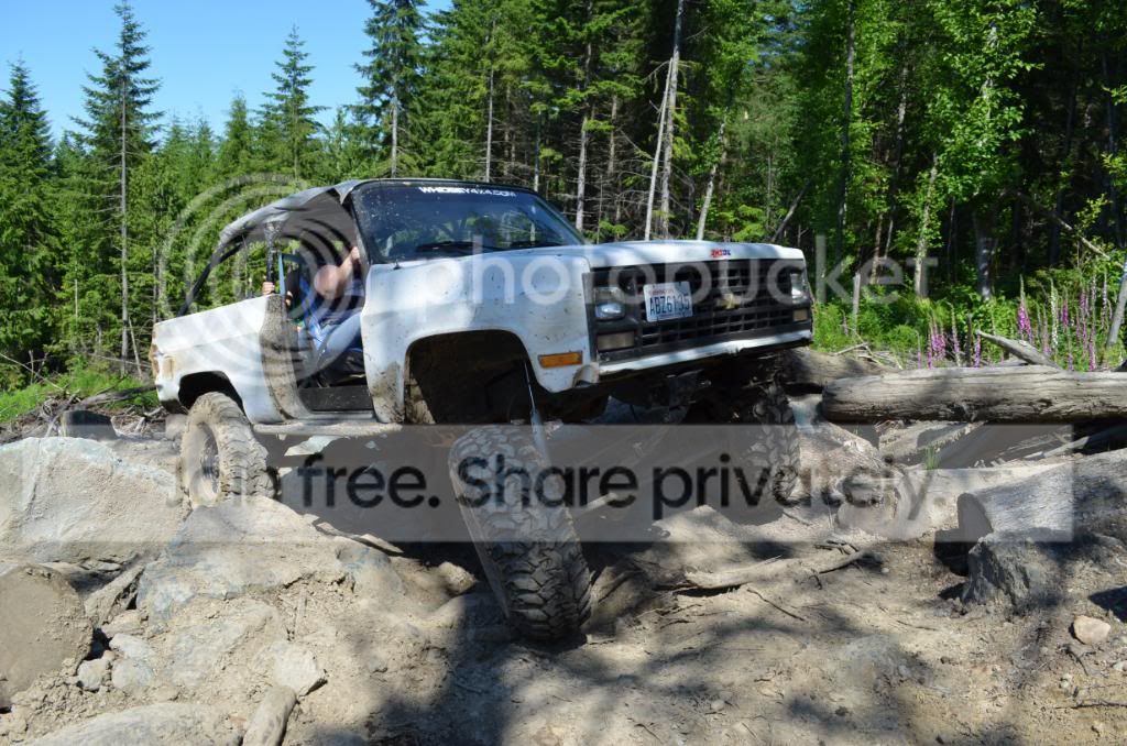

Those last couple pics on the rock I was on that tree against the pass bed side pretty hard. It actually smoothed out some dents.

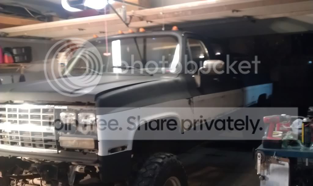

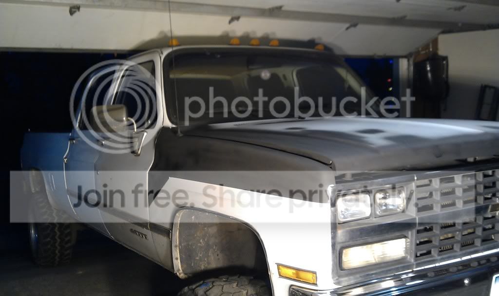

Going to be nice tomorrow so I just left the primer alone for tonight. I think I am going to go with a Black grey Black paint on the CC for now. Even if its just rattle can it will look better than the peeling white, or patchy repair job. The worst areas are sanded and primed. The cab has a few areas that need to be sanded as well.
So the paint on the Crew Cab has been deteriorating badly since I moved back to WA from Cali. Several spots were missing paint and with the moisture up here the primered areas began to rust.
The edges of the hood were the worst and then the areas of the cab behind the doors. Didnt get many before pictures.
I was originally just going to hit the bad spots and clean them up, primer them and hit them with some gloss white, but after I got the edges of the hood done in black taped off on the body line I really liked how it looked.
So I went and got more primer and some sanding discs. Off came the trim and I got to work.
Oh forgot to add when i was sanding the hardened 3M tape off from the original trim. This area didnt have metal like everywhere else. Its very thin, but wasn't too thrilled to see any filler on the truck. Looks like it just had a dent and somebody filled it. Probably why the box paint was in better shape. Its been resprayed at some point.
Anyway
I only finished the black the first night of painting. I think I had a full day of sanding and several hours of masking.
I kinda liked the black white black scheme, but I had bare metal everywhere the trim was on both sides. Already had the grey primer so I went with it.
No prep or masking pics of this step. It was Monday after work with rain pending so I just got it done. Little bit of a breeze and not quite enough patience and I got a little over spray on the black. No biggies as it will end up getting sanded and painted at some point here soon. The grey dried much darker than I thought it would. Now I know its just primer, but I really wanted to get an idea of what the truck would look like in a two tone scheme. Final colors are undecided, but it will be dark light dark similar to the primer.
Besides the overspray and some streakiness in the grey I really like how it turned out. Much more appealing than the all white. I was pretty set on never re doing the trim, but now I think it would look great with it in a dark color.

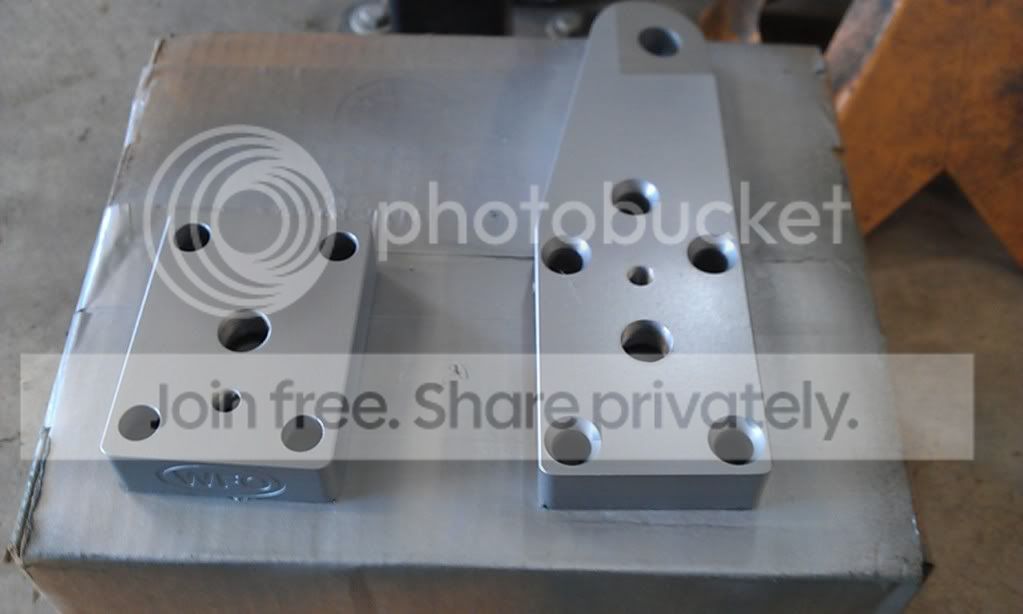

Got some WFO springless arms for the K5 and some of the Bronze Kingpin bushings for both trucks. Also got a pitman arm for the CC from WFO. Wow their shipping rocks! :bow: 2-3 days max for stuff to come in.

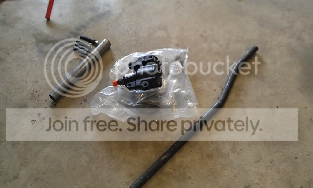

Gonna re-use my old draglink from the K5 that was a bit short and just use a longer DLE on one end.
Have a new 2wd box that I never used so that will go on the CC.
Gonna use my Sky arm from the K5 on the CC too. Also ordered an XJ shaft off ebay.

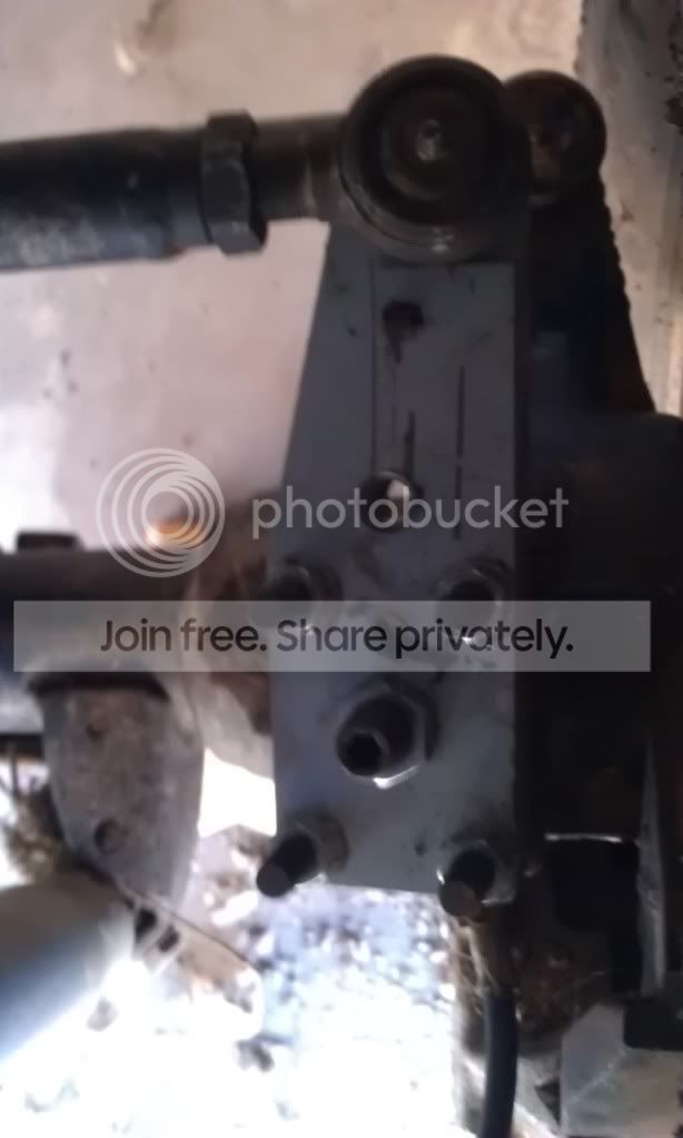

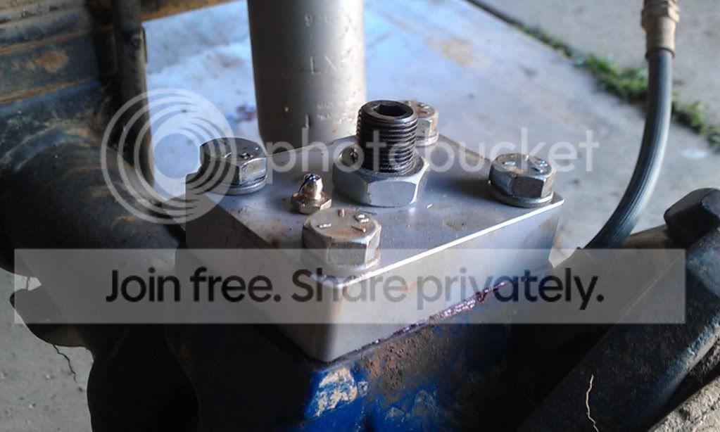

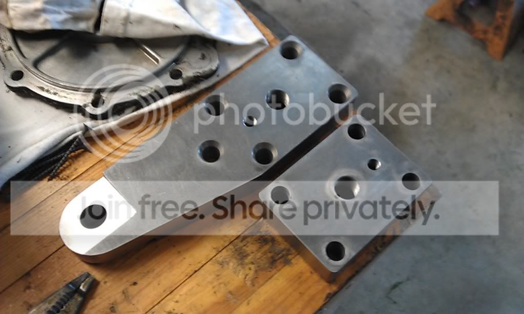

Going to have a go at building my own steering box brace too. Have a few old bushing sleeves I am going to weld up, some plat e and some tubing. Should be sufficient.
Few pics.

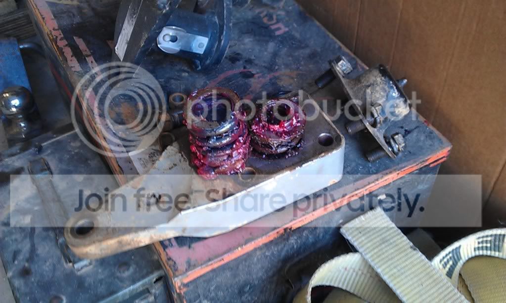

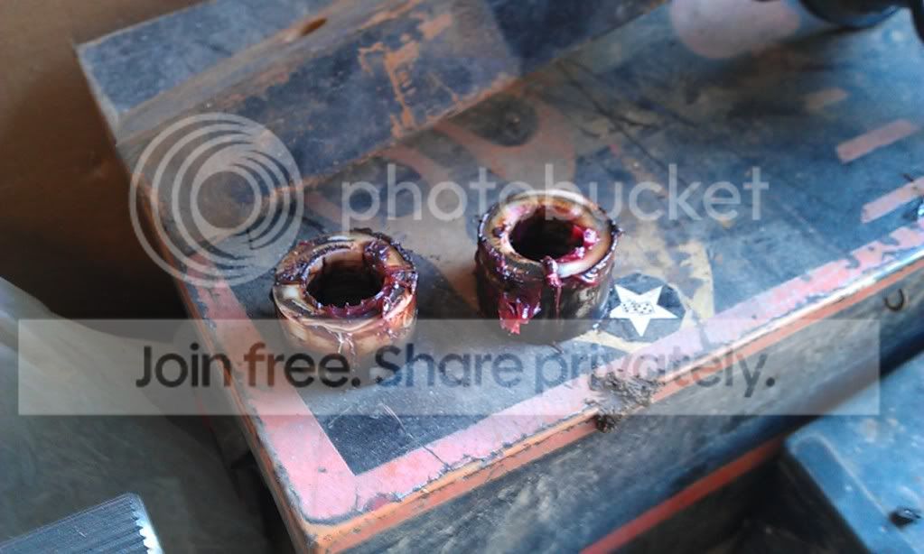

Got the new bushings and springless arms on the K5.
Bushings have been installed and abused for 3 years. I was surprised they are in one piece! :whistle:
Old arm for the Crew Cab.

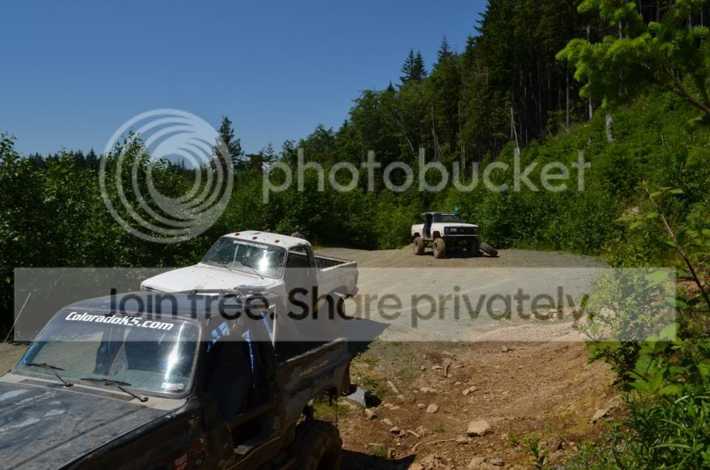

And a recent pic loaded up for a wheeling trip.
