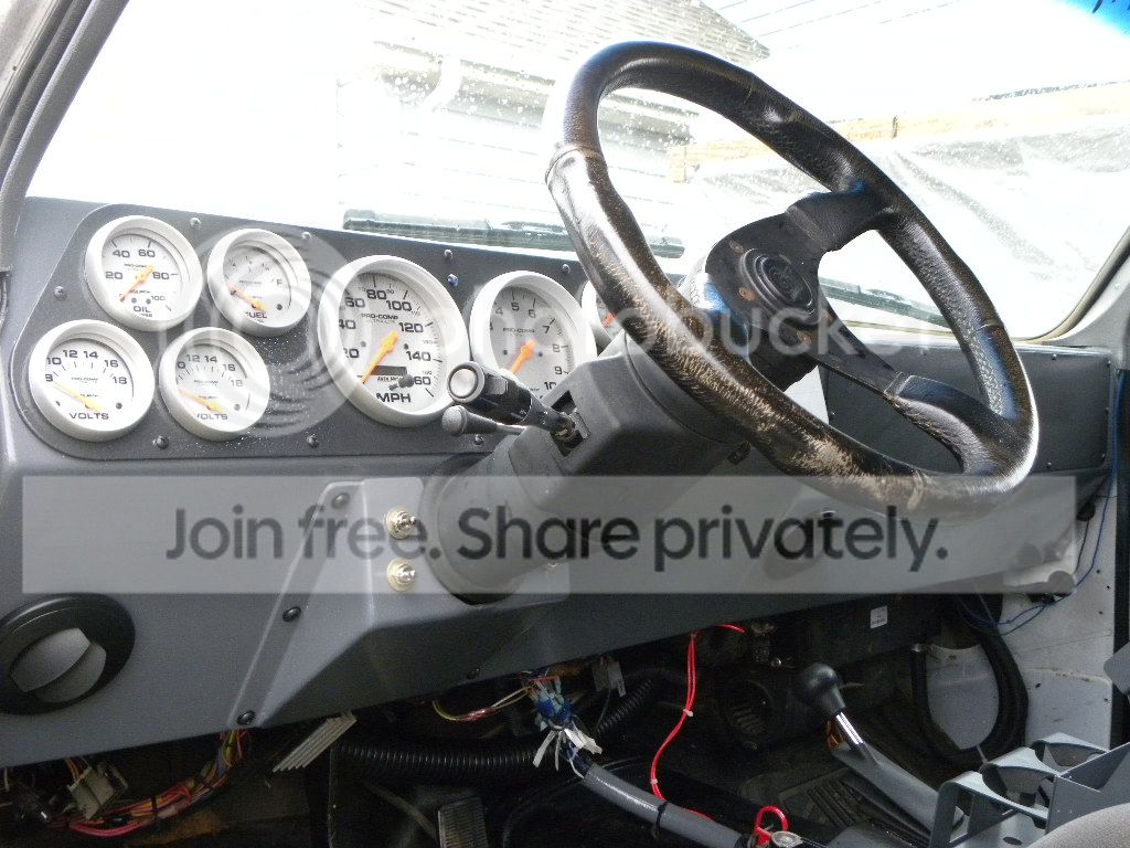

So what are your plans for the big gaping hole on the right side of the dash?
If your referencing the area next to where the gauge cluster is going, the only plans are for the heater control switch, at the moment. I would like to try and keep the dash as clean as possible.
Still have to figure out where Im going to put the heater ducts in there somewhere.

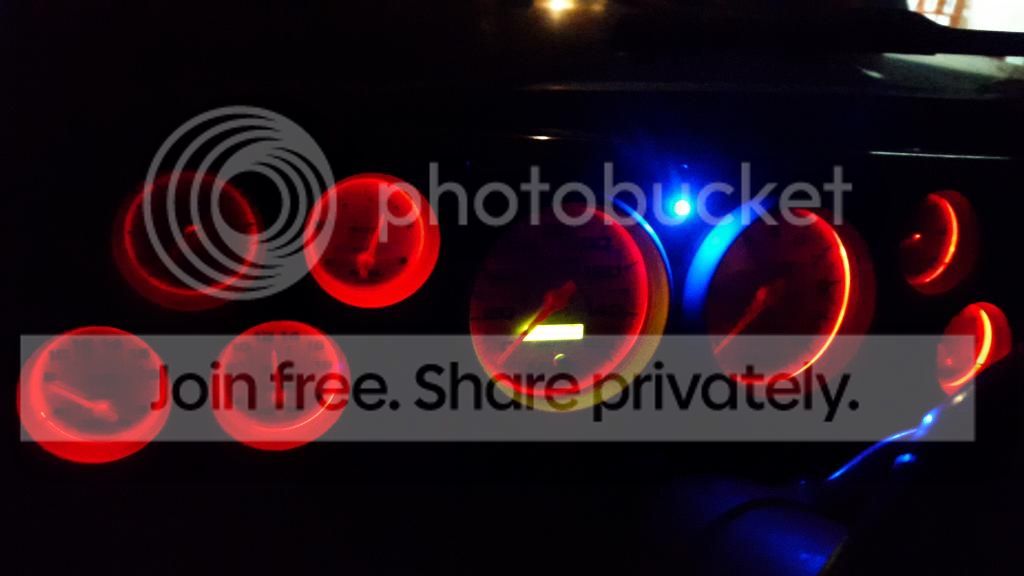

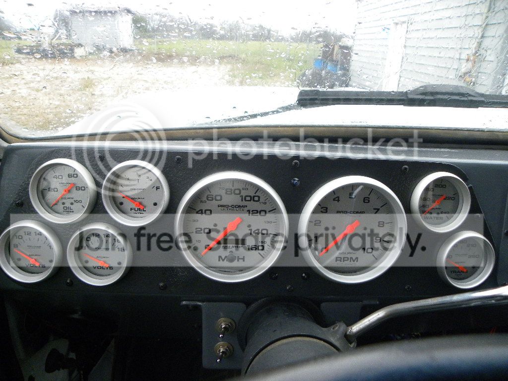

Finally got the gauges all wired up and working.
Where Kert offers the high beam LED, I opted to use it for the CEL light.
Tomorrow is LED high beams re-wired up, 12" light bar re-wired and heater control wired up.
Maybe I missed it, why do you have two volt gauges?
Looks nice btw.
yeah, I did that like 6, 7 yr's ago... it's like Dr Seuss, thing 1 and thing 2... :haha:
it only works well on certain dual bat setups, otherwise they just read the same... mine are setup on relays...
Relays was the way I was going to go.
Ahhhh, I see.:waytogo:
I went the easy way and just have a heavy battery cable between my batteries.

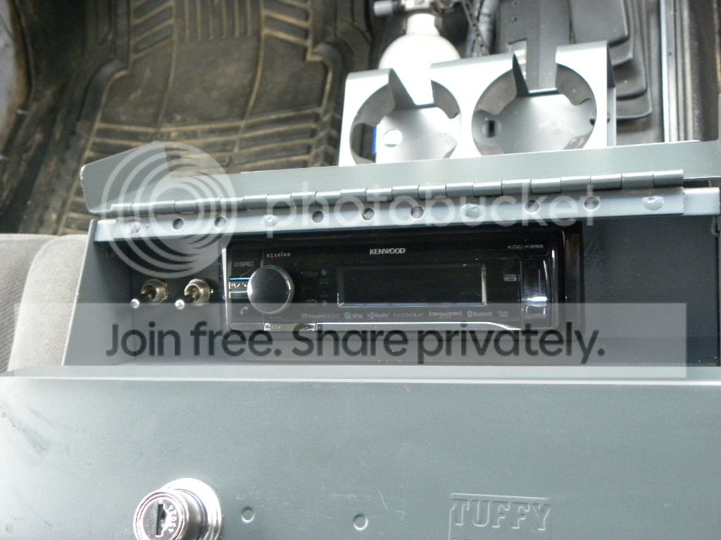

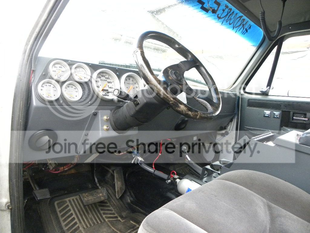

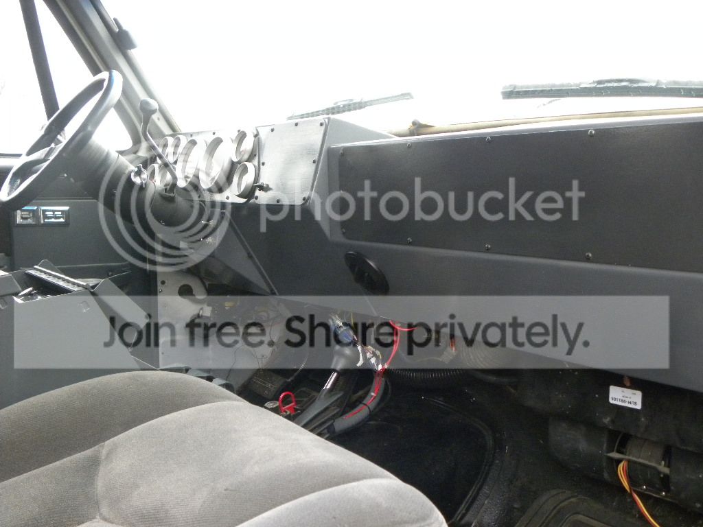

Im about 98% done with the dash install. Still have some minor wire tucking to do. Pics:
Blinkers are operational and the blue LED that Kert puts in for high beams, I used it for the CEL light.

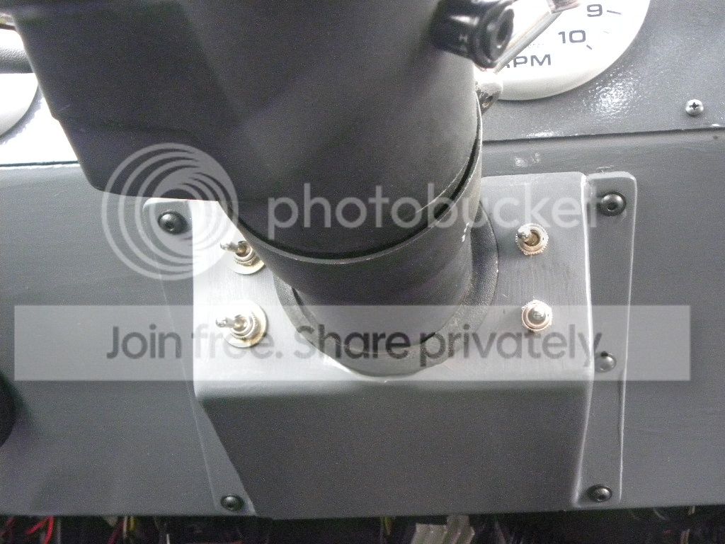

Left bottom toggle: Running lights
Left top toggle: Headlights
Right bottom toggle: Large E-fan (3-way toggle: Temp on, off, manual on)
Right top toggle: Small E=fan (3-way toggle: Same as large e-fan)
Left toggle: 4x6 LED high beams
Right toggle: Side Tracked 12" light bar
Put these here for easy access while driving. Now I don't have to reach forward to turn them off when a vehicle approaches.
