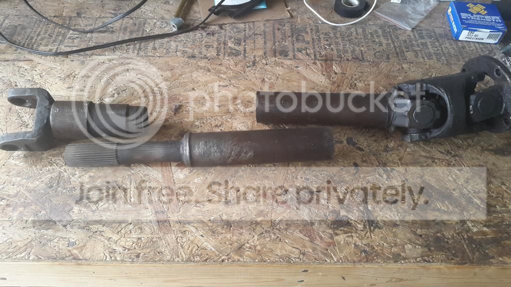

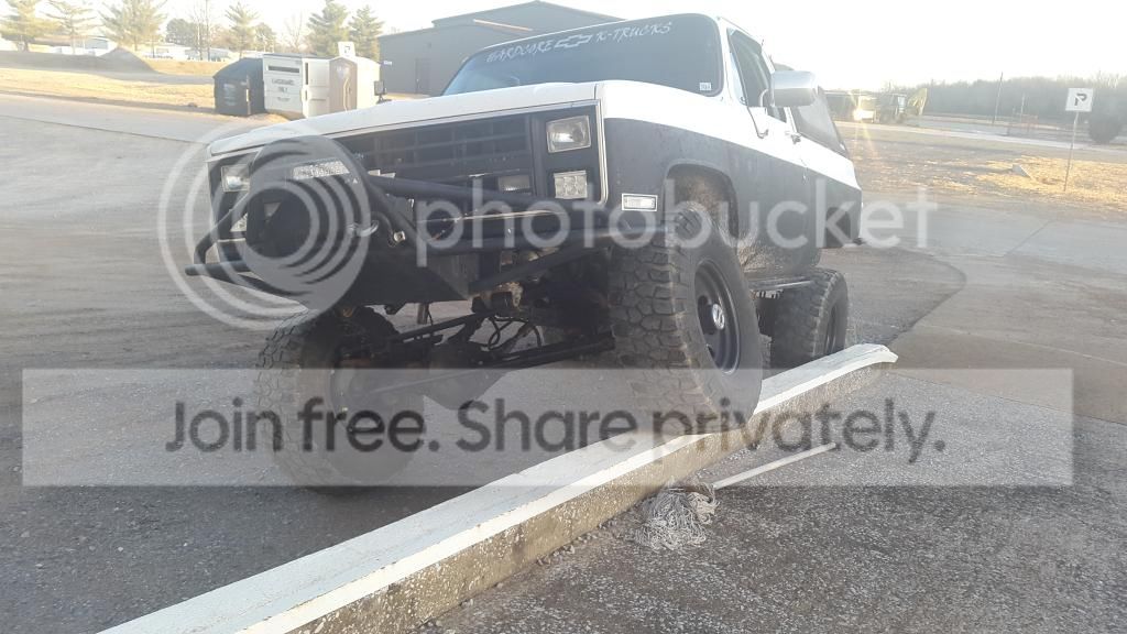

Im really digging them. I haven't had a chance to flex 'em out yet. Havent had a front drive shaft till today and its still short (stock length). I just picked up some round stock to sheath the thicker portion so I can make the front DS longer.

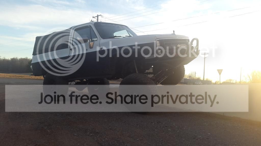

Of course with softer 6" lift springs, there is a bit more body sway around corners but for my taste, it really doesn't bother me. Its not like Im racing this rig around corners like my 300Z....lol. I tend to be on a leisure trip when I drive my K5.
Overall and so far I give it a Siskel and Ebert: :waytogo::waytogo:

Its no problem at all. I had them move the spring forward 1.5", hence front DS a bit short but still fits, and I did stay with stock length front springs. I wanted minimal change to install them but definitely wanted my tire out of the back edge of the fender when flexed. I still need to test that out, though.

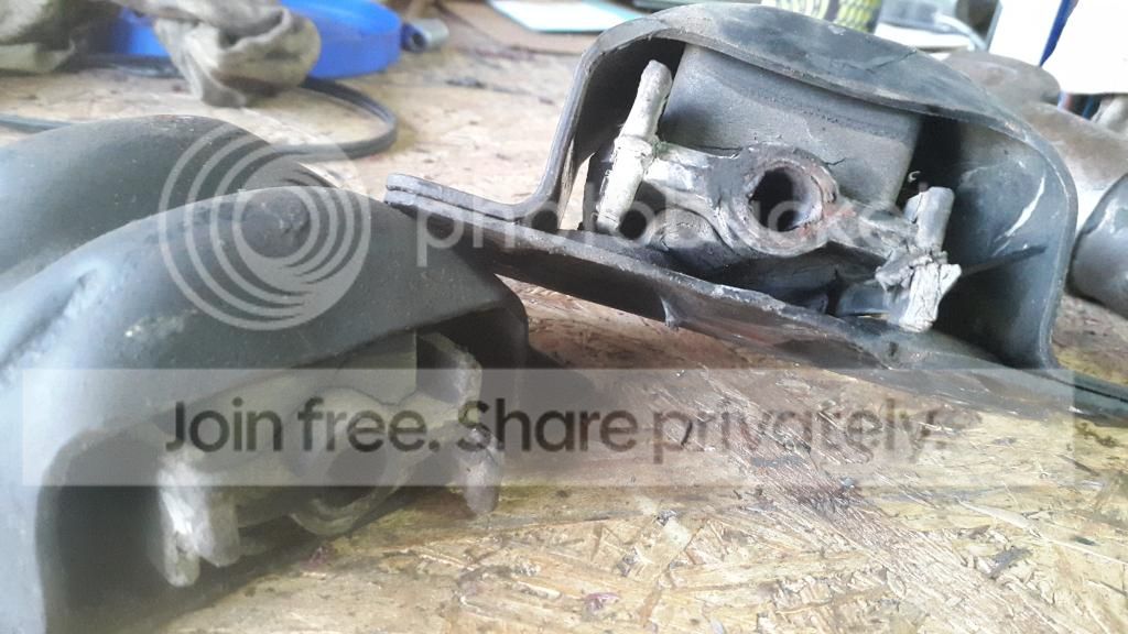

Today, I installed all new TREs and TNA motor mounts. I didn't get any installed pics of the motor mounts as the sun went down right when I was finishing up.
The old stock mounts were sloppy and rubber falling off.

Good investment on the motor mounts. I did the same type and it's a big improvement. I'll build or buy an engine crossmember soon. You've had a busy day too!

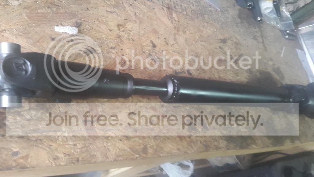

Got around to lengthening my front drive shaft today courtesy of Lincoln Electric and some round stock.
