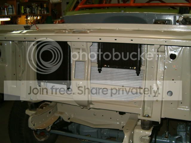

So your going to make plates to attach the rad to the hoop then?I am ditching the core support Dave.
Yes probably going to redo the shock mounts, do em like yours maybe.
Not sure yet, I have 40 feet to mess with. Main core support hoop will probably be 1.5, main structure will be 1.75.
I didn't plan on doing this but after looking at how much the radiator has been moving around on me it kind of scared me.
That and being able to move the winch control around a bit mount a grille and put some decent lights behind the grille I am putting in.
Horton looks alot more "finished" with a grille in there.
In addition the core support has been moving enough that most of my orginal welds when messing with the core support have cracked. So it would require taking it all out and redoing a bunch of welds. Mine as well bend tubing instead.
I was able to mount my coolers behind the latch support w/ some 1" square tubing. Just drilled a hole through the 1" and mounted w/ 1/4 bolts and locknuts.Dave I am not sure where I am going with it overall.
I will probably cut up the old core support to mount the radiator to. If the mount was more rigid then it wouldn't flex. I like the way the stock radiator mounts.
That is of course the initial plan, I also have a tranny cooler and power steering cooler to mount there. Will probably move the rad back an inch or so.
Just going to have to see once I get in there.
I am going to run fenders, probably the old trashed ones but I have some ones I can cut up and use if I feel like it but for now the old ones will do.
If I didn't have KOH to go to then I would put new fenders on it. Hood will stay, fenders will stay and the bedsides will stay.

Putting a GMC grille from an 89 single headlight. So it will just be solid grill all the way across, I have some different lights to put in too. Much better driving lights off a semi.
