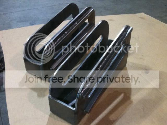

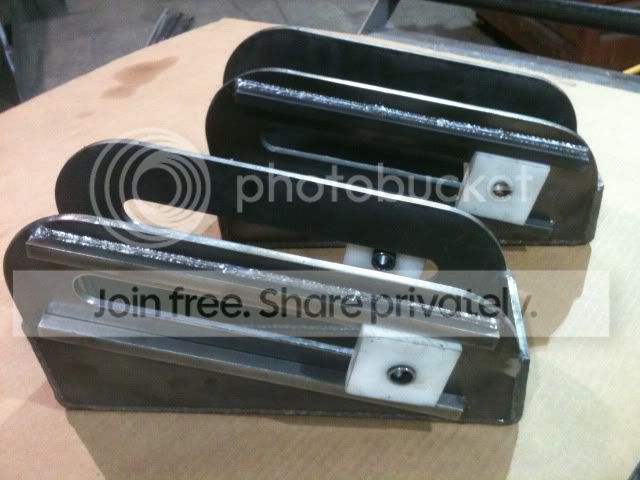

This is what I am talking about Heath, so yes you do elimnate one bushing. I would have to build this out of way beefier stuff than is seen here I would think though
If I linked with leaves then yes you would have to make both ends so they could move.
As far as the twisting that occurs with leaf springs I have thought about some type of swivel or something to help relieve that but that gets into the realm of who knows type of stuff, built right it could make the truck preform very well built wrong it will make it less stable and unpredictable
I need to discuss stuff like this sometimes because the more I think about it the more I think that coils or coil overs is my answer for the back too
That's kind of what I imagined, but I think that will end up getting sloppy pretty quick and start rattling. I think the side bushings that slides should be square, they can't roll anyway or they would rattle if both sides(upper and lower) aren't in constant contact, and a square one would have a larger bearing surface for less wear. Not to mention more self cleaning. Also, when it does wear you can't just change a bushing, because the entire mount becomes a wear point now. Unless you made the square bushing out of bronze or something so it wears instead of the steel. Plus I think that sand and crud will get in there and wear it prematurely. It's a lot more open to that than a bushing.
Have you ever seen that in use in a 4x4? As the axle articulates the leaves have to get closer together, I think the shackle allows a lot of that(more so than the bushings themselves). You eliminate the shackle and you will create more bind, or the spring has to flex sideways, which it won't want to and that would be hard on stuff.
I am tire of my leaves. There is only one reason I would want leaves to build something custom like you are, space constraints. If you have the space, ditch 'em. That's my vote.

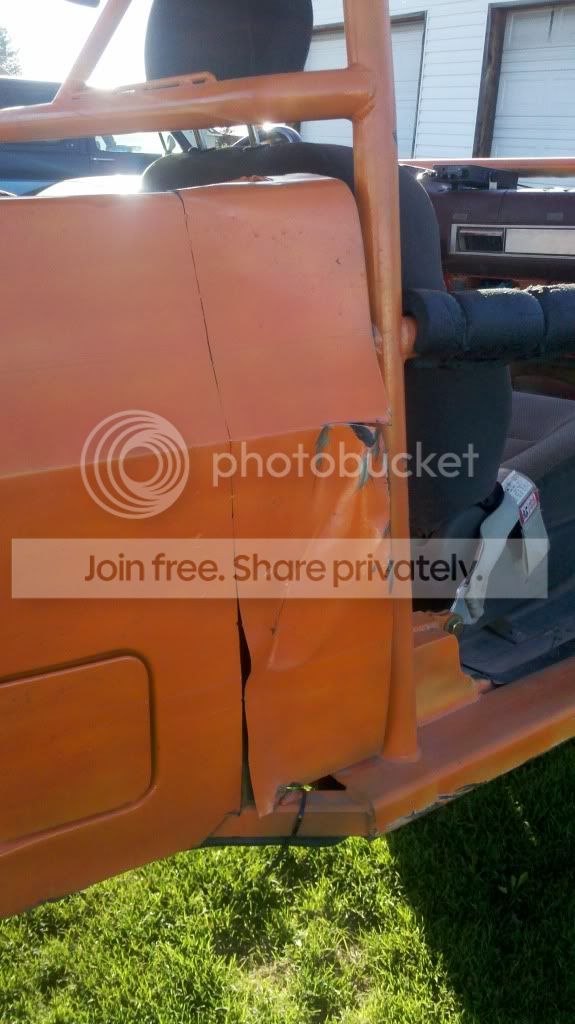

Hey Eric do you ever catch the bedsides on anything?

umm not often
:D:D
I am quite a bit narrower than a stock truck is right there but if you wanna keep sheetmetal your gonna dent it eventually. I hope to get this fixed because they really are out of the way quite alot
