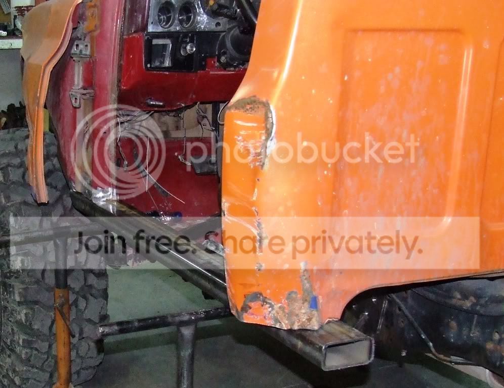

Actually not very long with the bedsides on, you see to get them on there so they looked nice and lined up it kind of made them very vulnerable to rocks.
They caught on a couple rocks and I nearly destroyed them. I think the bedsides make the look of the truck really so I removed them entirely and went like this for a while

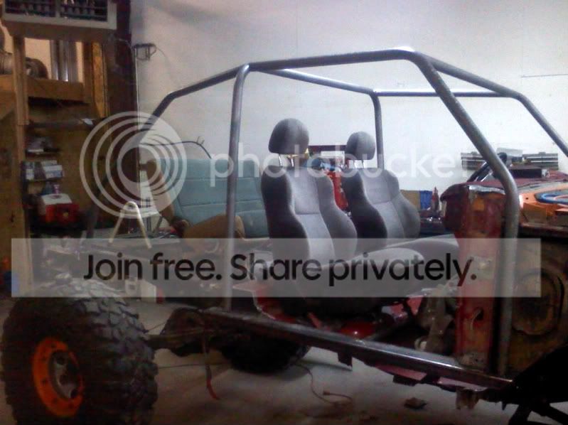

Well a deal fell through and we ended up with 8 sticks of DOM 1.75 tube. My partner kept on talking about cutting his current cage off and using the DOM to rebuild it. Since he already had a cage and I did not I decided to do something drastic
My wife at the time was pregenant with our second child, so a cab truck was not going to work anymore. I needed a back seat. The only way to do that was to swap everything into a blazer I had or realize some of my goals with Horton and make him a bit skinnier.

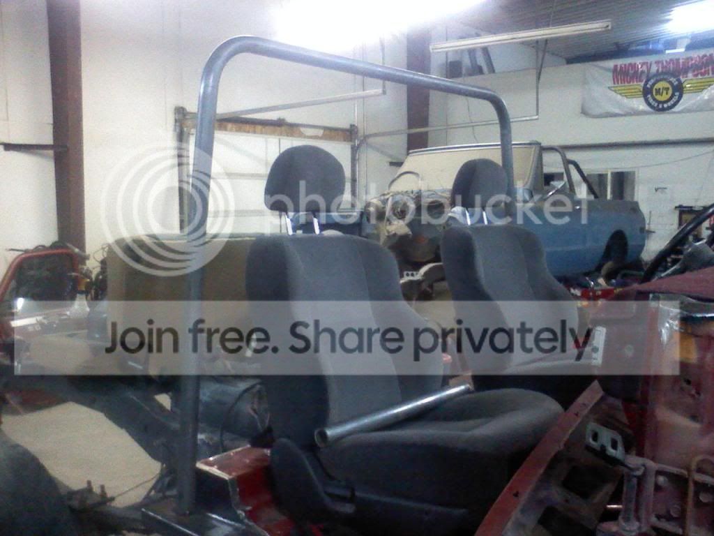

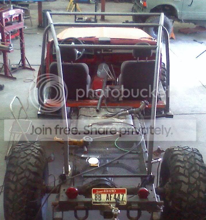

So the cage building started.
I started by cleaning up some of the edges done by the boatsides, in this build I consider the boatsides an integral part of the cage build
I put fishplates on the frame where the boatside braces mount to the frame to make them as strong as possible but to keep it as light as possible

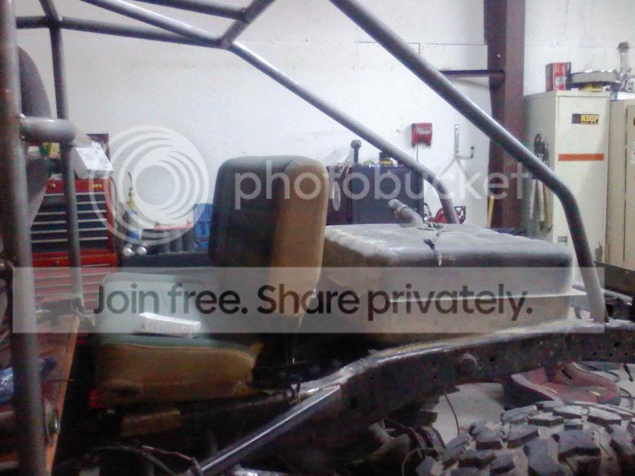

I found some seats from a Grand Cherokee for free and a TJ back seat and started bending tube

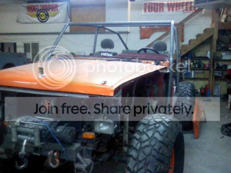

New battery mounting tray
And pretty much the finished product which is Hortons current state
At this point I decided to put the bedsides back on because without them the truck was just ugly. Simple fact of life, the bedsides made it look like a Chevy still and I really like that. I had also made them over a foot narrower where they mount so the chance of hitting them was greatly reduced
