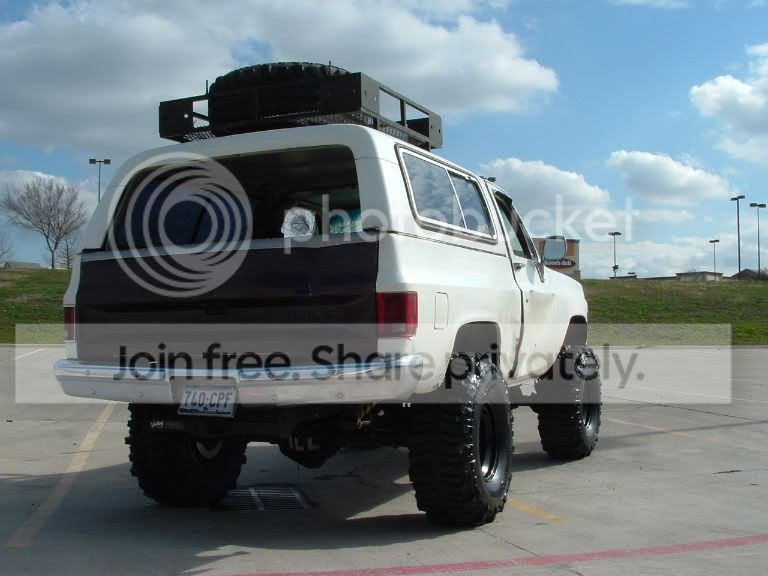

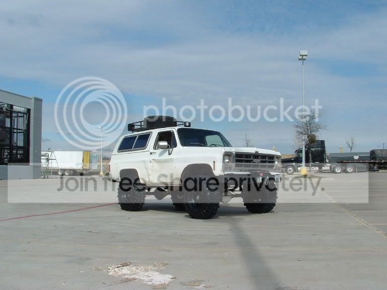

1987 K5 Blazer with Silverado package. I bought it stock a little over a year ago and have put on a 12" Superlift kit, 39.5/15/15 Super Swamper TrXus STS's mounted on 15x10 Eagle 589's, dual shocks all the way around (including dual stabilizers), and a custom bent exhaust with a 2.5" Y-pipe converging into a 3" high-flow cat and a Flowmaster Super 40 dumping after the rear axle through two 2.5" outlets (sounds AMAZING :D). I'm workin' with the income of a 16 year old still in high school doing all the work, so I have yet to do the necessary (with this much tire IMO) crossover steering and 4.88 (or 5.13) gears. I've got some chrome diff covers I have yet to install, but I'm going to wait until I buy some diff guards from purplecranium.com. It's my daily driver, so don't make fun of my 10 bolts :o.
In the background is a burgundy '79 K10 that will become my future 'wheeler project once I get some surplus funds. It'll recieve 1-ton's, a 5" lift (springs in front, shackle flip in rear, zero-rates), 38's on beadlocks, and a nasty small block. All in due time...

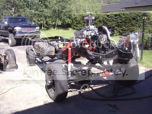

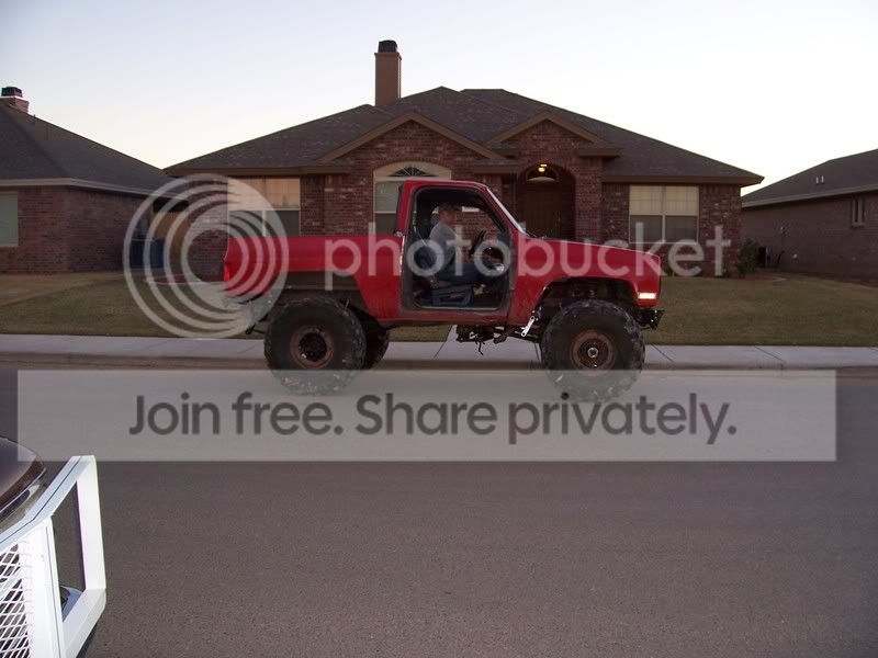

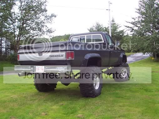

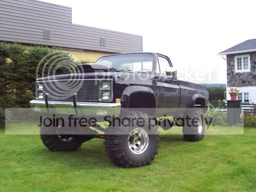

1981 Chevy C10 long box body on shortened 78 3+3 GMC k35 frame and axles. Power windows, locks, and A/C.
Engine, Trans, and T-Case:
-350 4 bolt main, comp cams cam shaft, Edelbrock endura shine EPS intake manifold, 1” carb spacer, 670 Holley Truck Avenger Carb, Head Man ceramic
coated full length headers, dual 2 ½” exhaust with Race Ready cut outs, electric fan, Accell distributor, coil, and wires.
-SM465 with hydraulic clutch

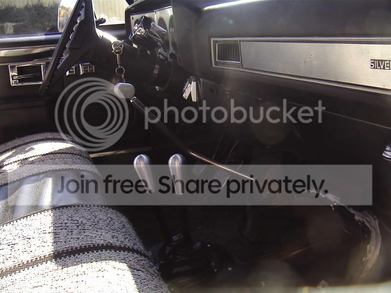

-NP205 with ORD twin stick kit, and High Angle Driveline 1350 c/v flange
-Drive shafts are 1350 c/v rear and 1310 soon to be 1350 front
Front Axle
- Dana 60 with 4.56's, lincoln locker, 35 spline stub shafts, Warn Premium manual hubs, ORD crossover steering, and dual steering stabiliser’s. Total 10”of lift.
Rear Axle
- 14 Bolt FF with 4.56’s, Detroit, and wide 1 tone drums. Soon to be disks.
Suspension total 10”of lift
Front
-Custom front spring hangers and shackles and 6” BDS springs
Rear
- Home brew shackle flip and 52” Superlift 8” leaf springs, soon to be 56” 6” lift Tuff Country springs with 2” block.
Wheels and Tires
-39.5/18/16.5 Boggers on 16.5x12 Mickey Thompson Classic 2’s
Just got done and tested it out tonight.
