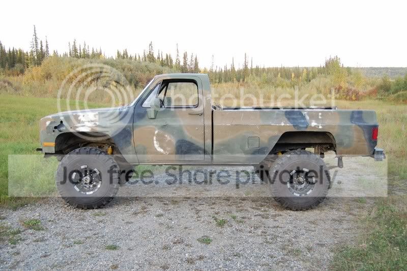

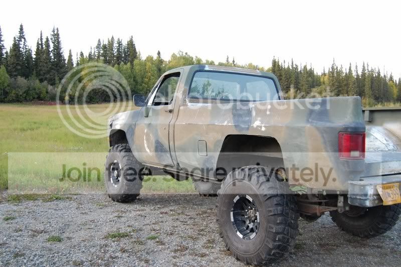

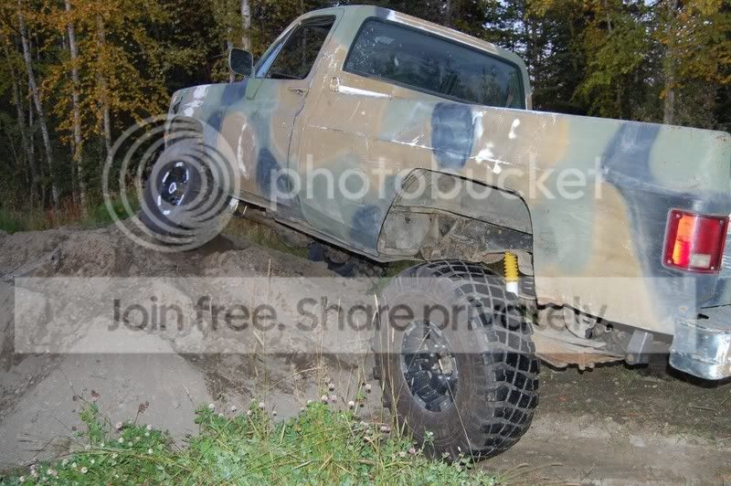

1985 M1028 CUCV
Front - 5-1/2" Superlift springs
Rear - ORD 4" shackle flip with 6" HD shackles for 5-1/2" lift
325/85R16 Michelin XML (39"x13") tires
Tires rubbed while turning and stuffed the fender back when trying to flex, so I did a little trimming. Trimmed just enough to keep the inner fenders. Following some advice from here, I made a pattern from the front and cut the same on the rear. When using the body line as a guide, this made the wheelwells the same height front and rear. No rubbing now.

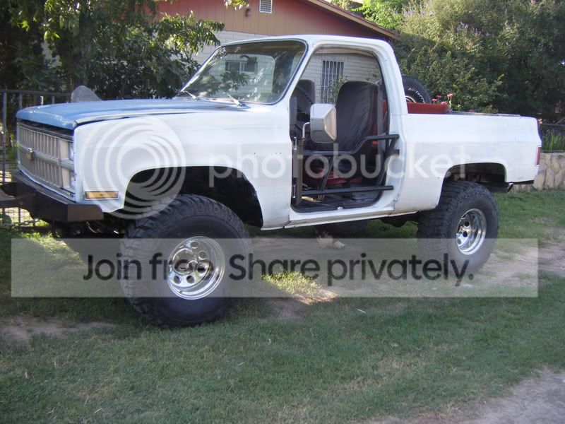

a couple pics with the 44's on.. the fronts are 8" 52's (which are going to get replaced), the rear is a diy4x shackle flip with 4" reversed 56's and a 1.5" zero rate.. acouple mods to the rear are in the works as well..
truck looks great man! looks like the rear sags a little, but love the stance:bow:

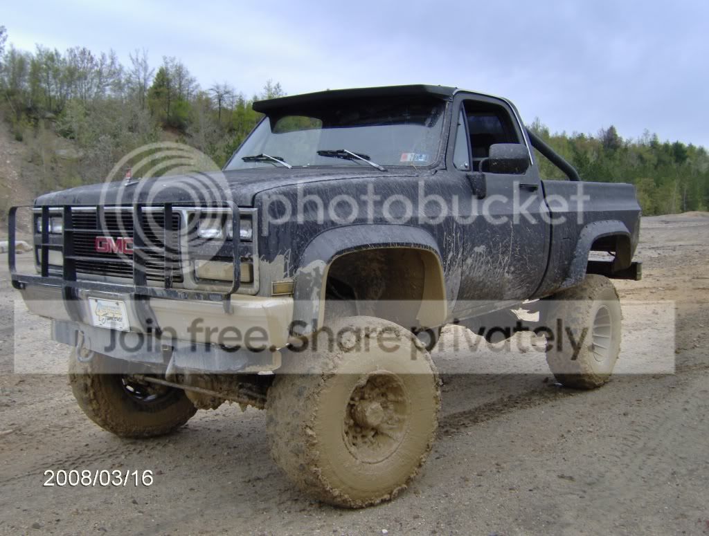

83 chevrolet, 91 sub front clip, 3 inch body lift, 8inch superlift , d60,14blt, 37 12.5 16.5s tsl.
