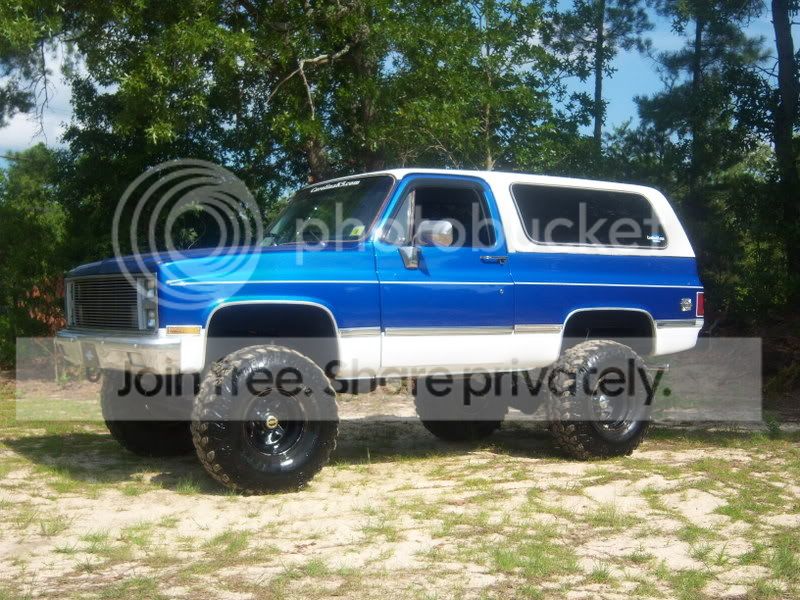

How will my K5/truck look with xx" tires on xx" of lift?
Dude that thing is Sexy.
Just put em on cause I got a set of 36's coming and didnt have anything else to put on so they guy can take the 35's with him.
yep all spring Rough Country,I actually got about 5" out of it but I suspect the springs will sag a lil over time.It only got about 100 miles on it.
I know from experience that Mickey's run small... like waaay small... what do those actually measure out to?

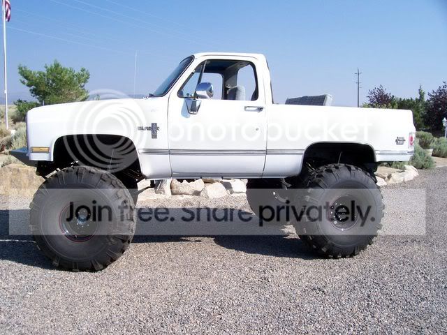

87 k5, 3" body lift, 1 tons, diy4x shackle flip w/ 7" shackles, add a leafs and zero rates, 6" ruff country springs up front with 6" shackles and zero rates, sitting on 19.5/44.15 boggers mounted on 15x14 procomp series wheels with 2.75" bs. trimming still needed. whoring time..
a couple pics with the 44's on.. the fronts are 8" 52's (which are going to get replaced), the rear is a diy4x shackle flip with 4" reversed 56's and a 1.5" zero rate.. acouple mods to the rear are in the works as well..
