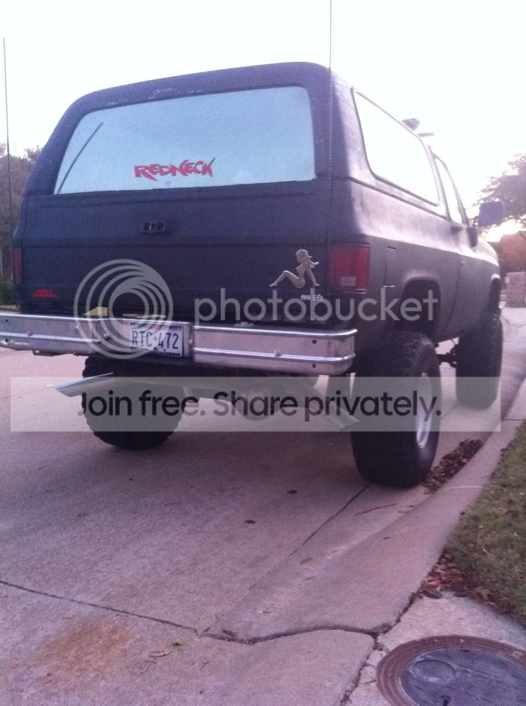

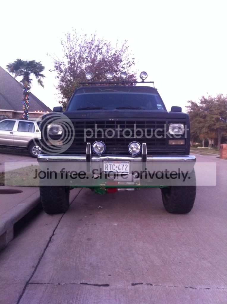

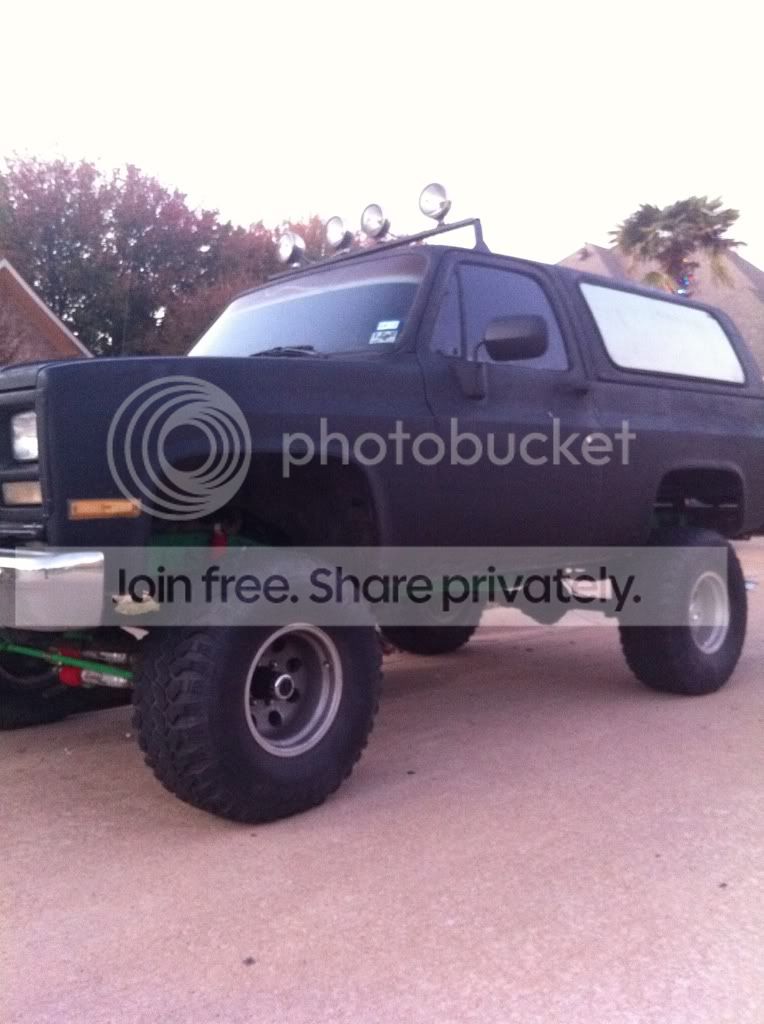

No way man! I'm rollin on 2.5" and 35's dood! I put a pic in back there somewhere...I think it's about time for some kind of lift...

Really nice truck man. Whats your gear ratio?

Cool looking truck! I like the stance.
