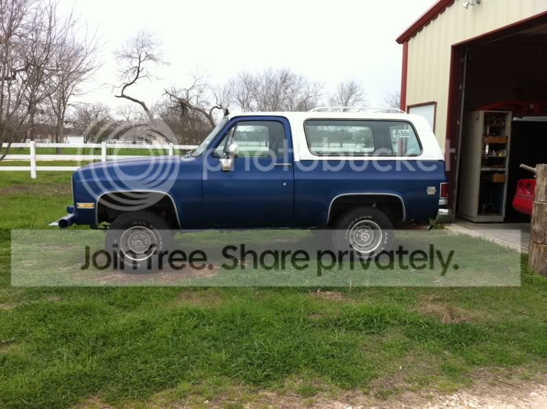

i think the tires are 31.5" but i'm not sure. If anyone could eyeball and tell me if my truck has any lift i'd appreciate it.
I'm gonna say stock as well. Easiest way to tell is if the front springs are negatively arched, it's stock.
Look like a stocker. Check the front springs for the negative arch and rear springs for blocks and longer u-bolts.

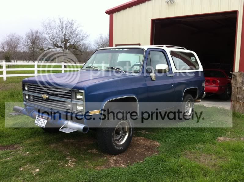

I see evidence of a front "add a leaf" on the front springs. Most likely to support whatever goes into the 2 square tubes on that front bumper.

are add-a-leaf kits like lift kits? stiffen up the suspension? is it just me or does my front end look a little higher than the rear?
I agree that it looks higher in the front. You could check by measuring your rocker to ground clearance on flat concrete at the rear of the front wheel well and at the front of the rear wheel well.
the 2nd and 3rd (or 3rd and 4th, i'm not sure what the convention is for the sm465) are out. i have not driven the truck faster than 10 mph yet so i'm not sure how it rides. can you see the helper spring because of that gap?
