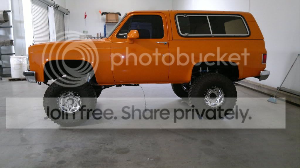

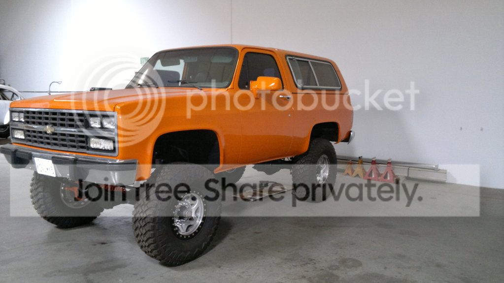

How will my K5/truck look with xx" tires on xx" of lift?
Front:
4" Tuff Country springs
ORD zero rates
Axle moved forward 1"
Dana 44
Rear:
DIY4X Shackle flip
ORD zero rates
Axle moved backwards 1"
14 Bolt Full Floater
36" TSL SX Swampers
No trimming yet.
:bow: That's one heck of a nice truck! Seeing yours make me think I own piles of junk. Heck, even your tire pile is much cooler than mine :thumb:
Daaaammmmmnnnnn!!!!! more pics....
Have a build thread?
no build thread yet i bought the truck 2 month ago i added the 6" pro comp lift ,wheels and tires,
front axle:reid racing knucles new bearing,rotors and reman calipers,cross over steering and high steer arms,psc steer box and hubs converted to 8 lug..
Rear axle:14bff ,rear disk brake conversion with E brake and new bearing,1330 to 1350 u joint conversion..
Working on front and rear tube bumpers,rebuilding king 2.0 shocks, regear to 4:56 and truss front axle with 2" chromoly tube and plate then i can move on to motor and trans and some interior
Wow that things so clean i thought for a second it was a dicast model, till i saw the broom lol
