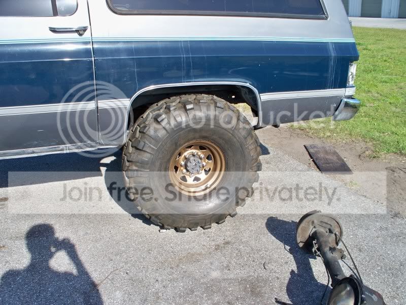

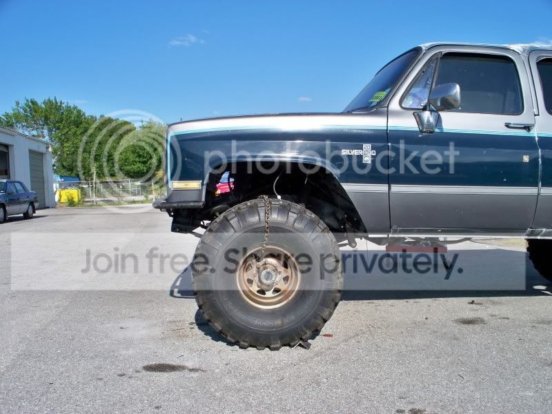

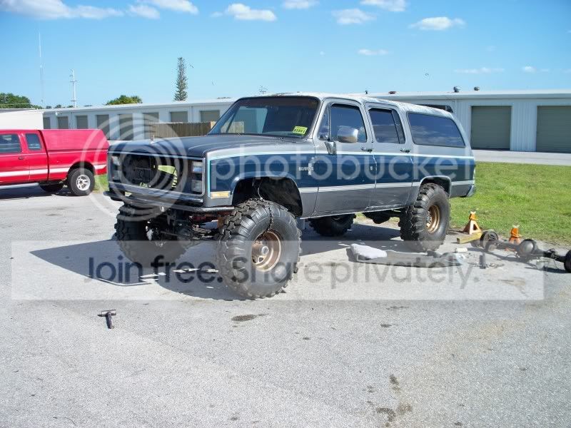

I cut one side of the fenders out in the front
I'll leave the stock back for now, I'll leave the wheel position pretty much the same also. I'll just trim the front of the fender. And then I'll redrill the perch to move the axle back about an inch

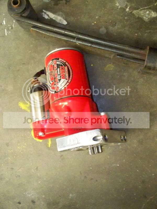

And my fancy starter

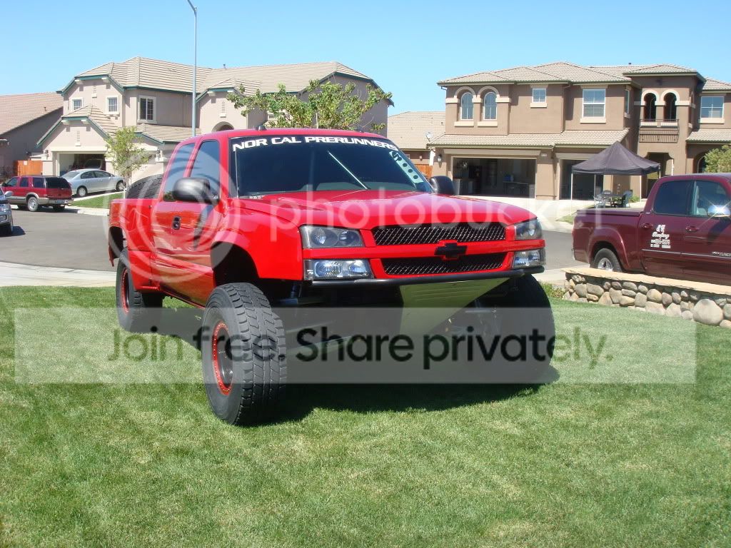

I'm going just going to the standard pre runner bumper up front

I got the the accessory's and belts on today at least. Tomorrow I'll find or get some starter bolts and mount the starter. Might even be able to start it this weekend. I get the axle this weekend also

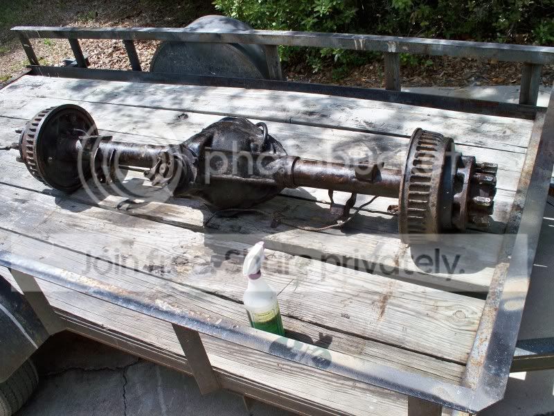

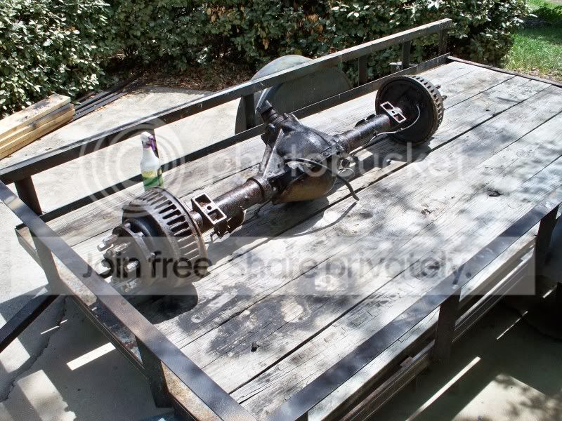

Got a 14 bolt
Now I just need to shave it, and paint it, and it already has welded spider gears so that saves some time.
Yesterday I got the starter on, the new hooker headers on, and had my dad do the wiring since he went from a tbi to carb on his truck recently.

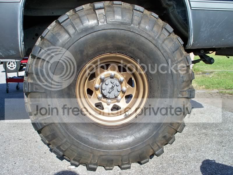

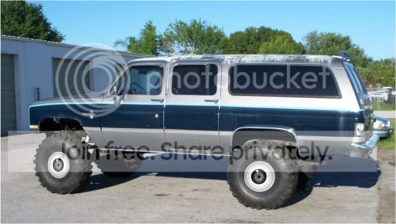

And I put some "stickers" from photobucket over the wheels
Looks kind of cool
I still haven't found any springs. I'm trying to trade 8" lift 52's for 56"s right now.
Anyways I picked up dodge springs today, 28" from the front to the the center, and 32" front center to the back. They should be perfect length...hopefully
My other set of 15" 8 lug wheels should come soon and then I'll my axle and springs in.

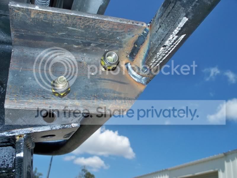

My bumper is pretty much done, just have to notch some ends and weld it. I got a hang of the pipe bender and it bends pretty decently compared to the pro tools 105 bender I've made a cage with before.
I'm going to drop the front a bit and raise the rear. I'll get some pieces cut so I can build some new longer shackles, my angle is kind of ****ty at the moment.
I'm not really sure what I want to do with the bumper either, either a stinger and the two supports or a pre runner type of skid plate.

And here is what I'm thinking on the bumper

It's 1.5" pipe from Lowes, the bender works ok after you get the die polished
