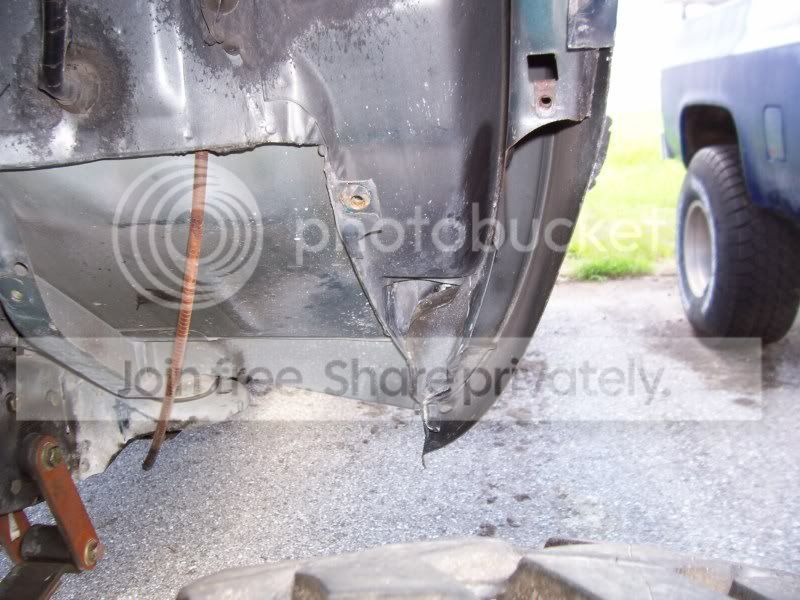

I was always wondering how to cut them before I did them, you can never really find any good pics of it on the inside. It's pretty easy though with a body saw

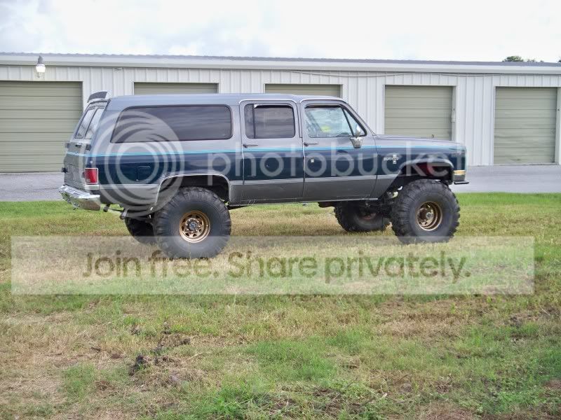

It has death wobble, and no shocks, the ride was bouncy to say the least.
Also why does my truck lean over so far when I turn? I have a spool
I need to paint the front wheels with a white base like the back before spraying the bronze to brighten them up a bit also
I would think the shocks will take care of the lean....
I think the front of that truck has a better stance/proportions than the back...
Thanks, I'm hoping the shocks and hydro assist fix both problems, The ride should be amazing with the soft springs.
The rear is a little low I think a zero rate should fix it. The fenders need to be trimmed a bit also
I would think the soft springs and lack of shocks would be the reason for gangsta lean around corners.

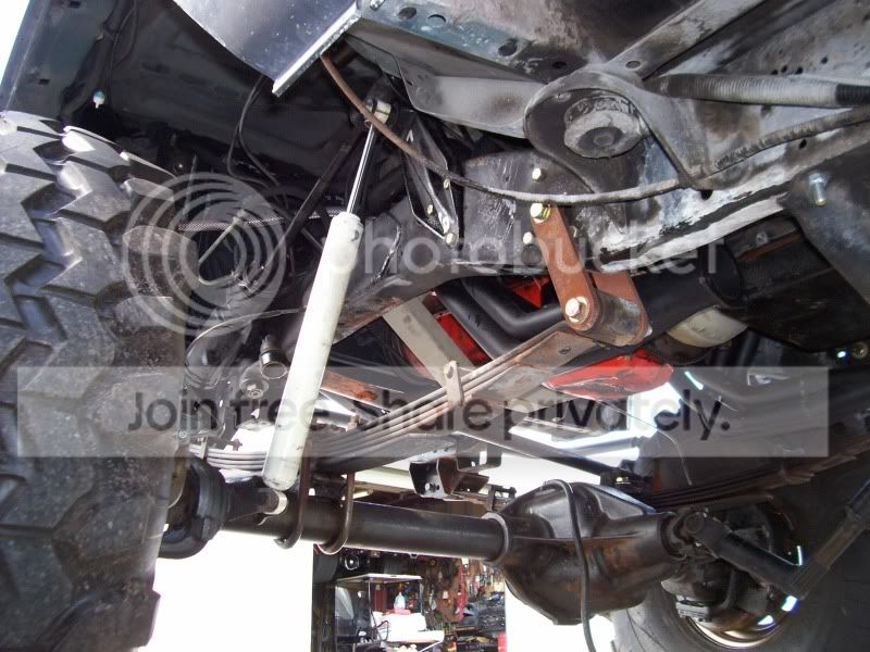

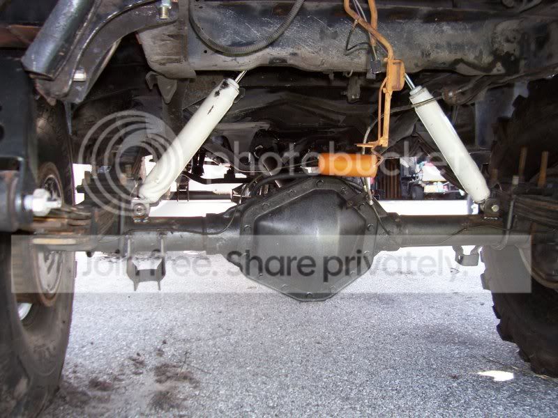

I'm going to do inboarded rear shocks tomorrow
Hopefully the 4" lift edelbrocks that cost like 5 bucks are long enough, I think it's something like 8" travel
I'm bidding on some 2000 f250 shock mounts so hopefully I can win those and get some 15" cheapo shocks on

The last springs I ran under my old K5 were Alcan's. 6" fronts and 2.5" rears with a shackle flip. They were very soft, and in a turn the whole truck would lean over like a linked up monster truck. It was terrible...and I was running Bilstein 5150's.
Shocks aren't gonna help the lean...only stiffening up the spring packs is gonna do that. The best place to add some spring rate is up front. It helps keep the truck stable, helps keep the driveshaft from pulling apart, and keeps the front tires out of the sheetmetal better. Soft springs are also not only soft up and down, but laterally weaker/softer too. I guarantee that's contributing to your death wobble right now.
If I had kept my K5 I was gonna ditch the 'slinky' springs for Tuff Country HD's up front and some 56's in the rear minus the overload. Would have killed the deathwobble too.
Just my 2 cents on super soft springs. Easily the worst thing I ever wasted time and money on in the 12 years I had my K5.

I just remembered that I didn't even tighten the side in the front with the two bolts and one u bolt, I bet that is why it was doing it :doah:
Hopefully the soft springs aren't too bad, I don't really have much of an option on the front, because I welded the hangers on. I could always 4 link down the road
It's not really like a body roll lean though, the truck like binds up and squats down a ton even if I'm turning really slow.
Yeah I guess the soft springs make it more noticeable

They 20" overall length, kinda short but cheaper

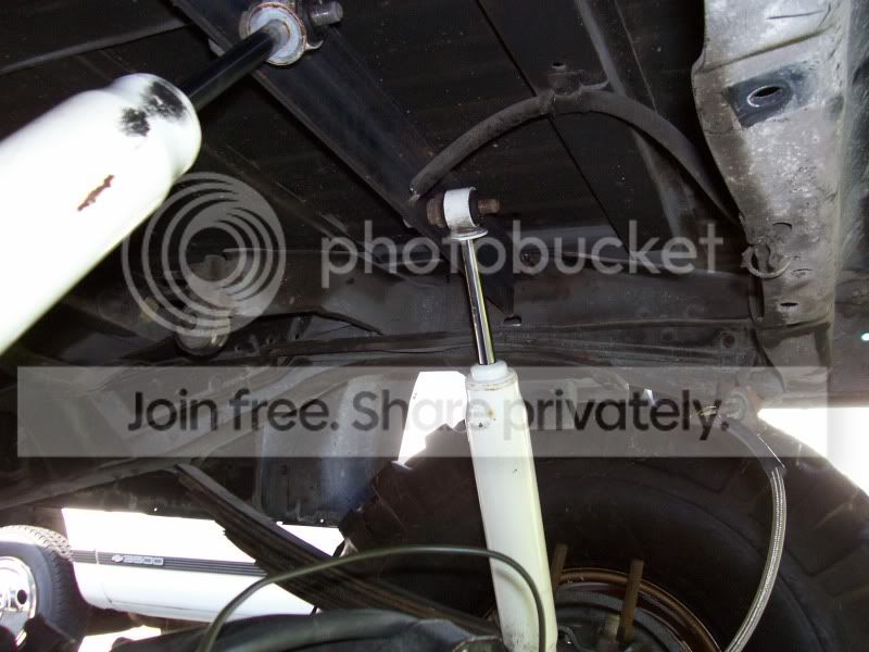

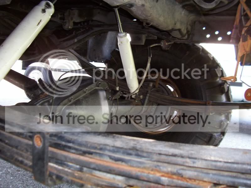

Inboarded shocks, didn't help with lean. I tried my edelbrock 4" lift shocks but they aren't long enough, 6" would probably work great , but I don't have any
The front shocks aren't in yet though, my f250 towers should be here in the next few days
Inboarding the shocks was really easy, the hardest part was scrapping the undercoat of the frame rail

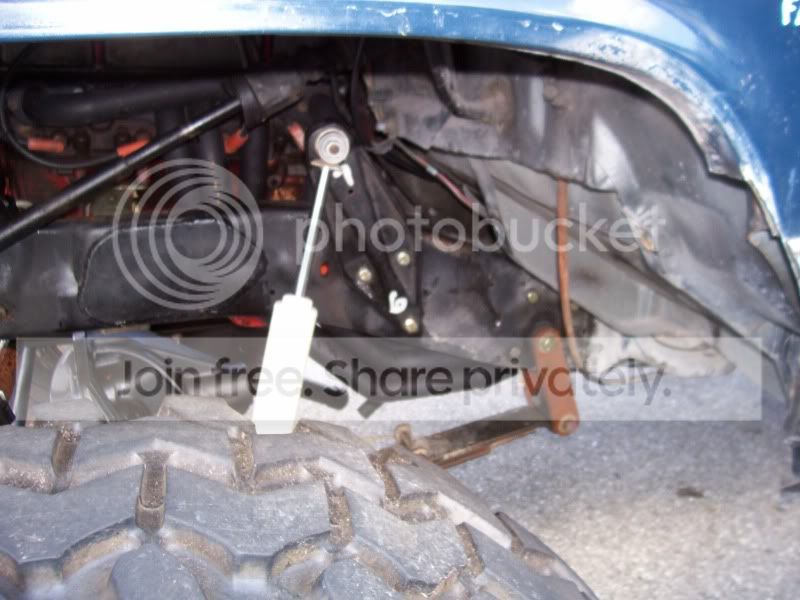

Mounted one front shock, it's was like 95* out so I didn't feel like doing the other side
And I took pictures of the inner fender for fabrimcator21
