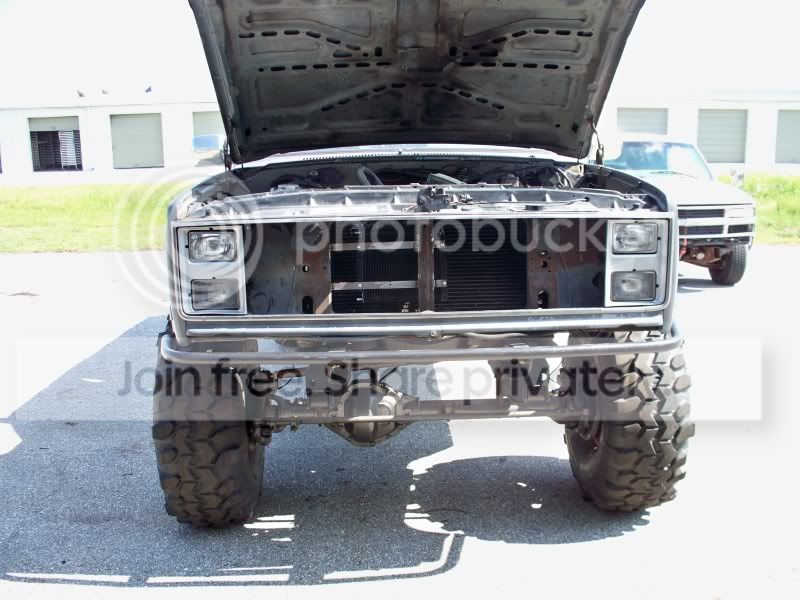

I don't think that .120 DOM costs much more than that; it's just harder to come by in most areas.
Like you said, though, it's just a bumper. Keep up the good work on your big bad 'burb!

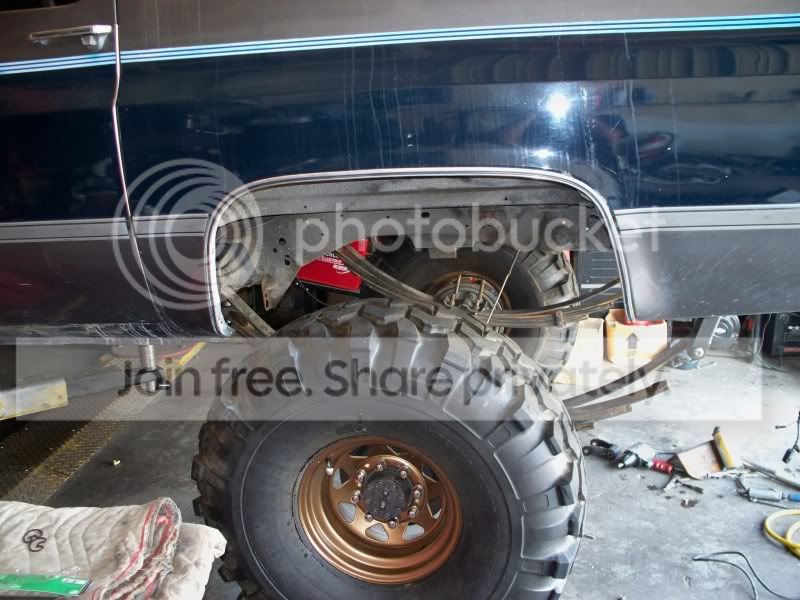

I drilled out my shackle hangers and put in the new bolts and lock nuts today.I also put the longer shackles in today and they are perfect and the rear is like 2" higher. The front needs to come down like 3" still though, I'll do that tomorrow.
Heres full droop, it's the only picture I have, my camera is being gay and I need to return it, the brake line almost isn't long enough
did you put in new leaf springs in because I remember them being flat with the weight of the truck on them or do they squish that much :eek1:
Is it just me or do the rear tires look alot closer to the front side of the quarter panel then they do the rear?
Yeah they are dodge 1/2 ton springs with 52" chevy springs added. The dodges are 60" eye to eye and they have a perfect shackle angle with a 6" shackle in the stock suburban location, they are too soft in stock for though
In full droop they will be, they are centered at ride height
I'll get some pics tomorrow after I lower the front
Edit: and driving around with the really soft springs and the spool rear is really weird, I think I may be able to lift a front tire lol
The crap to get it driving is the worst part :(
looks like brakeline is being your limiting strap.haha.you may want a longer one.coming along well though.

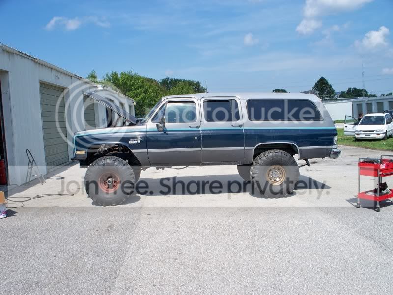

Heres the rear height after the longer shackles
I think I want to narrow the front and still do the tube back
Just about 8 inches like this
