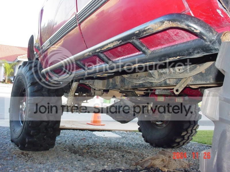

I want to my rockers like this
I don't think I'll be able to find the steel in the steel yards scrap pile so it's going to be kind of pricey
2 x 3 or 2 x 4?
think I got a 12'er of 2 x 4 for mine for under $50 iirc.....
Whichever one works best, probably 2x4. My local steel supplier rapes me, it was 8$ a foot for 1 5/8 .120 wall dom.
Hopefully it's not too bad, I'll have to check
Or I could make some tubular stuff with poo pipe :D
My rockers are nice so maybe tubular is the best bet.
Something like this
I prefer the 2 x 4 look myself..... I would definitely check on the price.... DOM tube is way more coin per foot than the rect from what I've seen usually... but hey, poo pipe'll work too, probably be less work than hacking out the rockers too...
I could get the thicker poo pipe stuff also
I can always hack the rockers out down the road, I would boat side it like willard then

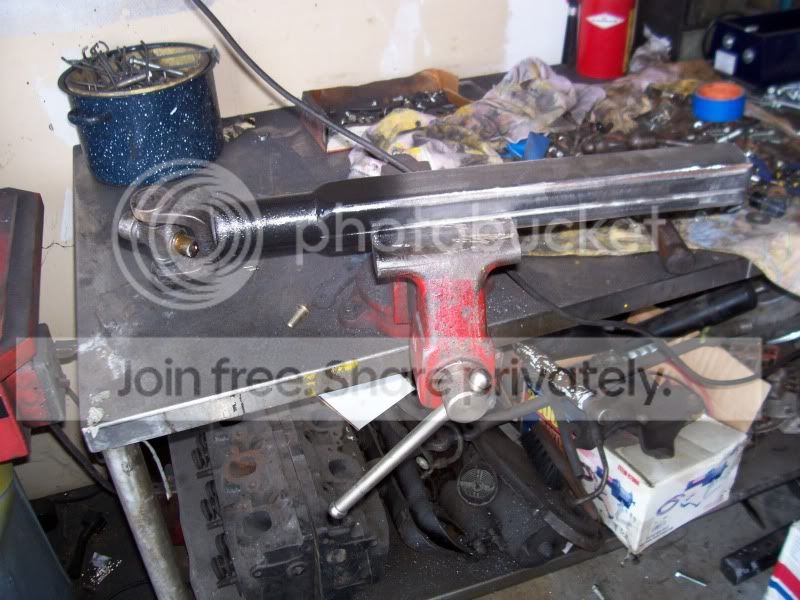

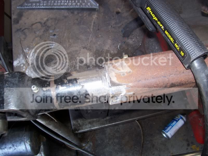

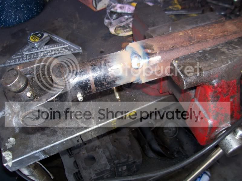

And heres the bottom to my square driveshaft
I just welded around the joint, didn't cut slots or holes for plug welds.
It had to pressed in so I wasn't too worried
