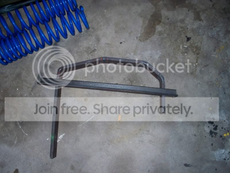

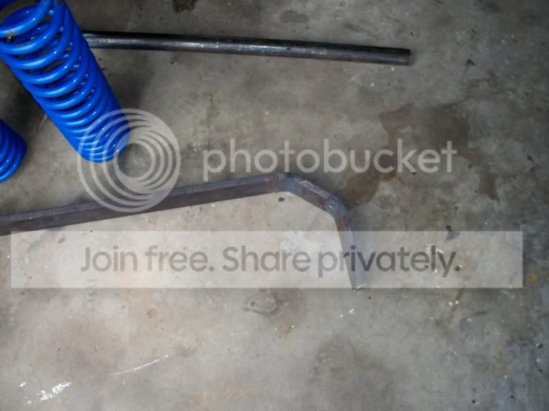

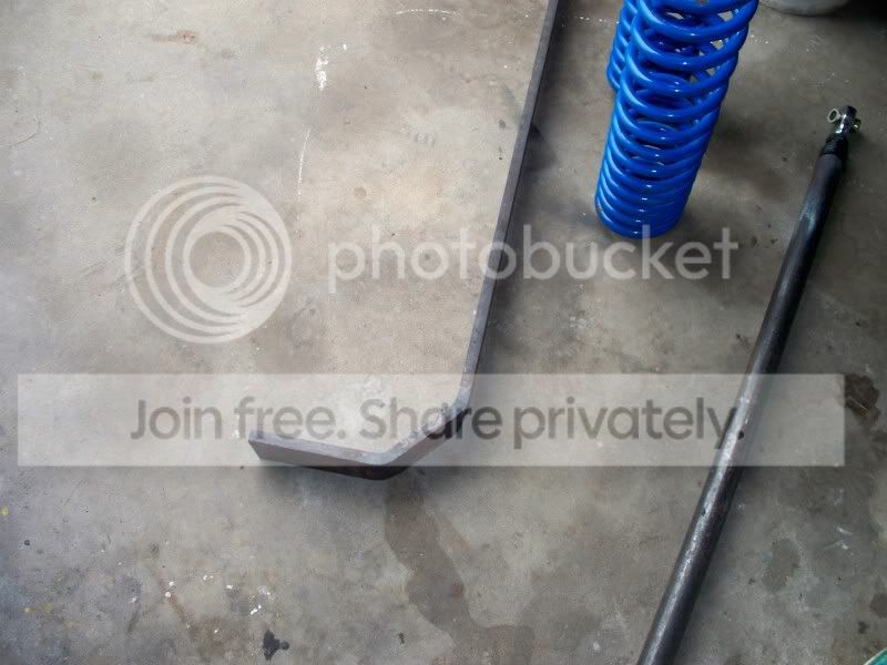

Bent some 5/8's steel today
I'll do the other this weekend probably
Cutting it will be interesting :eek1:
The idea is something like this but I want a little more room so I can weld both sides.

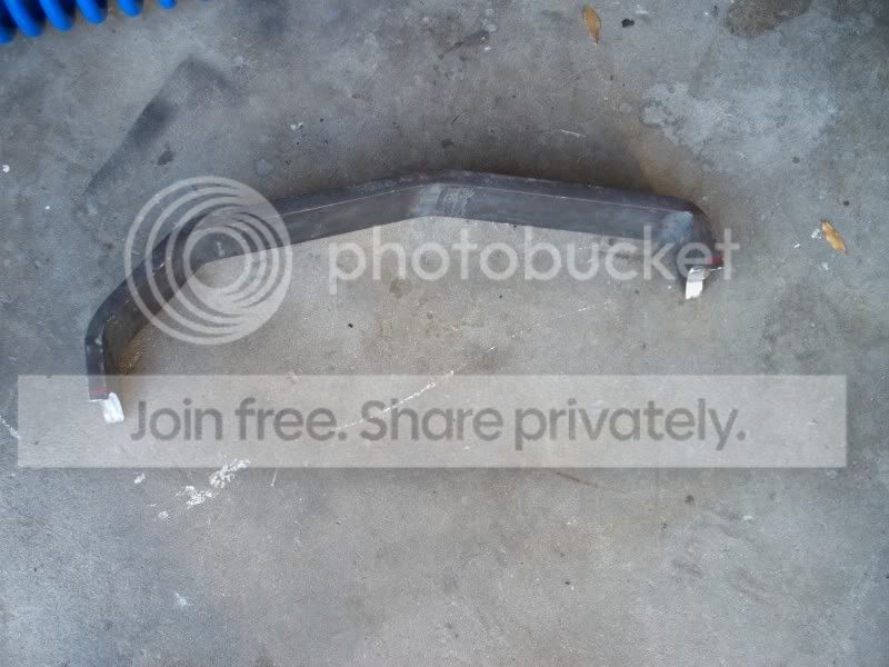

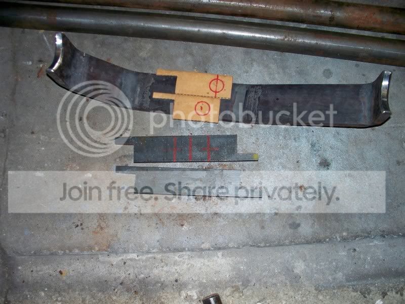

I think I'll make the part that connects to the pinion out of some 1/4 or 5/16.
This about does it
I'm gonna do the last two cuts with a sawzall.
Cut like butter, didn't even use a new blade, then ground to fit

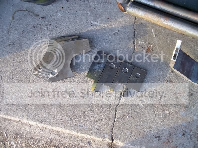

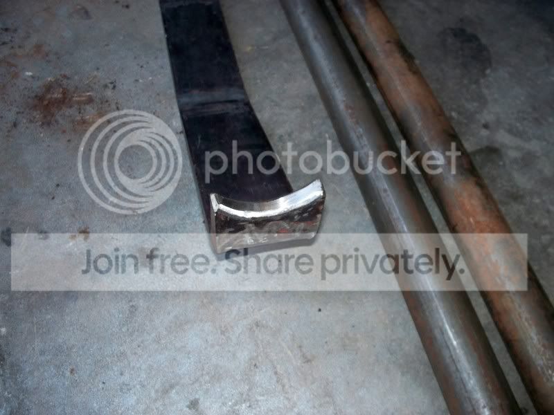

Tomorrow all my parts will arrive :D. I ordered some tabs from DIY4X today so by the time those arrive I should just about be needing them.
might be a good idea to give those a nice little bevel cut on both sides being it's so thick... maybe a double pass down each side too... tho I forget what machine you have...
I'm using a snap on muscle mig that plugs into 220, not sure of the exact model. It welded the 3/8" tabs on my front hydro assist pretty easily.

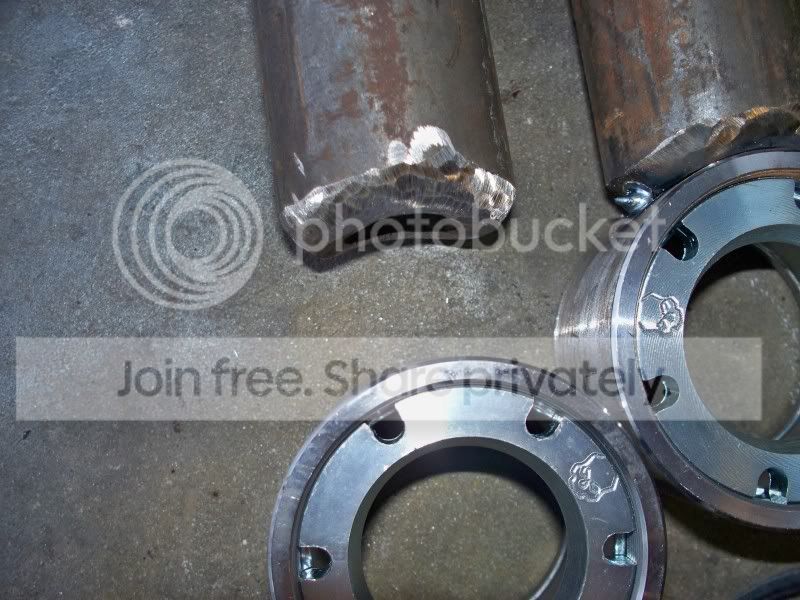

I was thinking about doing the bevel though just didn't do it yet. I also need to weld the axle tubes to the housing. That seems to be somewhat interesting. I'll just preheat it a bit and weld it, should be good enough

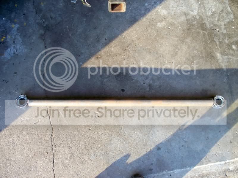

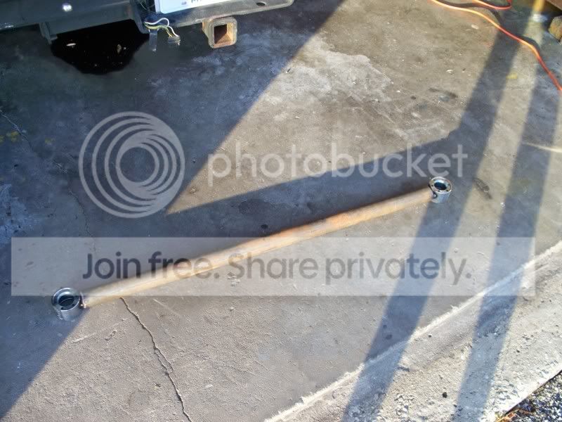

The link is pretty huge, 47" eye to eye
I did, for some reason it doesn't look like I did though in the pics. Probably from the chamfer I put on it.
Heres another pic
Still can't reall tell and it looks like I didn't

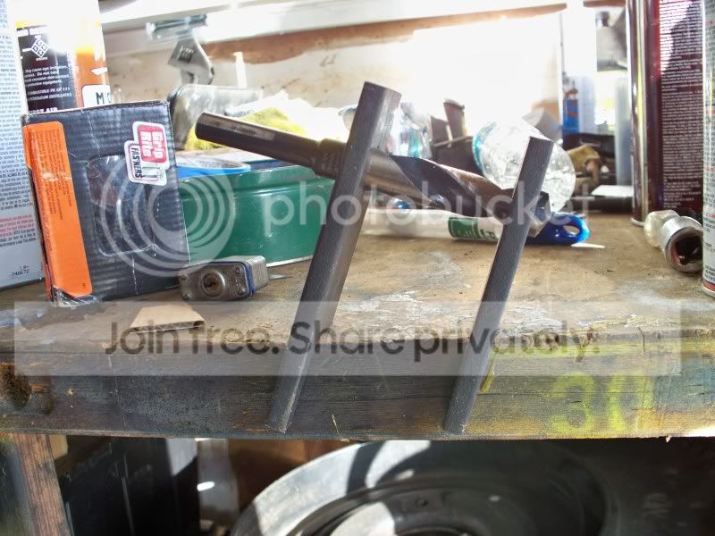

The 3/4 bit I got from fastenall worked pretty well in my 50 dollar drill press.

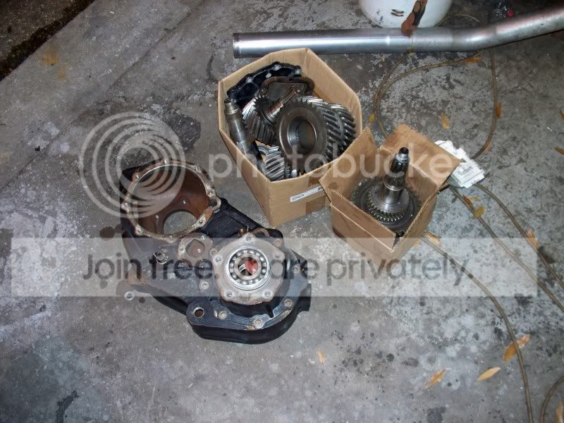

I got an np205 with a fixed rear yoke for free today also. I just need to get the th400 adapter.
Tomorrow all the crap in the rear comes out :D
Btw a word of advice from previous experience. Never try to drill a hole by hand over 1/2in without taking 1/8 or better yet 1/16th in steps at a time. I've broken, twisted, and destroyed, 10 odd 5/8ths and 3/4 drill bits like that...
