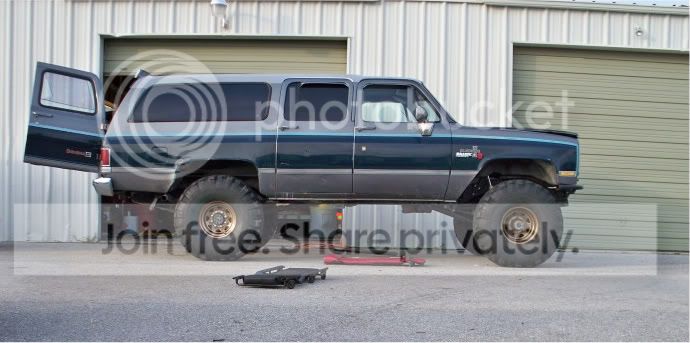

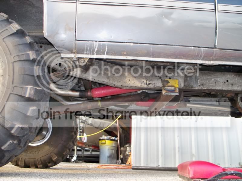

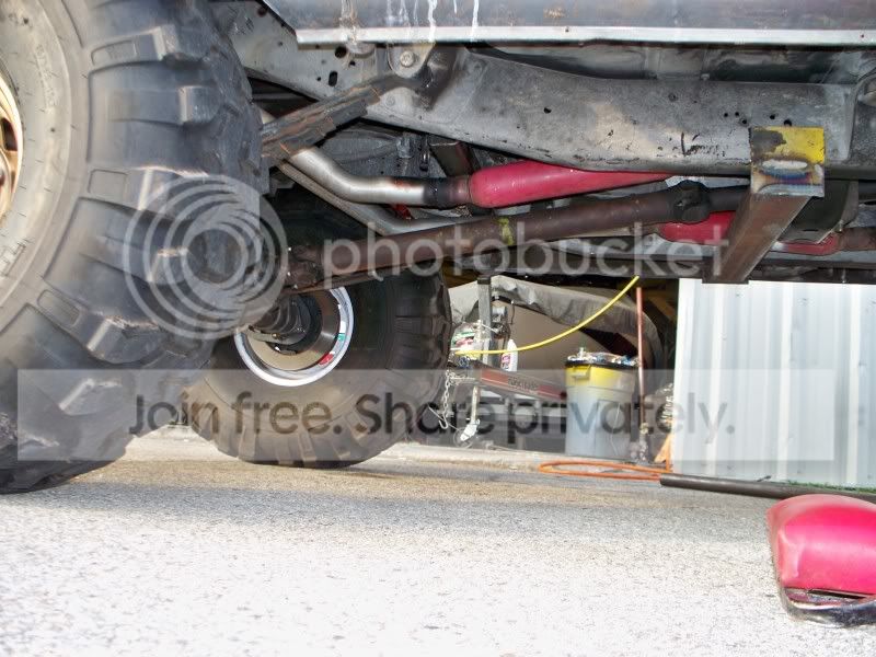

Howdiy's halfassed 4 link
I don't know if only 340 bucks would do that, maybe a few more zero's :haha:
It should be pretty nice with the 52's out front with the rear 4 link though :D
I also had to revise my numbers, I never read the part were the distance apart is half the total length. The numbers still check out nicely though

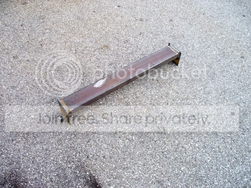

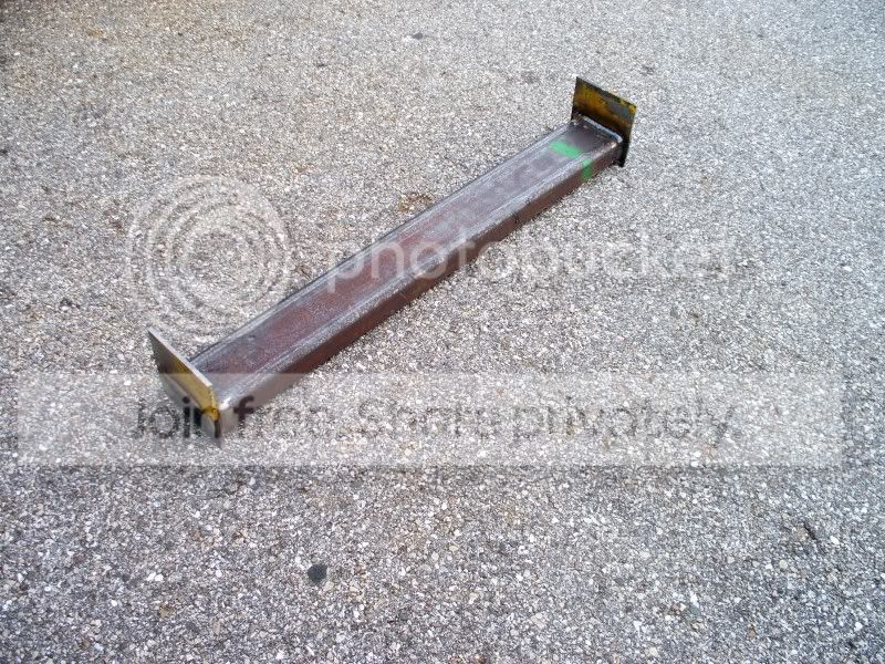

Roughly made the crossmembers today
All 1/4"
And it looks like ballistic is having an additional 10% of sale today.
You can see the upper crossmember it's right under the leaf spring hangers
My uppers will be short but I think I make the numbers work. They will be around 60-65% the length of my uppers

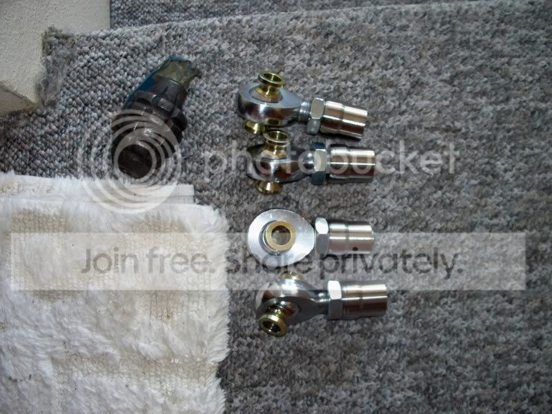

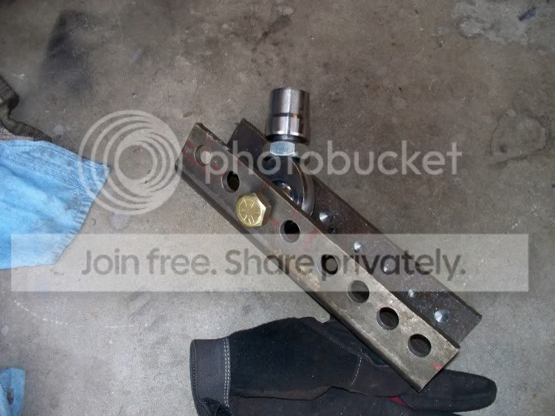

I finally ordered my ballistic parts today, I was going to try and get 3/4" holes in some tabs and leave the others standard sized but it was a PITA so I didn't get any tabs. I'll have to make all of my own, but it shouldn't be too hard, besides the 3/4" holes, I'll just drill them at the machine shop.
I got 15% off so that saved a ton also. I have more money left over now.
I have these
thumbnail.asp
And 4 of these on the way
thumbnail.asp
i was thinkin about this thread the other day. glad to see some progress

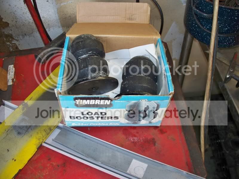

My rubber springs to use as bump stops and my adjustable upper link mount. I still need to cut it in half and drill the rest of the holes .

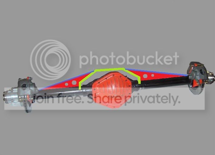

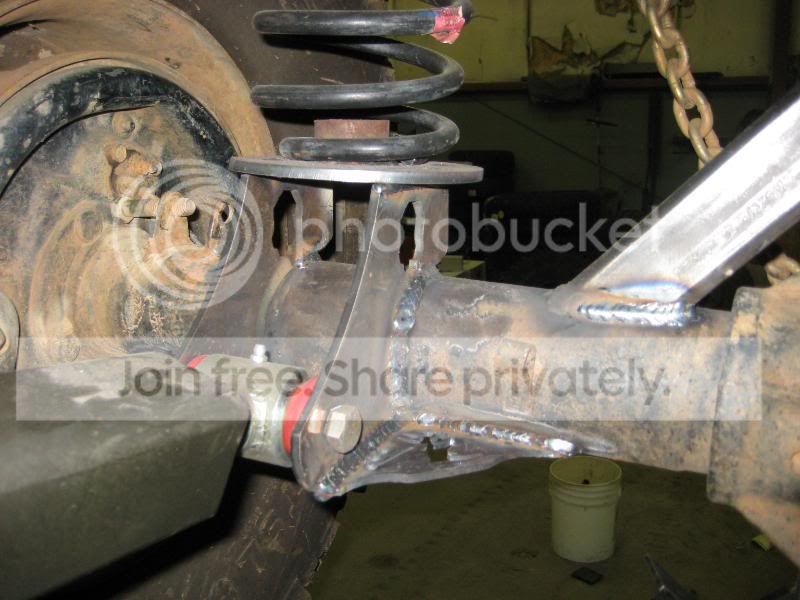

I also have an idea for a rear axle truss that should look awesome.
My truss Idea
The green piece is 5/8"x3" plate, the blue will be 3/8"x2.5", and the red will be thinner sheet metal that I can dimple die. Maybe 1/8", I'll see what I can find.
But I realized I have to put my coil/link mount brackets on also. So this Idea could be an epic fail.

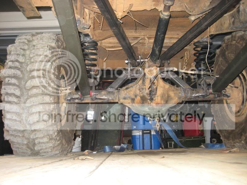

It's pretty much this, I just found this pic searching at pirate.
And I'm posting this pic here so I don't have to keep searching for it
