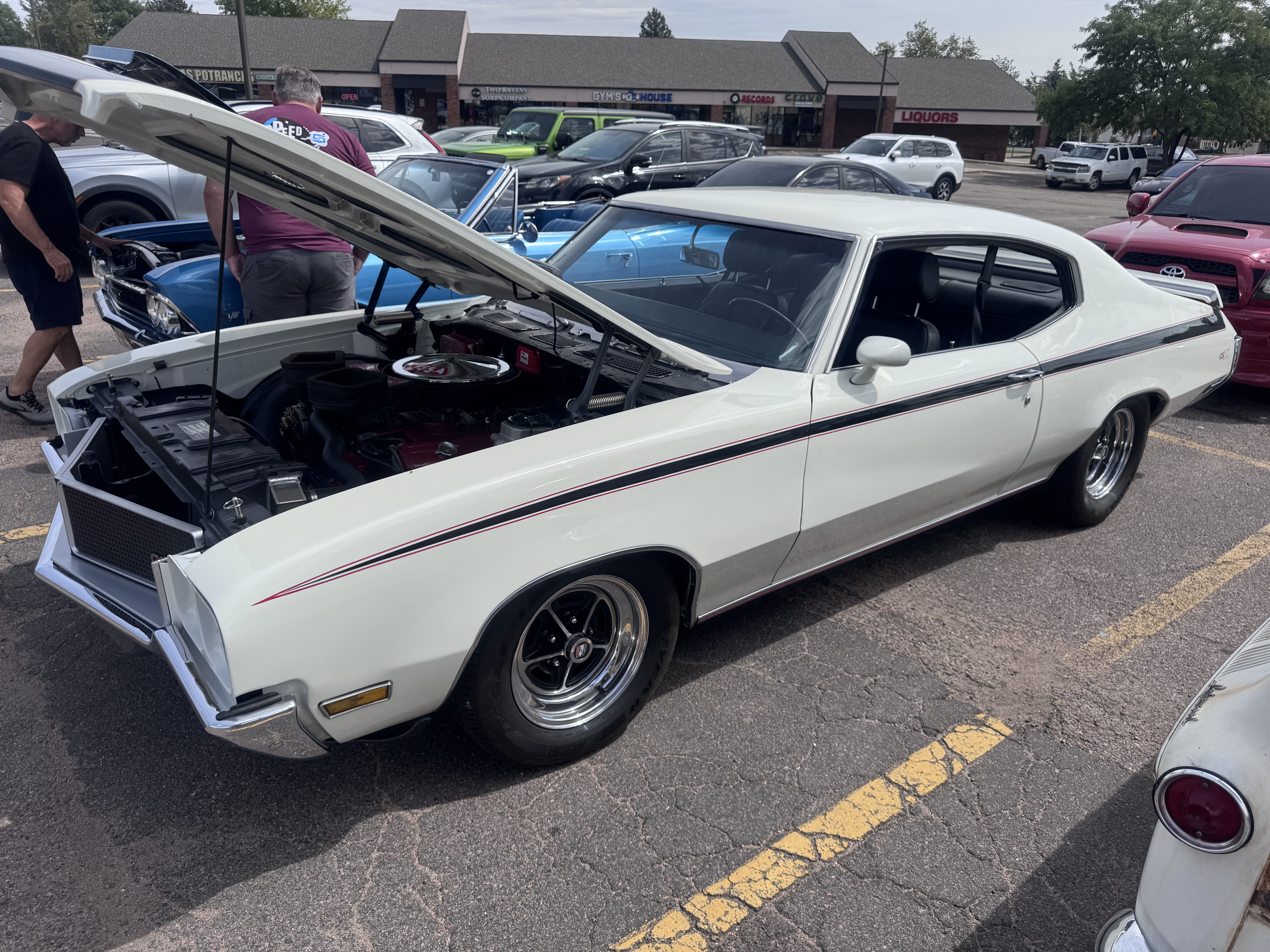

The original owner worked at a chrome shop in the early 70's. By 1975, a lot of the car was chromed. My plan is to get the car back in the road as he had it in 1975. Leave the chrome, run the original intake, a q-jet with the ram-air air cleaner, and the headers. ( as the exhaust system is set up for the headers and is entirely chromed!)20260921_105730.jpg20260909_081927.jpg
