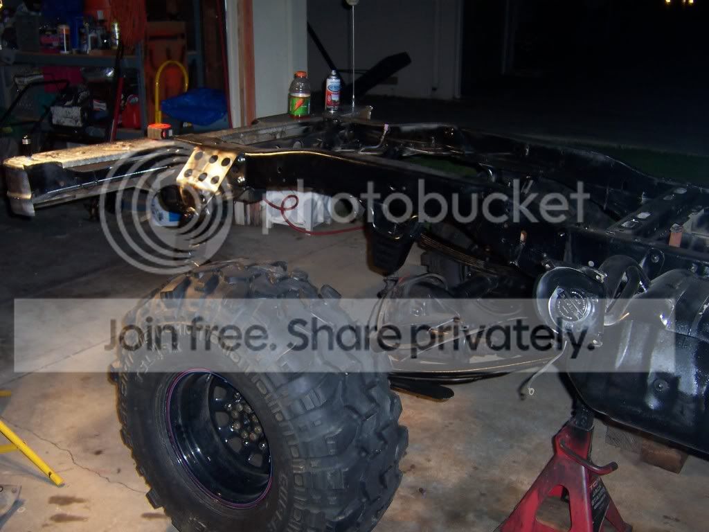

K10 Back-half Revamp! **posted wheelin' pics**

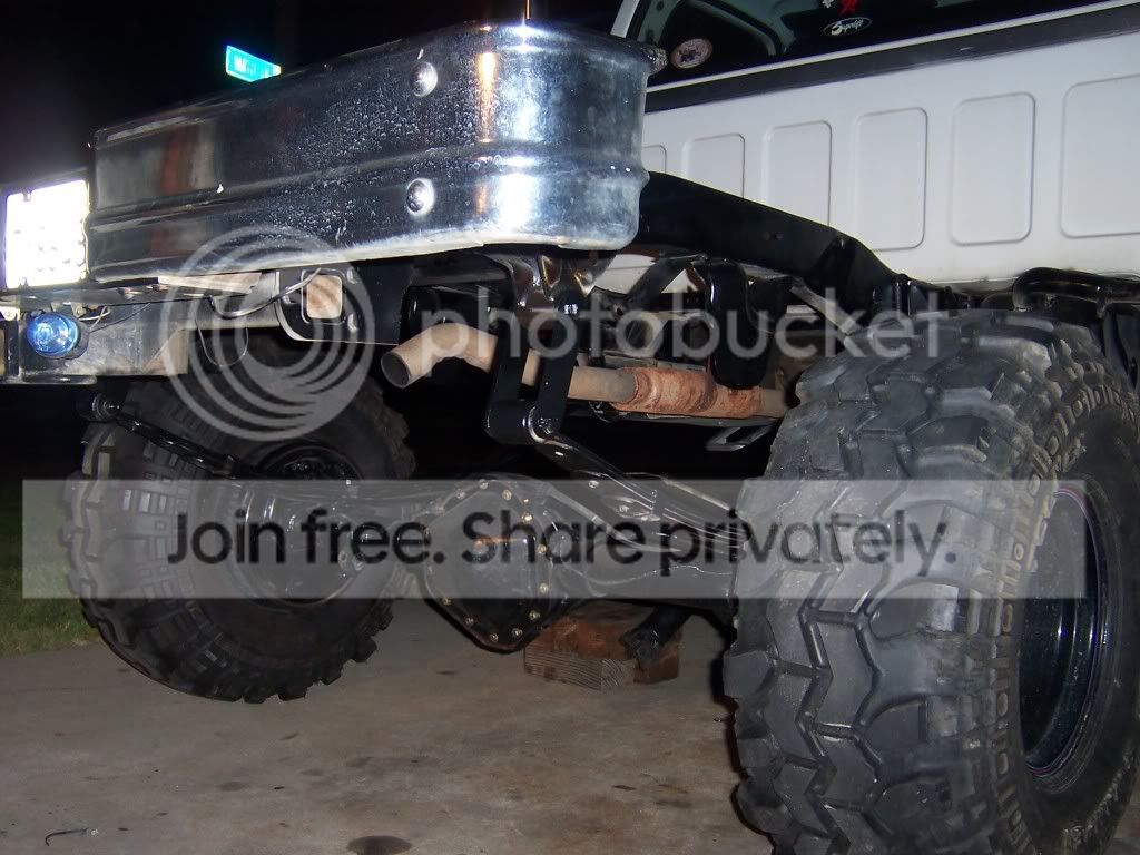

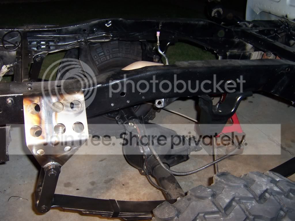

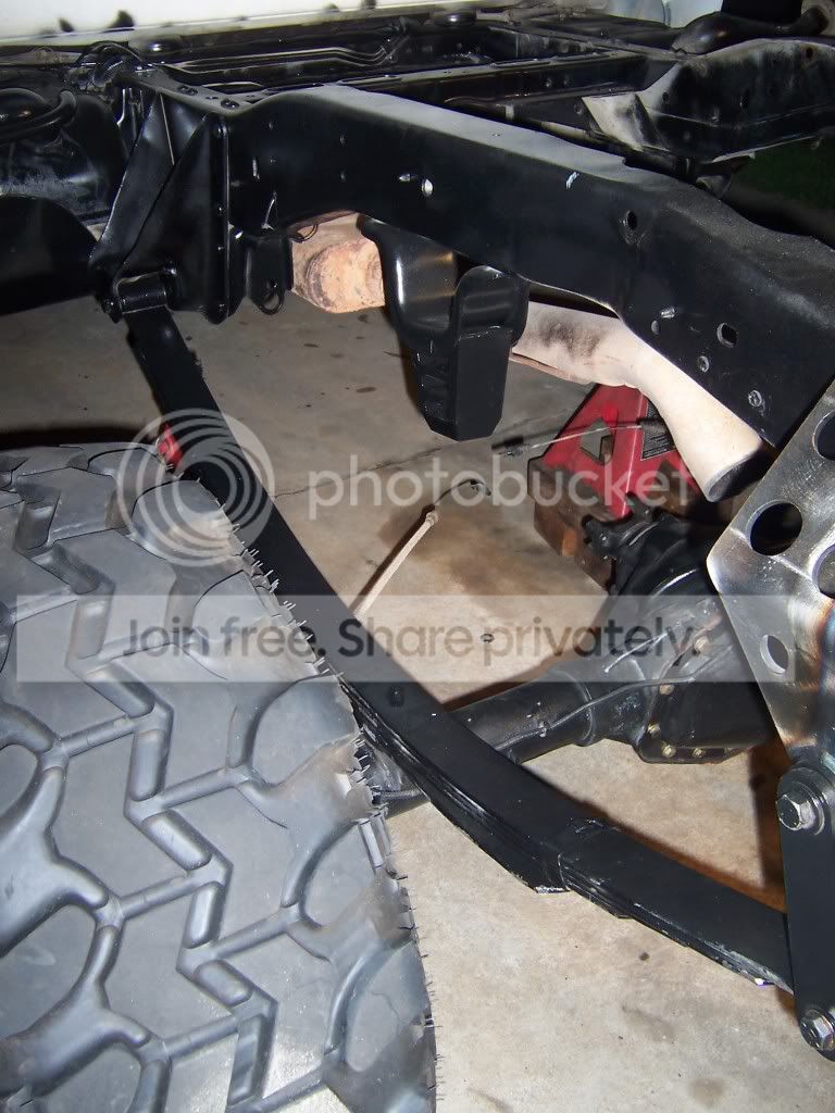

Ok I had some time tonight to mess around with it and it looks like I lucked out...
I flipped the springs (pushing my wheelbase out a couple inches) and by doing so it made my yoke land perfect without any shims so I'm pretty happy about that.
I set everything down on the rear end and man oh man is it soft...

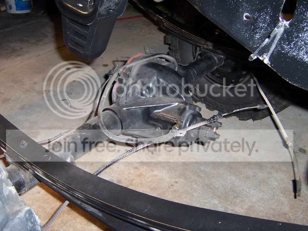

I picked up my new rear brake line tonight after I got off work so it looks like the only stuff I need to get is u-bolts and have my d-shaft lengthened and I should be able to button it all up enough to move it. Then I'll make some shock hoops and measure for my limiting straps...

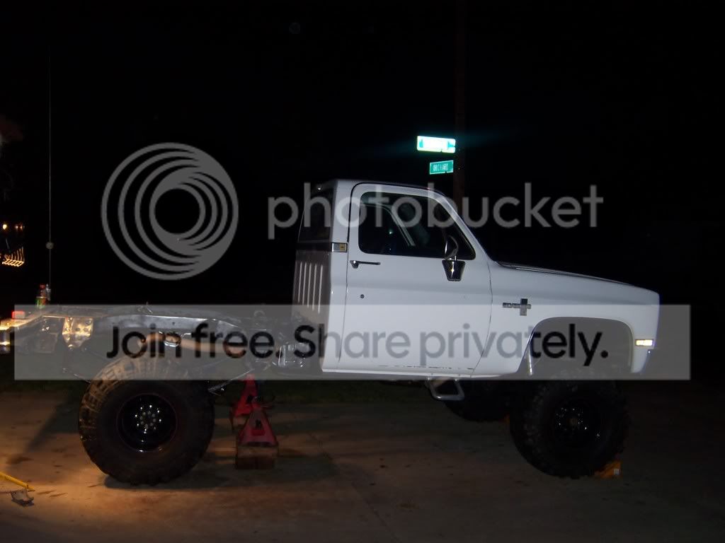

A couple pics I snapped of where it sits at ride height...

Looks Good.Should settle out about level with some weight,ya think?Too soft?Anti wrap bar or something like that in your future or just run it and see?You could always add another spare if the ass end sits high.I always loved the look of a prerunner with 2 spares standing up in the bed.That ready for anything look.
I'm going to put a fuel cell and a toolbox along with my fullsize spare and hi-lift all out back so it should have a good bit of weight on it by the time I'm done.
We were talking about an anti-wrap bar last night at school and I think if I need one I'll just order the kit from Kert... some stuff is just worth buying and for the price it's hard to pass up.
Your cali rake is the wrong way. :D
Looking good Avery.
I know! We were thinking it was going to sit lower in the rear for the time being but it looks like it's higher out back. I think once it settles a little and we get the rest of the weight on the rear it should sit close to level.

We were talking about my rake (which isn't as bad as the pics make it look... plus the driveway has a pretty good incline to it) and I think once I get my fullsize spare, hi-lift, fuel cell and tool box full of tools it'll level out.
I took my d-shaft to a shop this evening before my night class and asked about lengthening it a couple inches and they wanted $150 so I didn't do it... I'm going to take it to work tomorrow and cut one end off, put a sleeve on and weld it back together to get me a couple inches so I can at least get it back in and hit the RTI ramp so I can measure for shock mounts, bump stops and limiting straps.
A local industrial supply shop is making my new u-bolts and they should be done tomorrow so it looks like I'll be able to get it buttoned up by the weekend.
